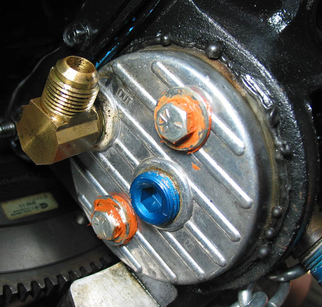

You mean this problem. My leak was huge. In my case it seems to be mainly the bolt as you can see. I used Archie gasket material with lots of RTV and don't have a problem around the adapter. Have my engine back so I need to see what I will do there.
Exactly, I wont know for sure but it looks like the same issue. I will try to pull the starter this week and see if I can get some sealer in the bolt holes.
Thanks for posting the picture.

My solution.
Posts: 33127
Total ratings: 400
Report this Post11-03-2006 05:46 PM Click Here to See the Profile for Jake_DragonSend a Private Message to Jake_DragonDirect Link to This Post
My solution.
That pretty much looks like mine but I use black gasket maker

I used the heavy duty Cooper version because my exhaust is close and because I had it handy. Just in case
