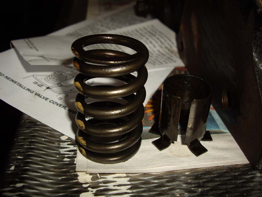

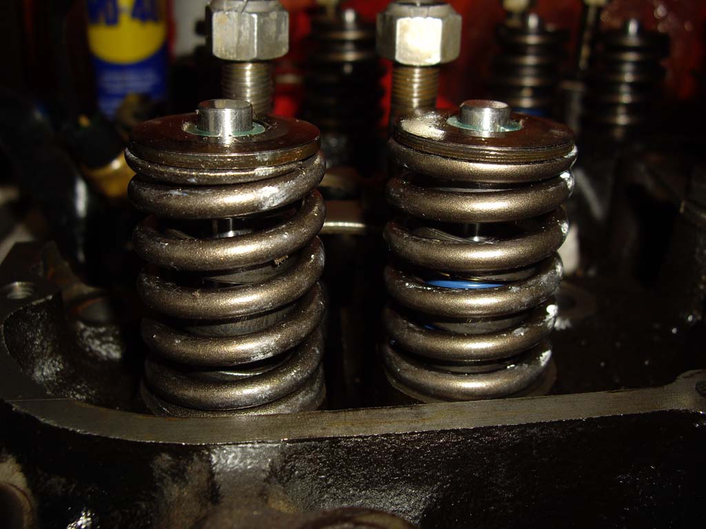

I recently assembled the new valves. also put some new springs from Fierostore to be able to manage the higher lift from the 1.6 roller rockers. (The performance model)
The new springs seem to have a smaller flat spring inside wound in the opposite direction of the mainspring. The old one has some kind of expanding centerpiece. I dont think that it is possible to reuse the centerpiece due to the fact that the flat springs take up all the space there, so I left it out. I hope that it was the right assumption ?
I have two photos here:
The old spring and centerpiece:
The new performance springs installed:

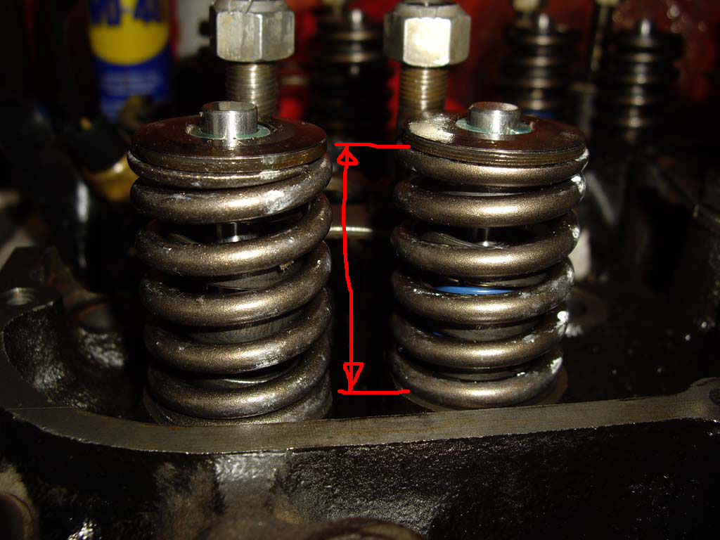

yes, the old centerpeice does not get used. the old centerpeice and the new reverse coiled spring do the same job: keeps the spring from curving sodeways when compressed.
something to make sure of: spring install height. you need to measure from the base of the spring to the bottom of the retainer. make sure you have 1.70" or whatever that is in metric. if you have less than that - there is a chance the spring will bind when compressed. and - if it binds - it will wreck soemthing - most likely your camshaft.
08:28 AM

installed spring height - it is basicly the hieght of the spring as it is installed. that pic above - measure the spring, only the spring, from top to bottom, as it sits installed.
usually - it is fine. the height is a minimum. and, for most performance springs I have seen for the Fiero - it is 1.70" unfortunatly, it is not easy to measure. there are all kinds of things in the way. dieally, you want to do this BEFORE you install the springs. get a block at the specified hieght, and stick it where the springs would go, and see if it fits.

So it's actually not depending on the spring itself it's rather the base of the spring seat and the length of the valve from the seat to the keeper slot that determines the spring height ! Am I right here ?
It must be rather easy to measure with a vernier caliper. Just a question of using the deep measurement tool.
Metric: 4,318 cm

exactly right. the hieght of the base pad to the bottom of the retainer pad. easiest to measure WITHOUT the spring in place. yes - most springs is 1.70" or 4.318 cm - but should be on the packaging or instructions somewhere. and, again - its a minimum - if more, not bad. if less - VERY bad.

yup - you are measuring the right area. the 1.7" is a average guess. some manufacturers are more, some less - but MOST I have seen - are 1.7"
I think the springs sold at the Fiero Store are Crane spings, and the install hieght is 1.71" and, again - the hieght is a minimum. if it is less - the spring seat must be machined/lowered. it is a quick & easy job. for me to get both heads done was under $40. and - it will save your cam.
there are also "offset keepers" - them little 1/2's which hold the retainer in place, which can adjust the height also. not sure where you get them tho.

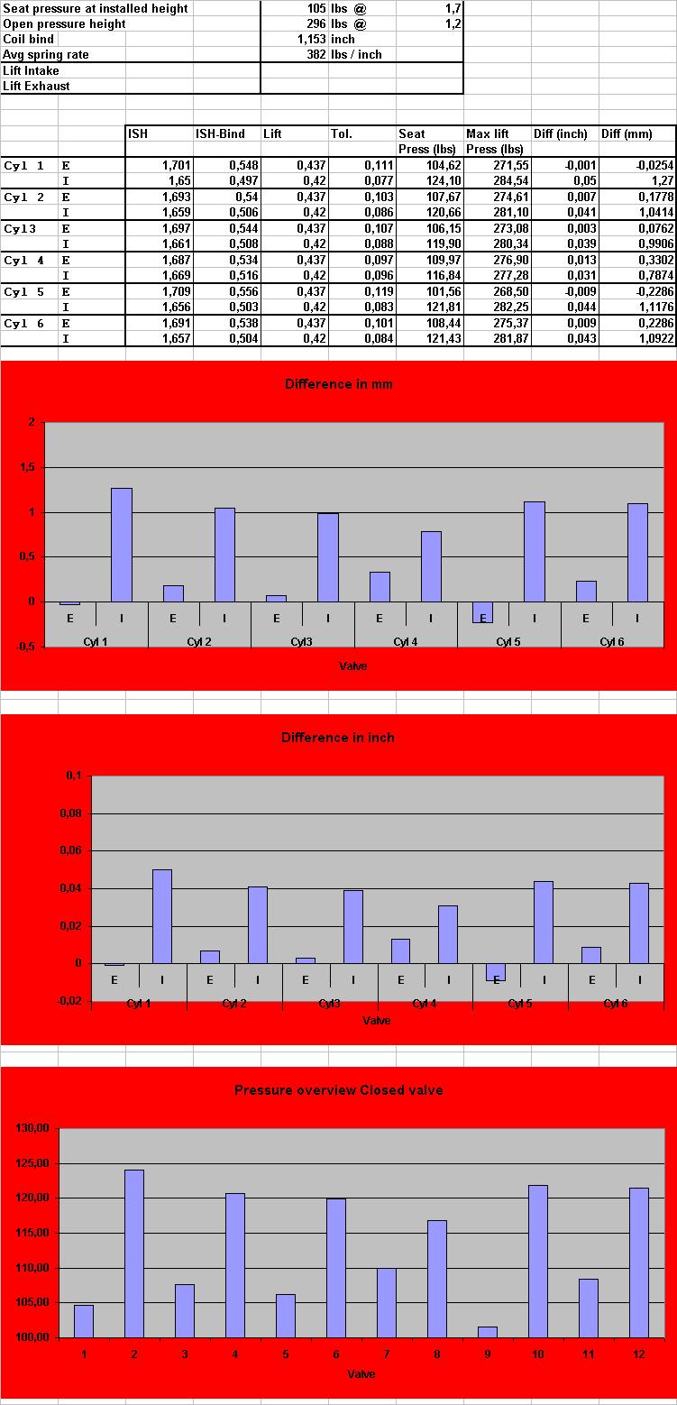

Now this is very important and may ruin my plans of installing everything this weekend. :-(
You said in another post : -------------- ok, the "usual" instal height of Fiero valve springs is 1.700 these springs bind at 1.153 that means at most 0.547 lift. with ZERO tolerance. --------------
I wont get 0.547 Lift with stock cam and 1.6 rockers right ? So there must be some tolerance here ?
The minimum height seem to be 1.650 on one of the intakes, how much tolerance does that leave me ?

I dont know the stock cams profile, so I cant answer that. your thinking is mostly correct. since you dont achive that lift, you wont hit the bind point. but, the other issue with the install hieght is the increased spring load. the more it is compressed, the more tension it puts on the valvetrain.
yes - you will probably be OK. some quick math: sping hieght 1.650 bind point 1.153 max lift = 0.497
0.420 (guess) lift on stock cam / 1.5 (stock ratio) * 1.6 (new ratio) = 0.448 new lift
0.049 room for error. but, there is also the increased spring pressure. and, were these numbers for the same springs? I think they are, not sure tho.

When I try to interpret which setup is stock Fiero it seems to be the one with note 18, GM L44
It seems that the lift is different on the intake and exhaust, the intake is 0.420 and the exhaust is 0.437 with 1.6 ratio rockers. With stock rockers it seems that the lif tis a mere: Intake 0.394 and Exhaust 0.410
So the Exhaust must cope with a lift of 0.437
The worst exhaust ISH is 1.687.
If binding occurs at 1.153 then this leaves me with a possible lift of 0,534 here.

""FLAT-TAPPET" Open pressures should not exceed 330# open pressure (sustained after spring break-in) for accepable cam and lifter life. a. Open pressures should be a minimum of 220# for applications up to 4000 RPM. b. For good performance above 4000, open pressures should be at least 260# with stock weight valves. (Lightweight valves require less spring open pressure.) c. Spring open pressures over 280# can cause "pressed-in" studs to come loose; therefore,we recommend screw-in studs for open pressures above 280#."
All statements are ok. minimum 220 not exceeding 330 some of the valves have over 280, but the fiero does not have pressed in studs.
Also I read that the tolerance to binding should be over 0.060" and the worst I have is 0.077" so all numbers are leanig towards a GO.
The Crane catalogue also says:
1) "FLAT-TAPPET" cam/lifter applications (Street & Street/Strip) seat pressures a. Small Block 105-125# Seat Pressure b. Big Block 115-130# Seat Pressure (Note: Big Block applications need higher seat pressures due to their larger, heavier valves.)
I have a seat pressure span from 101 to 124#
Which statement is ok for the Fiero ? We have bigger valves than normal V6 engines due to the HO option ? I will also reconsider changing all keepers to old ones, that should put me even closer to the safe side.

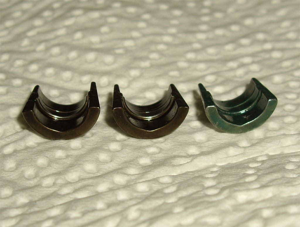

Anyone that knows where to find offset keepers ? This seems to be the easiest and cheapest way really .
I have an own 3-in one mill lathe drill, I am thinking of milling away one mm of the spring seats that are worst.
Uhlanstan, when you say sand a bit on the retainer, do you mean the two C shaped keepers, or the conical hole in the plate that keeps the spring down ? (Increase the conical volume ?
03:34 PM
Pyrthian Member
Posts: 29569 From: Detroit, MI Registered: Jul 2002
Originally posted by kjelle69: Anyone that knows where to find offset keepers ? This seems to be the easiest and cheapest way really .
all three are good answers - they will all accomplish getting a little more height. no, I dont know where to get the offset keepers - yes - sounds like the easiest answer. milling is the usual fix - and works well. the valve seats are flat with the head surface. while sanding/shaving the retainer may work - I worry about strength. you did the math, and know the load each retainer is put thru, and multiply that by RPM's & expected engine live - thats a long time of holding back much force. but - also, at the angle them keepers are at - it dont take much to get that 1mm you are looking for.

This is a measure you use when all else fails you can grind a small amount from the retainers also known as caps or spring lids,, these are the top pieces that resemble a volcano.. you can only grind the flat surface ,, the retainer(cap) is the piece that presses the keepers(locks) to the valve stem and presses against the upper valve spring..do not do this unless you must.. I would measure the springs .. you have the measurement,on your excel paper of the compressed spring now remeasure the springs so you can put a short spring where needed.,,or a longer valve where it is needed when you change a lot of stock parts ,for performance parts you often find more work than planned.. the valve seat face grind mark should be centered on the engine head valve seat, or very close,on a race engine you make a lap and check the fine bic point mark and move valves to attain proper seat but this is not necessary on a street engine...keep used valves in same hole
never alter the locks (keepers) on a street engine,, you can check spring retainers and if there is a lot of metal below where the keeper locks are in the "fasten" state you can grind this off ,,coat bare metal with oil.. (I blue them) you want your retainers to be all the same weight
used valves will be different length,but should be kept in original hole UNLESS you can avoid binding by change the cam makers will have the keeper locks,in different models... up/ down
the .060 was a lucky guess,,I did not know
locating the rocker is done by moving mounting points,combining different lenth push rods & vavle stems,, or changing rockers
the rocker will start out close to center and at mid lift should be mid stem and pull close to the inner stem at full open consult the data they sent to you.. The lift should be equal on each valve intake same exhaust same get your close this is a lot of work to do properly
the more equal the more uniform the more precise the better running engine the more reliable
you are not building a race engine,, only in spring clearance you must have more than enough

5. Mechanical Interference A. Spring coil bind. This is when all of the coils of the spring contact each other before the valve fully lifts. Valve springs should be capable of traveling at least .060" more than the valve lift of the cam from its assembled height. B. Retainer to seal/valve guide boss interference. At least .060" clearance is required between the bottom of the retainer and the seal or the top of the valve guide when the valve is at full lift. C. Valve to piston interference. This occurs when a change in cam specs (lift, duration, or centerline) is enough to cause the valve and piston to contact. Also, increased valve size or surfacing the block and/or cylinder head may cause this problem. Minimum recommended clearances are .080" intake and .100" exhaust. D. Rocker arm slot to stud interference. As you increase valve lift, the rocker arm swings farther on its axis. Therefore, the slot in the bottom of the rocker arm may run out of travel and the end of the slot will contact the stud and stop movement. The slot in the rocker arm must be able to travel at least .060" more than the full lift of the valve. ......
going by this and your table above - looks like you are all set to continue assembly
