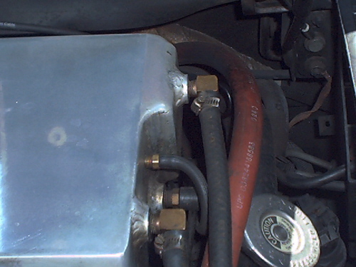

I used a cut-down MR2 intercooler on top with the fan under it as in the photo below. When the fan went, I put bigger fan on top of the intercooler. Not the best looking setup but it works fine and don't mind the function over form race car look.

My setup with the intercooler over the vent and fan either over (as it is now) or under works fine. It not only pulls outside cold air over the intercoller but also redirects that air to blow on the turbo too. That setup along with an extractor scoop and thermostat controled fan makes for a very cool engine compartment even with the turbo and headers. In addition it keeps the turbo close to the TB and headers, whereas long tubes are not a good idea. I'm only running 10 lbs of boost, but have 9.5-1 pistons.
BTW: Glad to see that you do want to use an intercooler, I just don't understand why so many people think they don't need one with a turbo? Even the auto makers use them and we all know the bean counters would say no if they were not a real good idea.

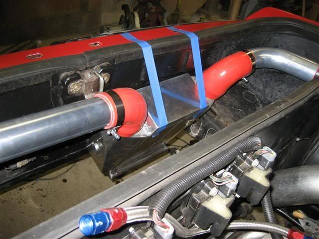

I say go with both the A/W intercooler AND the water/meth injection setup.
If both are good by themselves, then they must be GREAT together..
Here is a pic of my A/W from when it was in the "mock up" stage..
