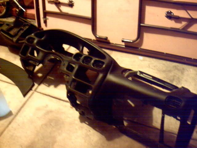

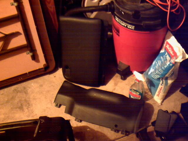

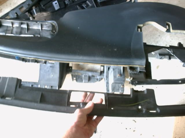

OK, so here are my starting materials, This is also my first attempt at embedding images. Lets hope this works...
Donor Dash / Soon-to-be Mounting bracket... (courtesy of Mel)
Grand Prix Dash...
Center Console I may or may not use...
Glove Box and Steering Wheel Kick Panel...
Damage to Dash From airbag deploy (need to repair)...
Hopefully I can get started on this soon. I have to work overtime this week, so progress will be fit in sparingly

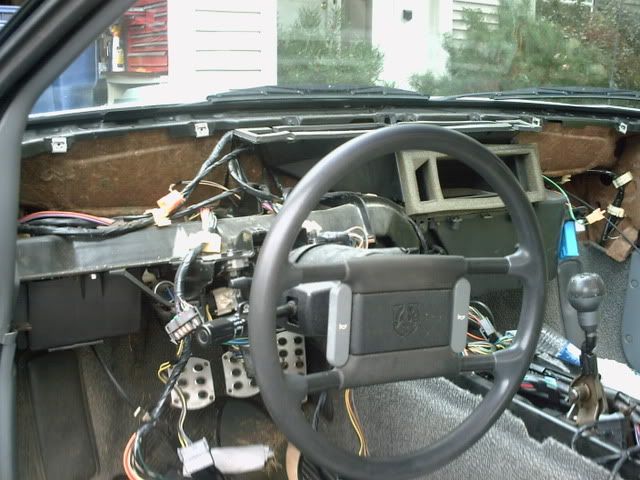

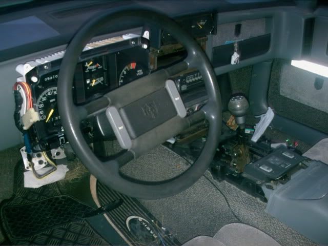

Report this Post09-27-2008 08:01 PM Click Here to See the Profile for FreemanSend a Private Message to FreemanDirect Link to This Post
Ok, so not much progress, started to take the dash apart, making sure to keep the car drivable...
Hopefully I'll get a lot done in the next couple days.

Report this Post10-03-2008 08:10 PM Click Here to See the Profile for FreemanSend a Private Message to FreemanDirect Link to This Post
So I've still been slow with progress, took out the armrest and rest of the center console today. Debating the need to hook the hvac and stereo back up, but the car is still drivable.
I'll be playing with photoshop later on tonight, I have some ideas I've been kicking around in my head. Hopefully in the next couple days I'll be able to do more work and less standing around and scratching my head

Report this Post10-08-2008 06:22 PM Click Here to See the Profile for FreemanSend a Private Message to FreemanDirect Link to This Post

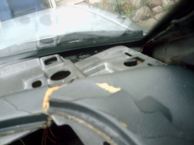

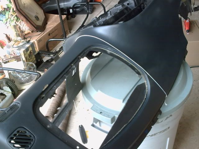

Ok, so here are the events that led up to my cutting in half of the Grand Prix Dash...

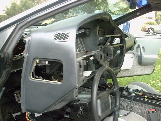

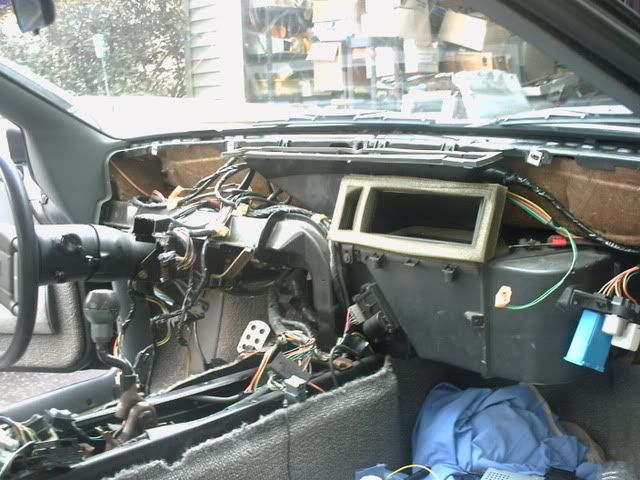

First, I finished pulling out the stock dash that I had in the car...

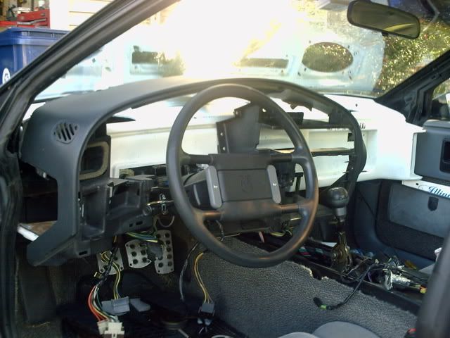

I then set the Grand Prix dash about where it should be, only to find that it stuck out too far...
I thought I could fix the problem by cutting a decent sized strip off the back...
After putting the dash back in, I found that it was going to be too wide, so this is where it strted to get interesting.
Freeman
Posts: 52
From: Algonquin, IL, USA
Registered: May 2006
Report this Post10-08-2008 06:35 PM Click Here to See the Profile for FreemanSend a Private Message to FreemanDirect Link to This Post

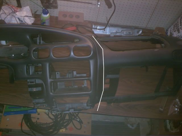

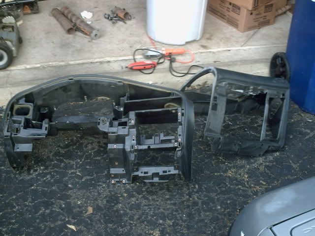

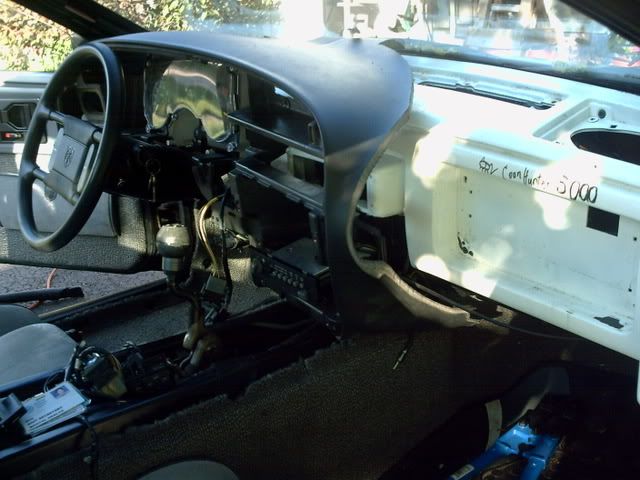

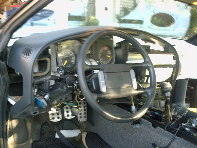

So here is what I've done now...
Drew a line where I was going to cut...
Then cut the thing in half

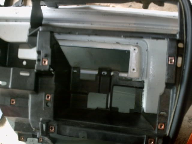

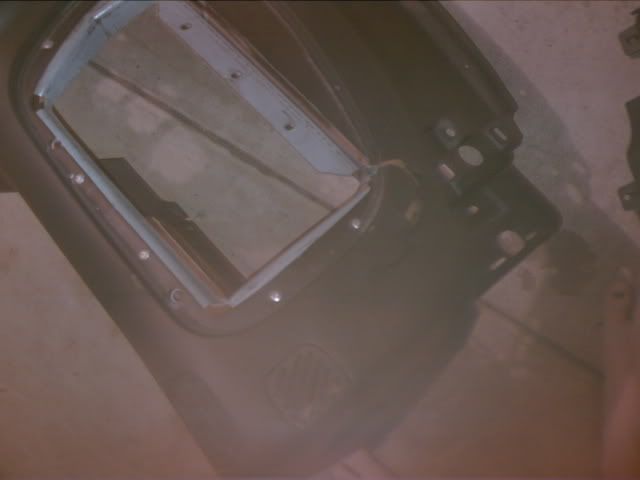

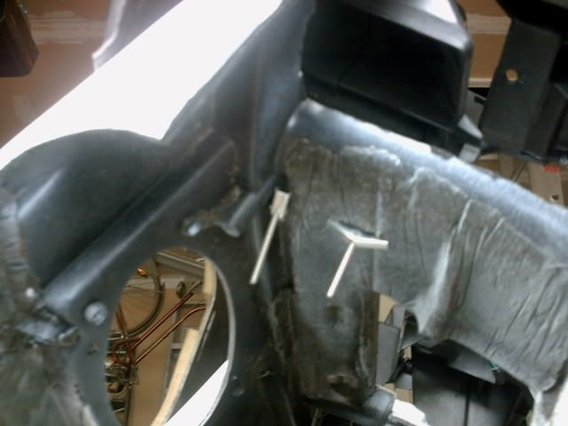

I then began the process of mounting the half Grand Prix dash to the donor fiero dash
This part with some basic nuts and bolts...
And this part with some toggle bolts...
I ended up using some pieces that I cut off the donor fiero dash to fill the gaps where I was putting the toggle bolts. The plastic with foam attached worked great for filling the angled gaps, this can be seen in the above pics.

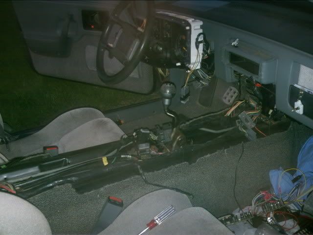

I then mounted the Fiero dash using all the existing stock mounting points
I then mounted the guage cluster, reconnected the wiring, put the shifter back in, reconnected the HVAC controls, and the car is drivable again.
I still need to modify all the ductwork, and make mounting points for the switches, radio, HVAC, and aux guages. For now though, the defroster works and the car drives, so I'll still be able to make it to work tomorrow.

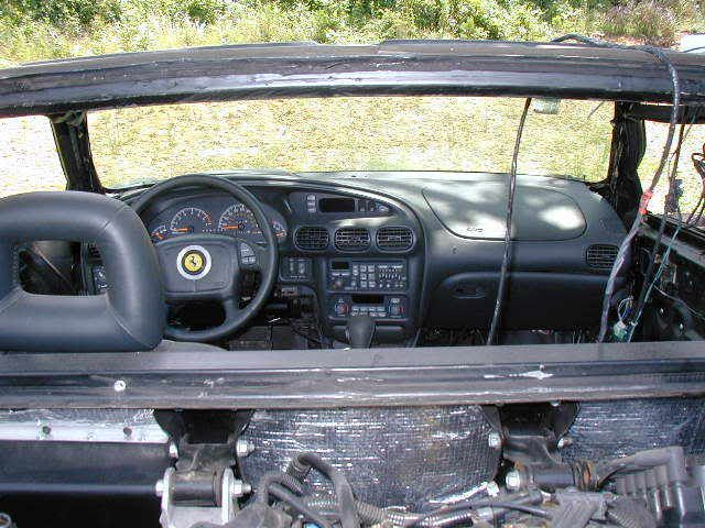

Here is a photo of a Grand Prix dash in a Fiero that might help you.
Report this Post10-08-2008 11:58 PM Click Here to See the Profile for FreemanSend a Private Message to FreemanDirect Link to This Post
I appreciate the feedback. The 'CoonHunter5000" was written on the donor dash when I got it. This is only an early step in the interior build which should hopefully spread through the rest of the car. Sorry, but I'm already on working on the center console. I intend on piecing the other half of the Grand Prix dash in the passenger side, if not just using it to make a mold and make a custom passenger area that fits my liking (already looking at lcd's online). The entire Fiero dash will be hidden, so the CoonHunter5000 will eventually be buried. The custom ductwork it going to be tricky, but I already have been playing with my secret weapon to tackle that challenge. I'm more concerned about working on mounting the stereo and switches than the duct work, believe it or not. That however may be a gross underestimate on my part though.
And gunslinger, I appreciate your concern. The idea of trying to combine 80's and 90's style never crossed my mind. I agree with you that that would look horrible.
Following Sourmug's Decklid Vent Build has given me the confidence to try my hand at using fiberglass, so after I finish up with the drivers side that is currently up, it maky end up being made from scratch from there.
And the best news, I still have yet to alter anything on my car, so I still have my bailout if need be, though I think i'm going to just keep pushing on from here
Editted for grammar (I are bad at english)
[This message has been edited by Freeman (edited 10-09-2008).]
Mickey_Moose
Posts: 7568
From: Edmonton, AB, Canada
Total ratings: 145
Report this Post10-09-2008 09:25 AM Click Here to See the Profile for Mickey_MooseSend a Private Message to Mickey_MooseDirect Link to This Post
...this is odd, since this swap has been done without cutting it in half (maybe this is due to you installing it over the FIero dash?) - https://www.fiero.nl/forum/Forum2/HTML/095420.html
