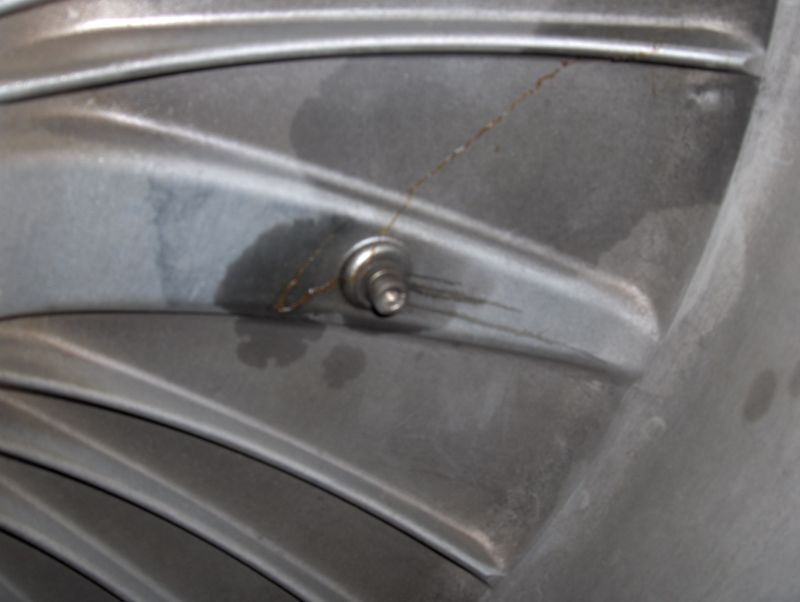

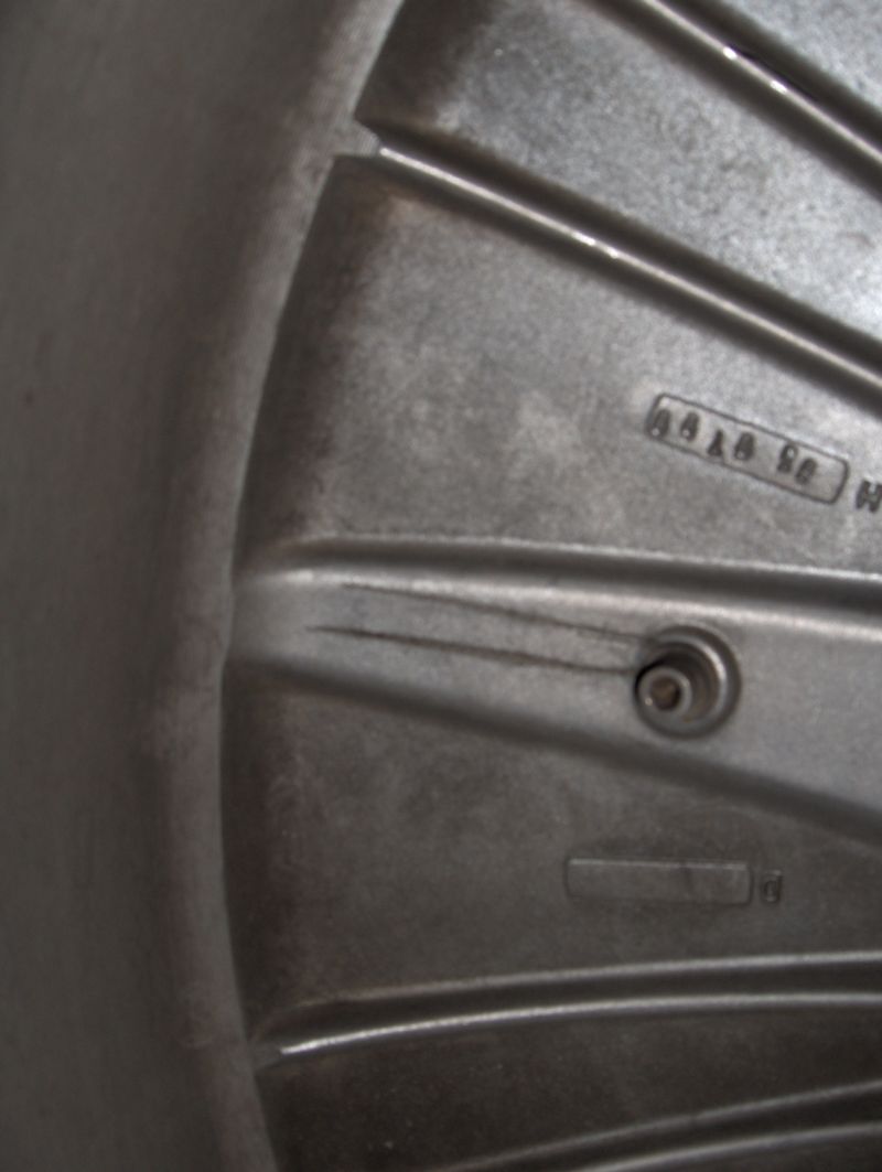

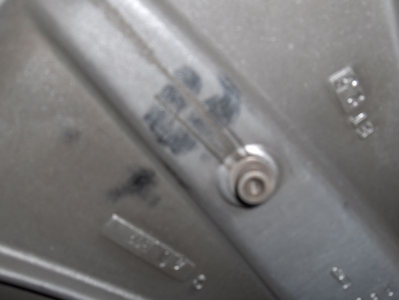

AJxtcman
1098 posts
Member since Nov 2006
This is a picture of an 26" aluminum rim Damaged by loctite 277. It is a floater. The bolts are to hold the backing in place.
Just think about what loctite does and how it could damage the aluminum. 277 red loctite contains the following
Cumene hydroperoxide
MSDS facts for---- Stability---- Incompatible with a variety of organic materials, reacting vigorously or violently with acids, reducing agents, many metals, strong alkalies. Heat sensitive, decomposing explosively.
The blue loctite contains Cumene also. It could be the cause of the thread failure in the block. Cumene smells like Bondo hardener.
