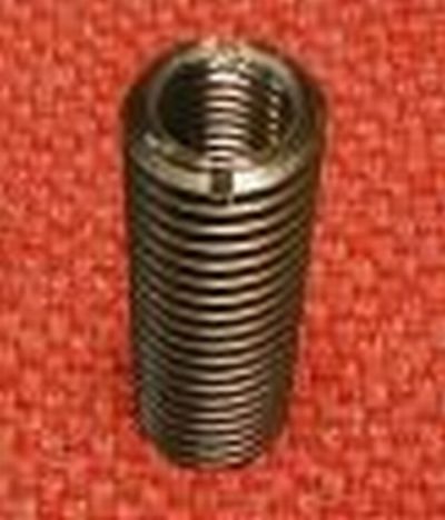

Timesert insert
Ok this is the good stuff Norms insterts
[This message has been edited by AJxtcman (edited 01-26-2007).]

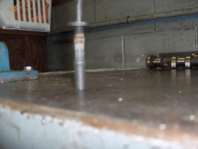

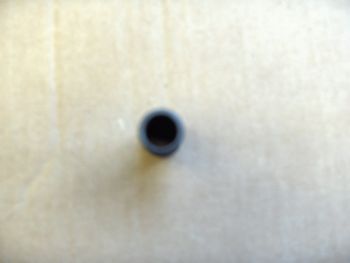

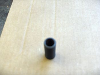

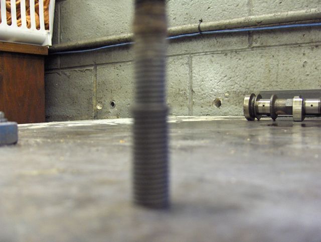

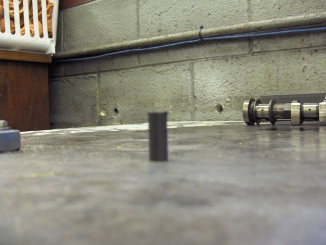

I have some more pictures of Timesert inserts VS NS300L
OK the good one
Now the thin one.
This is a shot from the top so you see the lip and it looks thicker than it is.
This is the bottom side.

DUDE! Chill already. Have you ever used one of these inserts?
Yes, we get the idea that the metal can be so deteriorated that the corrosion is deeper than the threads of conventional timeserts. Thanks for sharing. You've obviously done a lot of these things. From what I've read I don't think you've done any with the big inserts you keep going on about. If you had, I would think you'd have better pictures of them.
BTW, does your camera have a "close up" mode? It's usually indicated by a flower symbol on the button that activates it. This thread has picture taking advice: http://www.realfierotech.co...viewtopic.php?t=2927
