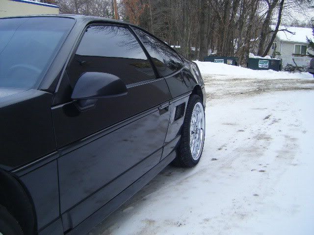

Looks like 18x9's. I have them on my car now and the lip looks the same. the tires are wider off the rim so a 9" rim = 10" on outside. Probable running a 265-40 series tire +/-. Im running a 255-35 on mine and they dont quite bulge from the rim like those., will try to post pics.

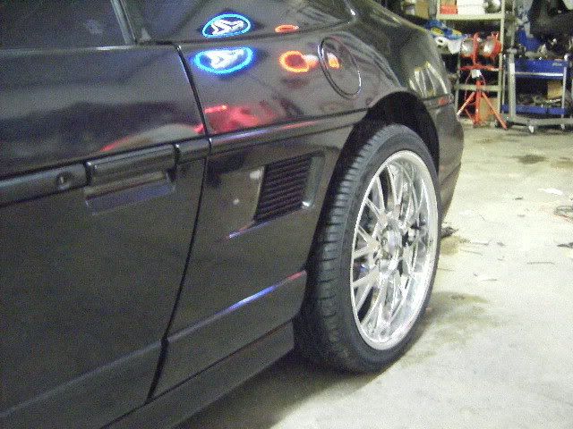

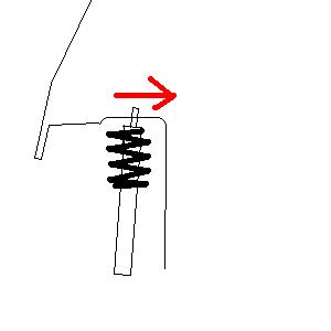

by my mesurments 18 to 19x9 35mm offset will fit under the rear with a coilover if you want ten you will need to move the itire out or the srut tower in, if you look at the first pic you can see the angle in the rear weel top leaning into the car because they moved the tower in thats how they made room for the 10s.
if you move the strut tower i would use 19x10 with a 60 to 65mm offset

The pic of my 88 on the beach is w/ 17x8 in rear and 17x7 in front w / 35 and 42mm offsetts
the other pics are w/ 18x9 on rear w/ 35mm backspaceing. im waiting for my 18x8 for front w/ 45mm backspacing. my 17's are for sale if anyone wants em., got 500miles on em and are perfect., paid 1800 , will sell for 1200 free shipping anywhere in usa !

also, the suspension is stock and nothing moded to fit. its a 88gt. rides tight !, also could use a 2" drop but thats after my fast fieros 3800 sc comes in !

This is what they did for the Bumble Bee Fiero. You have to go with Coil overs for this. Held sells Konis that do the job well.

Originally posted by FieroBobo:
Joe,
Thanks for sharing your setup with all of us. I really like the look. It's strong and agressive, but nicely subtle. I just want to make sure I've got all the facts straight. Your car's running 275/40-17 rear tires on 17"x9" 3-piece Simmons wheels. Do I have that correct?
I also have 3 questions for you.
#1 What is the offset on your rear wheels.
#2 What brand and model of tire have you been running?
#3 Given the wide tires and the relatively light weight of a Fiero, have you had any problems driving on wet roads?
Thanks again for sharing your information, I'm looking forward to applying it to my 1988 GT. Bob
I went with the factory offset, thats the distance the hub or the face of the rims move outward. The backspacing is measurment of how much the rim goes inward towards the strut. I have 7" of backspacing which at 17" rim gives me just enough clearance between the tire and rim. Obviously the coilover allows me to do so.
You have the rim size and tire size correctly.
The tires are the Bridgstone Potenza SO2's
One thing I can say is the car rides amazingly in both dry and wet weather. One year I went to Carlisle P.A. I drove their in 8 hours of rain and almost the same on the way back. at some paoint in N.Y. I got pulled over for speeding.. I think the car handles the way it does due to the alignment which I have it set to stock and the suspension set up.
blkcofy
Posts: 343
From: Cincinnati, Ohio
Report this Post12-22-2007 01:13 AM Click Here to See the Profile for blkcofySend a Private Message to blkcofyDirect Link to This Post
So that I'm sure, what is the exact offset of your rear Simmons wheels? 17 x 9.0 with ##mm offset?
with such a wide wheel, I don't know how you used anything less than 40 to keep the tire within the fender!
An exact number would be helpful! Did you alter the placement of the rear struts? I've installed coilovers as well, but still didnt think one could go wider than an 8" wheel! I swear those tires look wider than 275! I would have guessed much wider.

I ended up going with a staggered setup with 17 x 7.0 40os w/ 225/45zr17 front and 18 x 8.0 40os w/ 265/35zr18 rears. I don't think it will look anywhere as wide as "black flame", as I still feel he's running wider than he's letting on, based on that picture...either that or that's a wicked shadow!! I got a great deal on Motegi SP7 wheels and Nexen N3000 tires...only $1226 for the whole setup! Keep in mind that I have lowering coilovers and 12" corvette rotors with 88" calipers on my 87" GT.

The rims are Simmons OM series http://www.simmonswheel.com.au/wheels/ 17x7.5 up front and 17x9.0 on the rear. (click on the red wheel)
The tires are Bridgstone Potenza SO2's 215 / 45 / 17 fronts and 275 / 40 / 17 on the rear
