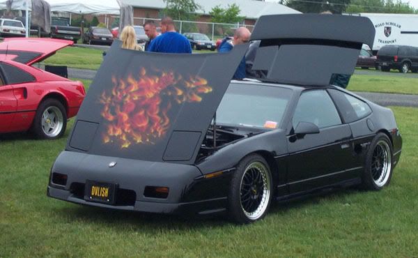

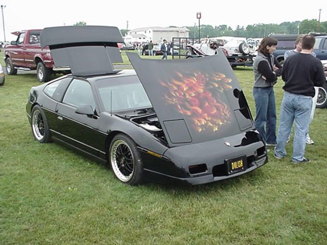

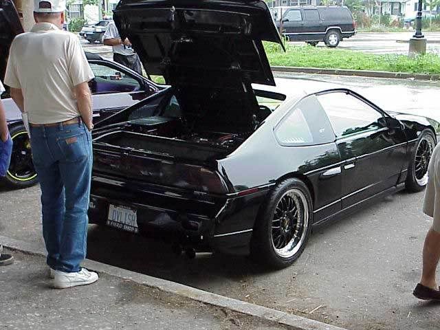

Originally posted by Team Race-Tech:
The rims are Simmons OM series http://www.simmonswheel.com.au/wheels/ 17x7.5 up front and 17x9.0 on the rear. (click on the red wheel)
The tires are Bridgstone Potenza SO2's 215 / 45 / 17 fronts and 275 / 40 / 17 on the rear
Thanks Joe
Race-Tech...Do You Know The Exact Offset Measurement In Millimeters For Your Wheels?
You've previously stated "factory offset", but that doesn't help. All wheels, as you know more than most of us, come in different offsets. The site link doesn't reveal this information either.
The offset of the wheels are 35mm.
