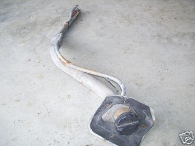

I had a pinhole in the vent line that runs alongside the fill pipe. I got mine out of my 87 GT without removing the rear clip.
Put the rear of the on stands. Remove the tire, front half of wheelwell liner and take out the air intake water separator.
Take out the fuel filler door "cup" (disconnect cable) and unbolt flange that holds pipes to frame and ground strap.
Disconnect fuel hoses from pipes at fuel tank end.
You'll be playing "Twister" with the pipe, but IT WILL come out. It's even more fun twisting it back in.
Looks like this when it's out
