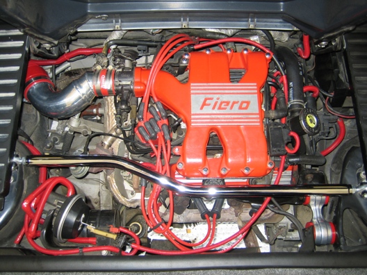

Ok, here is my first attempt at a picture. Finished product, plugs, wires & distributor cap changed.

QckSilver,
I was thinking about changing my plugs soon on my 86 SE 2.8 v6. Could you say what method you used to
obtain better access to the front plugs?
dzimmerm
cdrkmn
Posts: 54
From: palos heights, il, usa
Registered: Oct 2007
Report this Post10-10-2007 10:14 AM Click Here to See the Profile for cdrkmnSend a Private Message to cdrkmnDirect Link to This Post
just like two weeks ago i change the plugs and wires on my 85gt 2.8..... take out the bolt in the dogbone and push the car back a bit and put a brick under the tire.... it rolls the engine away from the firewall giving you the extra room to get in there for the plugs....
then when your done just take out the brick and roll it back into place putting the bolt back in... that simple....
