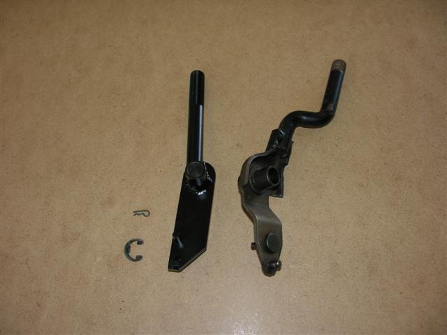

Rodney Dickman, here's his website:
http://www.rodneydickman.com/retail.html
Rodney's shifter is shorter but it also has been lengthened below the pivot to further reduce shifter travel. Highly recommended!
You can shorten yours by cutting some of the length out but you will need to re-weld the threaded portion back onto the shaft.
Nolan
Edit to add picture:
Rodney'w shifter is on the left and a stock 84 shifter is on the right:

If all you are doing is shortening it, just pull it out and hack saw it down. I did it to my 4-speed about a month ago. The only problem you'll probably run into is getting the shift knob back on. The tap and dye you would need to re-thread the shifter is really thick, and I was unable to find one large enough. I have an aftermarket shift knob, and the diameter of the hole in thre shift knob was about the same size as the shaft of the shifter. I used a bench ginger to shave down the shaft a little, and then I just pressure fit (pushed on really hard) the shift knob to the shaft. I'll look into leqarning how to post pics to give you a better idea

Here is a step by step of what I did. I plan on shortening it a little more.
1. Remove screws (under ashtrays)
2. Pull off the shifter assembly cover
3. Pull this pin and slide cable off.
4. Remove C-clip (orange circle) *CAREFULLY* (it can shoot off and disappear). Unplug this plug (yellow circle) and set aside. If you can't unplug the plug (I couldn't), Just pull off this the clip (other yellow circle) and set aside the whole thing.
5. Slide the shifter off and put it in a vice.
6. Hack saw to desired length.
7. I ground down the shifter to make the shift knob fit (thread it if you can) - Green section
8. I plan on cutting it down further (Blue area).
9. Make sure tgo leave enough shaft to re-attach shift knob.
10. Re-assemble
*Note: This is the quick and easy way to shorten the shifter. If you have the money, I would o with Rodney Dickman's shifter. I intend to swithch to his in the future.
