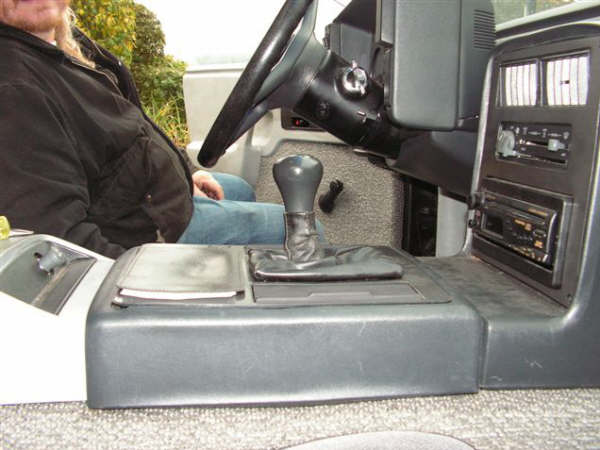

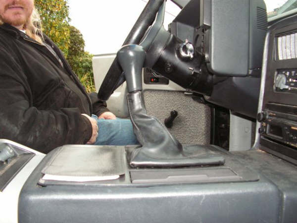

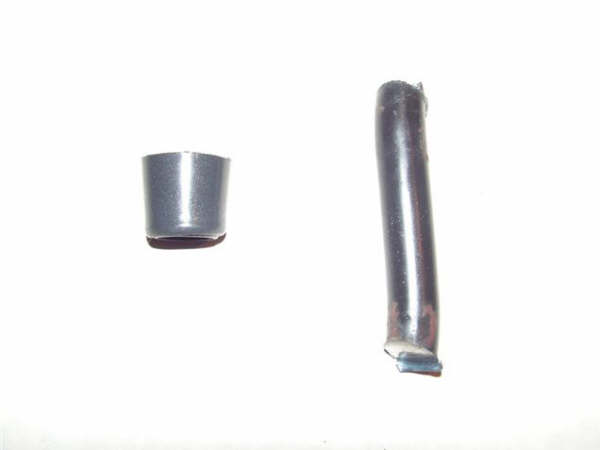

I picked up a shift lever out of an '86 Fiero yesterday and decided to chop the snot out of it to see what I could get.
Here's the remains:
On the left is the piece of the shift knob I had to remove so that I could get the threads to even meet on the new shifter.
Before:
After:
Think I'm going to need to make a smaller shift boot...
The shift pattern is so small now that I can reach all the gears without moving my arm at all. I like the height because I'm no longer hanging my hand/arm off the shifter. My whole forearm rests on the center console.
The shift effort is a little higher now, but I'm hoping to smooth that out a little by lubricating the cables and changing to a synthetic gear oil.

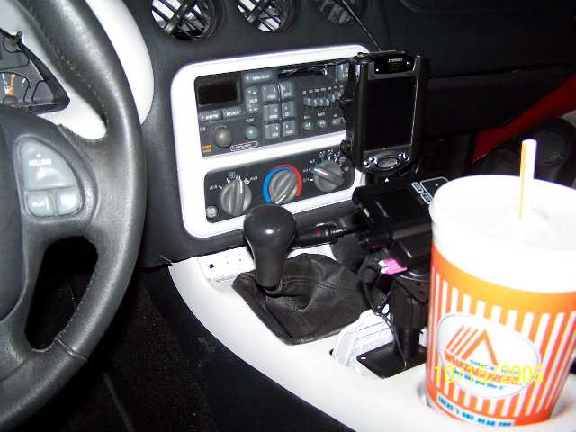

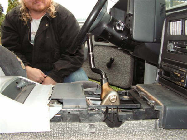

That looks good. I took an 84 shifter and had it cut down. But what I really like is my Ultimate Getrag shift kit which really shortens the throw.
Here is a my cut down 84, a stock 84 and a stock 88

jscott,
Why such an offset on the handle? I find that mine is in the exact right spot without the offset.

I did one just like that when I had my Isuzu. It works great on the Isuzu because that transmission shifts so easily (especially with Synchromesh). I put in a Getrag and had to switch back to a longer shifter to get it into gear easily :-(.

Originally posted by Icelander:
jscott,
Kendall
I thought you might ask that. I originally posted a pic but I didn't want to steal your thread, but since you asked...
My car is not stock, If I have a 64 oz cup in my cupholder I have to reach around. And I just added a satellite radio in the old ashtray spot. I shift it like a sidestick controller.
