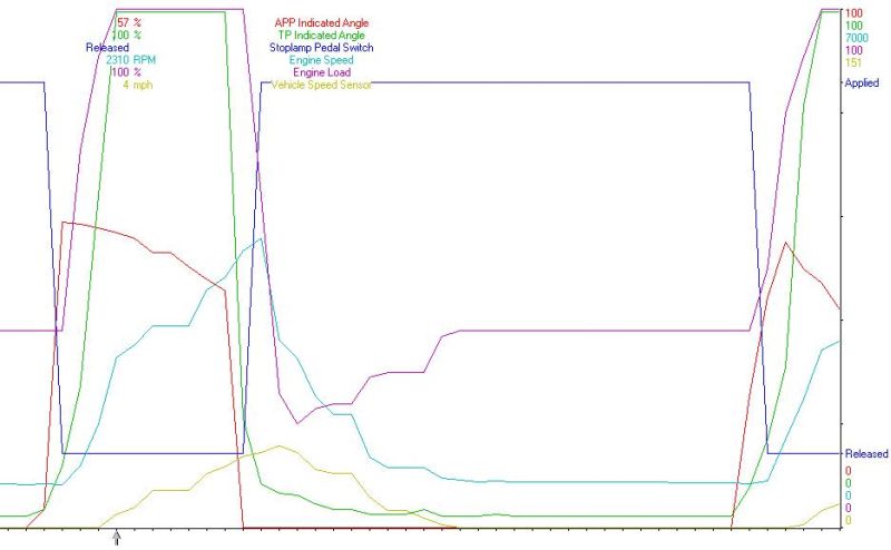

Interesting snap shot.

This customer complains of traction engaged too often on acceleration. If you look at the snap shot you will see 57% APP or gas pedal input and the ECM opens the throttle to 100% as shown by 100% TPS. It also shows 100% engine load even before the car moves. This can work both ways. It will run 60% throttle at 100% APP.
