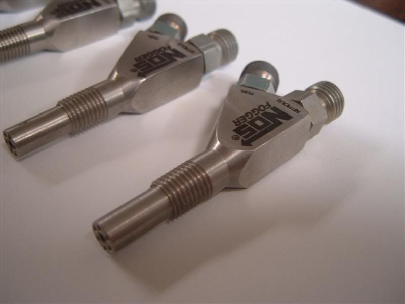

this was my direct port on my 86
now im doing this to my 87 but i think i have to hide it under the intake because the throtle linkage is in the way on the top.
