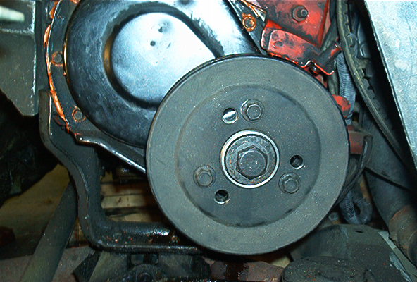

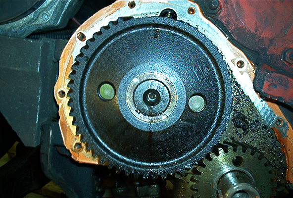

it's all back together, and running, though i'm still getting a few bugs out.
as promised, pics: first, the destroyed fiber gear
next, the new fiber gear. unacceptable.
and the new metal gear: cloyes part # 2524, for a '72 chevy nova 250 6cyl.
today i took it around the block, and halfway out i heard "flap, flap, CLANG! clink, clink.." naturally, i shut it off right away and pulled over. no smoke or flames, this is good. thrown belt, no biggie, but what's this? where's the pulley? i walked 20 yards back up the road, looking in the ditch, no pulley. i look under the car, and there it is, on edge, jammed between the road and the AC pipes. durnit, that's where those 3 leftover bolts came from! fortunately, of the 2 wrenches i had with me, one was 13mm, and i made it home just fine. note the 3 bolts on the 2X4 in the lower right of the pic, next to the pulley. doh!

this is the set of gears I got: Timing gear set (aluminum cam gear and steel crank gear) bought off Carparts.com a division of JCWhitney, Set, 2.5-R (151) ENG; 1982-86 Alum. Includes 2524 & 2537 • Usually ships in 7 - 10 business days. MELLING Part Number: 2538S Price as of 3/9/02: $35.98 Took about 3 weeks to get from the factory.
10:51 PM
lurker Member
Posts: 12351 From: salisbury nc usa Registered: Feb 2002
my gear (just the cam gear) cost me more but i had it in 24 hours. it came with a sheet suggesting putting it in a pan of boiling water for 5 minutes to expand it. i got a shop to press the old one off and new one on for $10.
