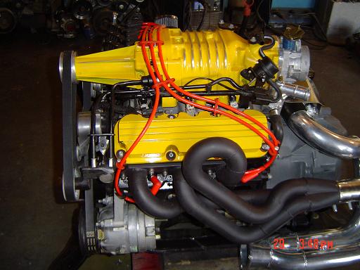

http://www.fastfieros.com/projects/matt_3800/index.htm
of all the exaust jobs I have seen, this is my favorite! Lloyd did you design and make those headers?
for everyone, this is what im talking about:

Those look like headers that were made by Performance Solutions... at least I think that is what he called himself. He made them for a short time, then stopped. I actually owned a set, but decided to go a different route, so I sold them.
edit - here is the link that introduced them. If you do a search in the archives, you will find more info on them

No, I did not design them. Jeff only made about 15 sets of them. Headers done 'right' are very difficult and expensive to build. $950 is a good price for a good well designed set with ceramic coatings.
I am sure if Matt Jackson see's this post he can tell you the nightmare of these headers with the welds. The crossover needed a v-clamp flange also, and not the butt up jointing that Jeff tried to use.

I spoke w/ Jeff about 2 weeks ago and he started his own auto body repair shop in MO. He left the Fiero world some time ago for a RX7 w/ an LS1 installed.
He did make a set of equal length headers for his personal GT, & said that it was a total ***** to get it finished. Not true duals, but pretty cool none the less.
They look good but like Loyde said, if they don’t hold up then they are not worth their weight in recycled steel. I did have a set on my 38oo SC ( now sold ) that didn’t have any issues but again this was not the first time that there has been a concern w/ the headers.

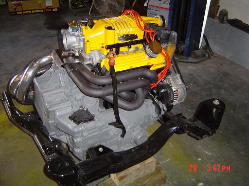

the only pic I have from under with the exhaust in place.. no tips still however. I just put some 2.5" mandrel out the back outs with chrome tips. As you can see, I did not cut the trunk on this install. I could have put a CAT in place also, but the customer requested no CAT.

I suggest that any pipe that collects exhaust from all 6 cylinders be run in 3inch.
On even grand prix's, the 3inch downpipe upgrade is a very significant one, in the fiero world, we have to make extremely restrictive 180*+ bends that ruins our flow even more.
I ran 3 inch on mine only because I knew I want going to run anything outragous with the setup, but if I planned on some bigger power with stock manifolds, I would of went with a custom 3.5 inch setup to try to equal out to a 3 inch straight downpipe like the grand prix.

What the heck, I thought I was the only person to use the yellow setup ?

Paint just adds unneeded weight.

Paint is pretty The only thing about yellow is the color collects dirt fast And easy to see, I wish I used a darker color for my theme, But I have seen silver,Blue, Red (very common) Green, Yellow,Black, orange and I seen a purple supercharger before This is the first supercharged 3800 to use the same color as mine, This one looks to be either hotrod yellow or daytona yellow, I used catapillar yellow because it's actually a darker yellow, Almost looks orange.
If he paints the transmission gloss black, it will look awsome.
It looks very clean in this pic, But after driving it so much, It is now much much more dirty.
