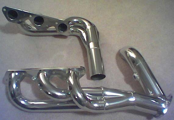

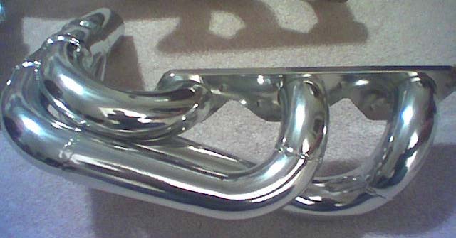

Here are the pics of the headers that are for another customer, and overall the look for the look, fit and finish of the headers that one will expect from performance solutions:

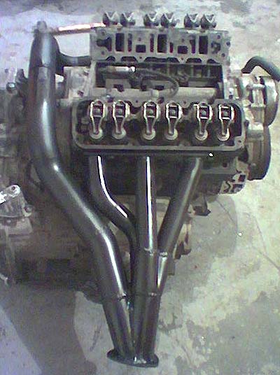

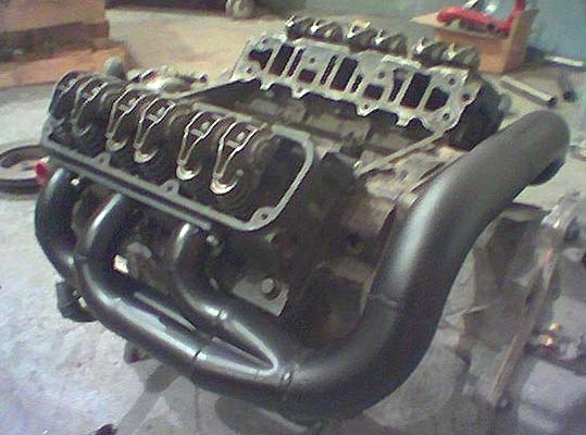

For all those that are looking to the Series I headers for the 38oo, you should know that the proto-types have been started, and the flanges are being fabricated as you read. Time tables for the Series I should be on the fast track, and we will definitely keep you updated as things progress.
This is another project that we have going on at Performance Solutions. This is **NOT** for a Fiero. These are for the GRAND PRIX guys

Purty, anyone gotten any running temps off those yet? Is the coating you had used on inside supposed to retain the heat inside the pipe?
Only complaint... looks like they aren't even vaguely optimized/equalized for tube lengths. What if any design criteria was used besides mandrel bends?

Oh come now... you gotta give them some credit. Those are some NICE headders, and I wouldn't mind having a set of those on my car.

Those sure are purrrrr-ty! So these headers exit it the stock Fiero location?

The only thing I don't like about this design is that the connection for the two banks is held together with a band clamp and no type of gasket. In other wards, they build up the headers on a block, completly weld it together, and then cut the two banks apart. I personally would like to see a flange here or one side lengthened and expanded so they slide together, but they assured me that they used the clamp on a set for a year without leaks.

hummm well by the pics (chrome ones) I don't see the connection ( No Y-pipe?) and where the collector is, would put it close to the intake tube wouldn't it?
Nice though.
and why post a pic of something that does not belong on a fiero? try clubgp.

My headers use a band stye exhaust clamp in the middle as they work very well. I have used this stye of clamp on streetrods for years with no falures to date. In my younger days I have changed a many of collector gaskets. I like to design my parts to be as trouble free as possible. By using this style of clamp you will never need to change the gasket. ( that WILL blow out in time)
