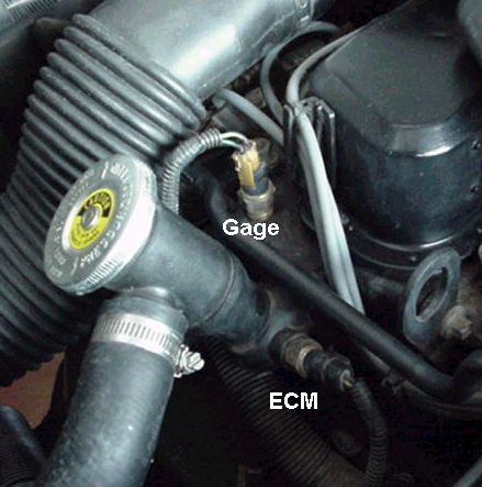

There's THREE temp sensors on that engine. One for the gauge, one for the fan and one for the ECM. So even if the fan comes on and the gauge reads right, the ECM can still be confused.

I have only been able to find 2 temp sensors, where is the 3rd? I do believe the ones that I have are working. 3800, thanks for that, I will give that a try in the next day or 2. Something just hit me while in the thinking room, could the slow start be caused by the fuel pump not coming on when the key is turned to on? Or does the pump not run until the key is put to start? Is the fuel pressure regulator inside the pump assembly or is it external to the tank? Thanks everyone, we'll get it. Thanks Scott

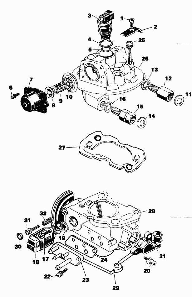

Report this Post07-27-2006 08:32 PM Click Here to See the Profile for spark1Send a Private Message to spark1Direct Link to This Post
The pressure regulator is in the TBI. It's the red rubber diaphram shown in the picture below. A spring holds tension on the center metal piece to control pressure.

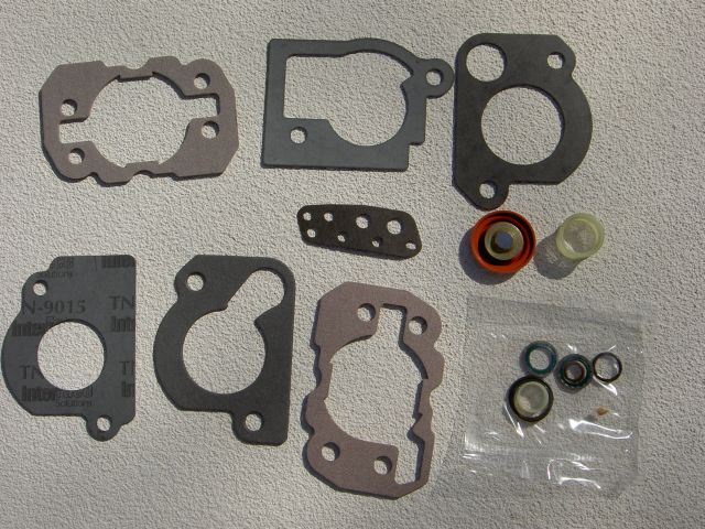

Off topic, but where does one get the gaskets shown in that picture? I partly dismantled my throttle body to clean it without realizing no one seems to sell the gaskets I ruined...

I got that same kit from Advance Auto. Let me get the box and I will get the part #. Scott

Report this Post07-27-2006 09:22 PM Click Here to See the Profile for racer37Send a Private Message to racer37Direct Link to This Post
racer37
423 posts
Member since Sep 2002
It is part # 1637BS, at least that is printed on the box. Can somebody point in the direction for instructions on rebuilding the TBI, i.e. changing out the fuel pressure regulator. Thanks, Scott

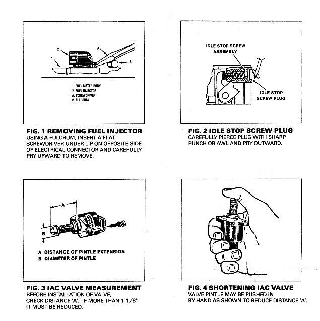

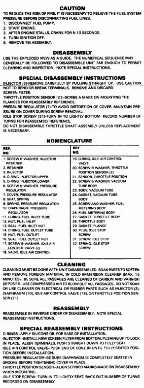

Report this Post07-27-2006 10:58 PM Click Here to See the Profile for spark1Send a Private Message to spark1Direct Link to This Post
racer37
Posts: 423
From: Dawsonville, GA
Report this Post07-28-2006 05:27 AM Click Here to See the Profile for racer37Send a Private Message to racer37Direct Link to This Post
Thank you Spark1, that is what I have been looking for. Hopefully I will fix any fuel delivery problems this evening. Thanks again, Scott
Which 2 did you find ?

On the Duke, the ECT sensor is screwed into the side of the thermostat housing. If this sensor (or it's connector) is bad it'd cause all the problems you're describing.

I played with the TBI this afternoon, replaced the fuel pressure regulator and pulled the injector to replace the o-rings and the screen. It didn't look like there was anything wrong with the regulator, just a little corrosion. When I started the car, that didn't change the rich condition. I did notice that fuel pump starts with oil pressure, it does come on with the key. Something else to fix. After it was running, I unplugged the IAC and that did not change anything. Does that mean that the IAC is not electrically, or is the ECM reading some many parameters out of whack that it is confused? What do ya'll think?
The temp sensors that have located are on the head (straight up to the right of the thermostat housing) and in the thermostat housing. It seems like I read somewhere on here that the 88 only had 2.

Oh yeah....... I still haven' t found the third temp sensor. Or am I confused with earlier years? THanks again, Scott
spark1
Posts: 11159
From: Benton County, OR
Total ratings: 175
Report this Post08-01-2006 08:08 PM Click Here to See the Profile for spark1Send a Private Message to spark1Direct Link to This Post
There are only two water temperature sensors on the 88 cause the ECM controls the fan motor. There is another temperature sensor (air) in the intake manifold, called either IAT or MAT.
racer37
Posts: 423
Report this Post08-01-2006 09:42 PM Click Here to See the Profile for racer37Send a Private Message to racer37Direct Link to This Post
Just 2, I was thinking right. Thanks for the picture. Now if I could just get the IAC thingy working, I think it will run decent. Thanks, Scott

I just swapped ECMs again, seemed to run much better, but won't idle. I tried to set the idle using the procedure above. After I get it to just barely run with the IAC unplugged, it wont idle at all after resetting the ECM. If I do get it to idle by adjusting the screw, it runs extremely rich and blows a tremendous amount of black smoke. Maybe I just need a throttle body that hasn't been messed with.
Before I give up on the TBI, does anyone a manual with the GM procedure?
Thanks for any and all advice. This thing is about to drive to smoke again. Thanks, Scott
racer37
Posts: 423
Report this Post08-14-2006 07:32 PM Click Here to See the Profile for racer37Send a Private Message to racer37Direct Link to This Post
racer37
423 posts
After reading my 84 shop manual, it looks like I need to get the car on blocks so that I can "drive" it so that the ECM can go back to school and relearn what it has apperrantly forgotten. I can't drive it far on the street, no tags, no insurance, and everyone around here has what seems to be a personal deputy. Maybe that will me. Thanks, Scott
