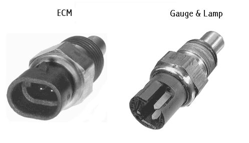

Pic of the 2 sensors, the ECM sensor is the one I am talking about:
You would first use the Ohm part of the multimeter to check resistance on the sensor. The good thing about the multimeter is you can use it for many, many things, not just auto stuff. Some guys like to have both the analog type and a digital type. I have both simply cause I bought the analog first since it was cheaper. Digital is easier to read.
Basically, check the 2 connectors on the sensor itself when full cold. Compare the reading on the chart. Then start the car and watch the reading. It should change as the car warms up.

I checked and that one is one of the new ones. Nice an shiney. I'm so confused on this. I guess I should probably check the fuel pressure and vacume pressure. How do I do that, what tools do I need?

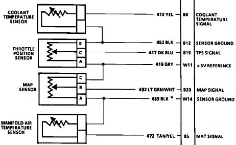

I'm onto somthing. The car started getting hot. I unplug the connecter (ECM) fan turns on. Plug it in and wiggle the wires, fan shuts off and engine continues to get hot. IS my sensor bad? Or is it just the wires and connection. grrr
[This message has been edited by CoryFiero (edited 03-16-2007).]

check the input ait temp on the air filter assembly, a 2 wire sensor on the filter canister. the previously posted chart of resistance is valid for this sensor too.
Seems like odd behavior. Are you sure the sensors and wiring are correct? The sensors are sometimes confused and plugs are rewired to fit the wrong unit. Here's what the sensors and wiring should look like:

It is the correct sensor.
Former owner said it was new and it looks new.
I don't know if I described it right last time.
The car was getting really hot, I unplugged that connector and fan kicked on. When I plug it in the fan always immediatly turns off. Now if I wiggle and bend the wires just right the fan will come back on, but I think it's just loosing the connection. Is this what happens when the sensor is bad?
Also I just burped the coolent system. No help.

I just looked at the '88 2.5 ECM pinout. It looks as though the ECM is in control of your cooling fan. So the ECM temp sensor's signal to the ECM is used to turn the fan on and off. The fan turning on when the connector is pulled is probably a safety setting. It does not tell though if the sensor itself is good or bad. You still need to check the resistance on that sensor.
If you get a multimeter, you can check the resistance on all your sensors as well as the coils. My only suggestion is to go over the sensors one by one, see if they are within spec. If everything checks out, then you can move on to the fuel system.
