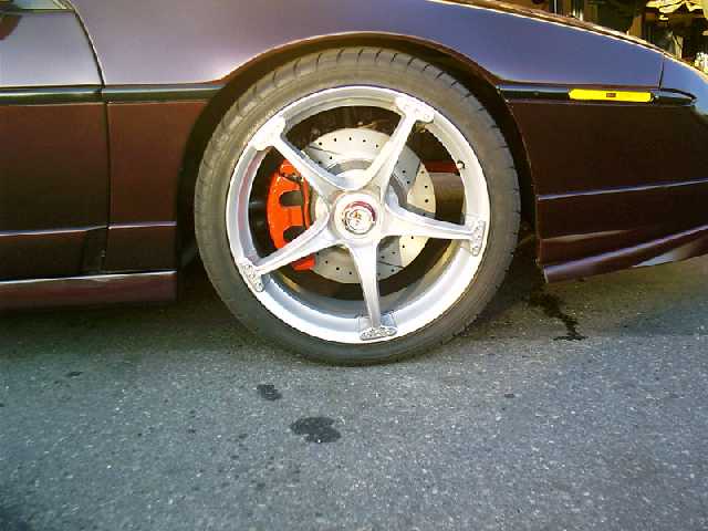

Folks:
The following link will take you to a photo of a new brake package using 13" Viper Rotors and Corvette Calipers that is under development at West Coast Fiero: http://www.fieroswest.org/Page2.html
Also, if you are in the area please attend the FierosWest Barbeque on Saturday, May 13, 2006; details are here: www.fieroswest.org
Regards,

Very interesting. My question is why not use the Viper brakes with the rotor?
Durkin87Turbo3.4 DOH
Posts: 31
From: Irvine, CA USA
Registered: Mar 2005
Report this Post05-01-2006 12:46 AM Click Here to See the Profile for Durkin87Turbo3.4 DOHSend a Private Message to Durkin87Turbo3.4 DOHDirect Link to This Post
Good Question!
The answer is best given by West Coast Fiero, but one reason is to keep the Emaegecy Brake operational. Another is to keep the cost down.
Regards,
David

!3" rotors have been around for a while, but most (I think) used the very heavy Corvette rotors. The Viper rotors are thinner and much lighter.
madcurl
Posts: 21401
Total ratings: 314
Report this Post05-01-2006 05:44 PM Click Here to See the Profile for madcurlSend a Private Message to madcurlDirect Link to This Post
By how much is the weight difference?
More importantly, how much is the COST diffrence. saving 5lbs isnt worth $50 a rotor price increase to me. Dunno what the prices really are, but im assuming with the smaller market and higher base price, viper rotors would fetch a little more

I'd be interested to see what the difference in moment of inertia is. That center hub looks pretty big.
There is only one problem...heavy and thick rotors are better for braking performance.
Being thick, they have better venting and can dissapate heat better than thinner rotors. They also are less prone to warping.
If they are heavier, they have better thermal capacity. That means the increased mass makes it so they can take more braking before they reach the fade temperature of the pads.
This is just like the Grand Am upgrade for 84-87 Fieros. It does not increase stopping power (same diameter), but it increases cooling and thermal capacity, so they take longer to fade.
The only upside I see to this upgrade is slightly improved accelleration and handling due to reduced rotating and unsprung mass. You might as well just do the 12" upgrade if you don't think you want the corvette 13"ers.
Finally, if you are using the Corvette calipers made for the much thicker Corvette rotors, will they work reliably on thinner rotors? There is a minimum thickness on rotors for a very good reason; caliper SAFETY and RELIABILITY.
More info at: https://www.fiero.nl/forum/Forum1/HTML/043357.html

Correct... larger rotors don't automatically equal shorter stopping distances... stopping distance is more of a function of brake pad material, piston pressure, hydraulic line pressure, and tire grip. Larger/Thicker rotors tend to be mostly needed for road racing, where temp control and brake fade are of great concern. Something that is almost never a concern for normal (or even aggressive) street use. Many magazine tests actually show longer braking distances with larger performance rotors (probably due largely to increased unsprung weight), but signifigant gains in temp control after heavy use. (SCC Magazine has been doing a few real-world articles relating to this topic lately).
That being said... the Fiero definitely shows dramatic improvement with even small (Grand Am) Brake upgrades. But I think once you get over about 11" diameter (LeBaron Brakes), you're really just getting the visual appearance more than the performance gain. At some point you can take into consideration increased thermal control vs. increased unsprung weight (which can have huge negative effects on handling).

I will get the weight data and some comparative sizing photos from both angles; we weighed the 12" Vette rotors, 13" Vette rotors and the 13" Viper rotors. I cannot rember the exact numbers at the moment, so rather than give out bad info, I will wait.
The Viper rotors were a bit heavier than the 12" Corvette, but much lighter than the 13" Corvette. The calipers are the standard Corvette Gen 4 models. Put another way they have more mass than the 12' vette, but far less than the 13" Vette (which I think is overkill); nice compromise I think!
In any event they are sufficient to stop a much heavier Viper, so my guess is that they will be just fine on a lighter fiero.

88 Fiero rotor: 10.5 lbs
11.25" (?) LeBaron rotor: 13.9 lbs
12" Corvette rotor: 13.9 lbs
13" Dodge Viper rotor: 16 lbs
Note this is just from memory.. I do know the LeBaron and 12" Vette rotors weigh exactly the same amount, and the 88 rotor is indeed 10.5, but I'm not positive on the absolute weights of the 12" vette and 13" viper rotors. The Viper rotor is only a few lbs heavier (2 or 2.5) than the 12" Vette rotor.
Anyone know how much the 13" Corvette rotor weighs?

Originally posted by Steven Snyder:Anyone know how much the 13" Corvette rotor weighs?
C5 Vette 13"x1.25" rotor weighs ~18-19lbs (Autozone replacement rotor, weighed with bathroom scale)
C4 Vette 13" rotors weigh ?????? (think they are thinner, maybe 1.1"?).
4th Gen F-body 12"x1.25" rotor weighs ~16lbs.
