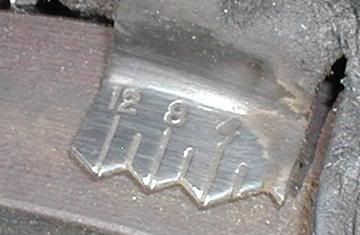

In chasing down the fuel smell, I decided to check my emission cannister, When I removed the lines one smelled/sounded like it had fuel in it. After removing the canister the round filter at the bottom just fell apart. The canister has a fuel smell but does not seem to have fuel inside if I shake it. Do I have another problem?
Also, I wanted to recheck my timing after removing the distributor to replace the cold start injector. Darn V6 timing marks are a bear to see. Which mark "VVVVV" is 10 degrees? Maybe it's time for bifocals.

Report this Post04-23-2006 04:09 PM Click Here to See the Profile for DodgerunnerClick Here to visit Dodgerunner's HomePageSend a Private Message to DodgerunnerDirect Link to This Post
This help Rick

Thanks Dodgerunner! My timing is now set correctly.
