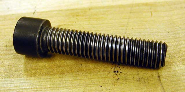

Report this Post04-10-2006 11:36 AM Click Here to See the Profile for Marvin McInnisClick Here to visit Marvin McInnis's HomePageSend a Private Message to Marvin McInnisDirect Link to This Post
Originally posted by Marvin McInnis:
Remove the other attach bolt, inspect it for wear or damage, replace it if it isn't still perfect, and re-install it using thread locker.
Here is a picture of a caliper attach bolt from my Formula. This one didn't fall out, but it was on the same caliper as one that did. It must have been loose for quite a while before I bought the car; note the obvious wear on the crest of several of the threads. A safety-critical bolt with visible wear like this is damaged, and should always be replaced!
