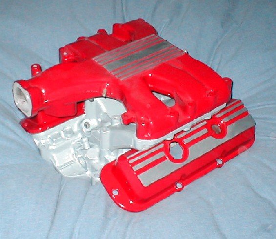

For $100 and $25 shipping I will send you one that looks like this:
Powder coated in ruby red (it is a little darker than factory) and the middle intake in alluminum powder. They look good! There is a lower intake in the pic, you won't get that, I am out of them.
If you are going to do it yourself, the best way to go is to strip off the old paint first. Chemical or sandblast is best. Primer with a zinc oxide primer. Then paint it with a quality automotive paint (not something out of a spray can).
Sort of depends on how picky you are though. If you just want color that lasts about a year or so, paint it with spraypaint. It will look better, but definatly not profesional.
