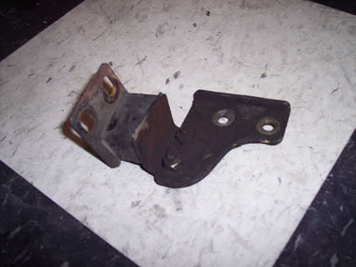

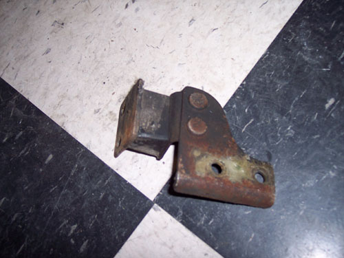

I have every thing together but it looks like it wont be my ride for tomorrow
I have two questions I was hopping some one can help me on
where dose this part go?
is this a part I forgot to install or is just another one of my sons parts mixed up in mine

That extra part looks like the front engine mount that is under the pulleys on the engine block, but it probably isn't even a Fiero part. I'm sure you would have noticed if it was missing from your car by now.

front motor mount I would asuum it could not be that, some thing is holding the front of the motor up so it shouldn't be that, I never detached the motor from the candle so it should not be that.
I hope not, I will have to look

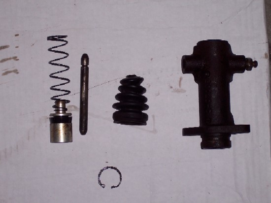

I got the slave out and found that some one has already rebuilt it, that not the stock piston right?
after reading all sorts of threads on this yesterday I was hopping to find the stock piston and just replacing the O-rings since all I could read was bad things about those pistons with just one O-ring,
And it looks like all the mud I though was rust was really grease, I found lots of dry grease around the piston, it was mentioned in one thread that it helps putting grease on them to help them not suck up air.
Can some one tell me the best way to bleed this system with an after market piston in my slave?
Or is the best thing is to hit the junk yards for an original one? That won’t be easy
Suggestions
Can some one at least tell me if I should put grease again, the place I read it just mentions that he herd that they put grease to help sucking air. I was hopping i could heir about some one that did it and how much grease do I use and do I have to be careful where I put it.

That slave looks like cast iron. It wasn't rebuild, it's not even the factory slave..

that makes sence, thanks for the heads up on what I have.
it worked fine before i took it apart, so i will try reinstalling it again and see what happens.
