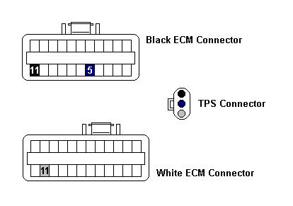

I think I figured out the wiring from the fatory manual, is this right?
So should I just cut the wires at the ECM connectors and at the sensor's connector, and run new wire to each place?

It could be worse, maybe there is a 'bad' spot in the harness where the wires are broken, rotted, cracked, melting/melted,etc..
I would pull the loom off that section of wires and check them all. The other wires may be damaged too, but only that certain one is bad enough to show signs. Preventative maintence ya know... I had that same issue blowing the hell out of starter relays. Completely ruined them, I pulled the harness apart and I found this..
