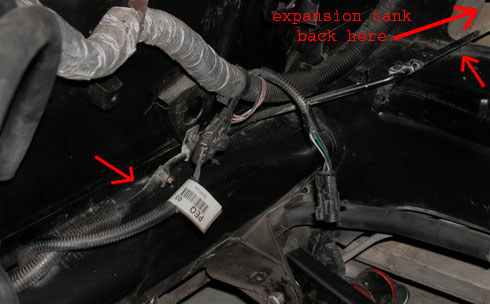

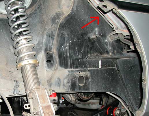

Originally posted by Tom Slick:
thanks steven.
do you have photo of the expansion tank cause i can't find mine (i have an '88).
the previous owner probably took it out, if thats the case do i need to add it back?
Yeah, here's a pic so you can see where its located. This is the passenger side wheel well..
You need to add it back if its missing. One line on it goes to the fuel tank via a hard line, and the other goes to the evap canister. If you dont add it you will quickly destroy your evap tank on a hot day with a full tank of gas because liquid gas will likely go into the evap canister! 87-88s have the expansion tank because the space used for expansion in the earlier fuel tanks is used for actual fuel, thus requiring the use of a remote expansion area.
thanks for the photo Steven.
well this just sucks!!!
where the expansion tank is located is where i was going to mount my evap canister.
now i got to find an expansion tank. i don't have any of that hardware in my car. it looks
like the previous owner took it out.
thomas...
