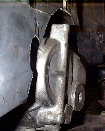

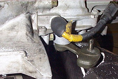

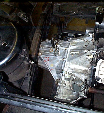

Here is our chassis mock-up lowered down onto the 6 speed set up.
Boxing in the chassis will be needed not only for workmanship but also to retain structural strength of the chassis from the modifications. Due to the 5 inch length difference, this modification became manditory.
Further modification to the cradle will be boxed for workmanship and strength.

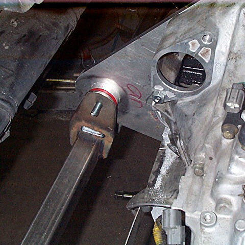

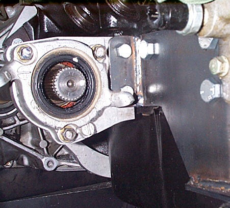

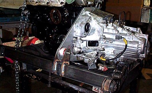

Before the chassis was put on this became the latest experiment on securing the tranny to the chassis. The adaptor plate has become a mounting point onto a new cross member of the cradle which would replace the stock cross member further below. As with everything else, it is still too early to see how well this work out when all the other accesories are put on. It is but an exploration into what will work and what won't work in this conversion.
Another view of the adaptor plate mount in the chassis mock up looking from the driver's side.

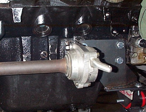

Here, the 3800 Engine Mount Bracket has been modified to mount the half shaft support.

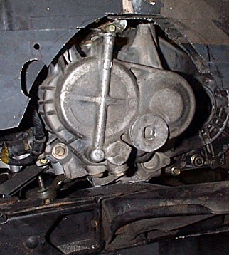

Another picture of the half shaft bracket.

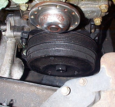

Pictures of the chassis modification from the wheel well view.

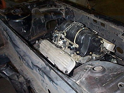

Front of engine clearence for the 3800. (Pretty good clearence, eh spddy?)

Report this Post01-13-2005 02:09 AM Click Here to See the Profile for The AuraSend a Private Message to The AuraDirect Link to This Post
If you look closer you'll see that it is more than the wheel well being trimmed out... infact it appears over half the frame rail has been removed...
will boxing the rail be enough to get back the structural integrity?

We are currently attempting to use the Getrag 5 speed cable lengths. We don't foresee any complications at this point.
It doesn't sound like you've factored in your time invested (manhours equivalent to a typical shop rate). Time is money.
Boxing the rail section should be more than enough to retain the integrity but we plan to put it to the test with the Turbo Aurora set up. Chris is not known to baby his car in the mountains or against Corvettes.

Originally posted by WKDFIRO: We would much rather have the back end of the tranny in the wheel well rather than the crank and water pump pullies.
I'd much rather trim sheet metal than cut out big chunks of frame.
I have noticed a remote electric water pump is a simple cure for the "wheel well pulley blues" so many have.
What's your easy fix to avoid chopping up the frame?
This I would like to know as well, Quite frankly I would rather go with the weaker getrag adn build it with sonic-harded gears then to chop the framte to get that to fit... Of course even then I dont think a getrag could take 500 HP...Quite a delima indeed. This will be interesting to see how it turns out.
Not that I would like to go into the electric water pump "cure" but in order to find alternatives to any operation one must become familiar with the initial procedure followed by severe testing under real world conditions. Only then alternatives can be explored.
As for the gearing, this has been a consideration since the beginning of the project. It is very likely that different gear ratios will be available but its an aspect of the project that will be dealt with later on in the build up.
The mock up chassis that we were using needed to be used for a turbo 3800 build up and has put Project 5/6 Speed a little behind schedule. Since the turbo build up has been completed we are currently resetting the chassis for resumption of the project.
