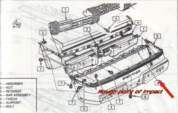

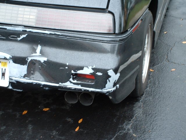

I was almost ready to get the car painted for the Daytona show when I was rear ended yesterday. Long story short, they want to total the car but I am trying to avoid that. They say there is damage to the frame rail...how hard will this be to repair?

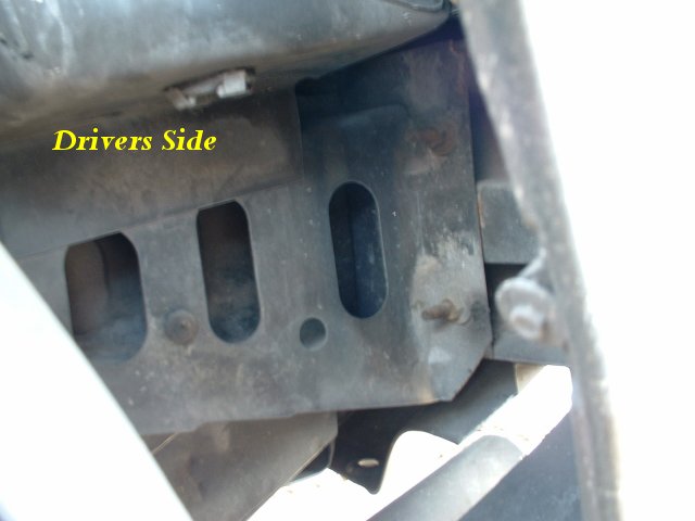

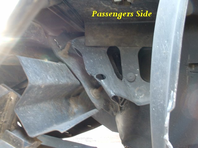

Picture shows majority of damage was taken on passengers side, no damage forward of the trunk. Car remains mechanically sound. Can I get opinions on whether or not you think they will total this? I have yet to hear from them...those that I have spoken to (from the insurance company) have gone both ways....some say yes it will be totalled others say no. Of course I am hoping its not. I won't know till the adjuster is in on Monday.

I can't give you advice on the rules of a totaled vehicle - but that can definitely be fixed without much time or trouble. I had a similar incident and repaired it all myself.
You'll need a new rear bumper bar (the metal that runs width-wise from one impact zone to the other), possibly new impact zone pieces (looking under the car they look like box sections of metal with ovals cut into the side). If the impact zones arent crumpled too bad then you can bend them out and possibly slap a piece of sheet metal on them and tac weld them to ensure proper support. If new ones are required due to the damage then you can get them from most any old fiero. I got mine from Ed Parks down at the Fiero Factory for a good price. Depending on the condition of the bumper cover (rear fascia) you will eaither need to repair or replace it. Same with the tail lights and license plate lights. Take a look at your exhaust too as mine was pinched closed due to the other cars bumper hitting the end of my pipe and bending it. If this happened to you you will need a new one, possibly a new cat if it got cracked or damaged as well. Look close at your trunklid and see if the locking mechanism was damaged. Of all the things that I've fixed on this one, that is one that has given me the most headaches. If the fiberglass on the trunklid is cracked where the trunk release or lock is mounted, it will give you alignment problems. Just need to repair that section, but I have yet to do that. The trunk is actually the easiest. Just use a hydraulic ram (small cheap one) to pop it back out, it holds it's shape real well as long as you never had rust down there, and I didn't. Once popped out use some rust preventative paint to protect in outside and inside and throw your carpet back in.
Overall it looks worse than it really is. The only thing I can't tell is if the frame end on the passenger side got jolted out of place during impact. My frame rails were perfect before and after, the impact zones took the damage. If your impact zone took all it could and the car kept coming, you may have bigger issues than I had to deal with, and I can't give you much advice at that point. Overall - this really isn't that bad, and is VERY fixable. Hang in there. You mentioned you were about to get it painted, hey, at least it happened before... LOL
Take care - good luck!

He very well could have been looking at the little crush zones I was speaking of. They are welded right to the end of the frame rail, so it literally looks like, and I guess could be considered, the same part. Trust me, my impact pics were a lot worse than yours and mine is as sweet as can be. If those impact things were damaged badly just cut them off, making sure you have a way to line up where the replacements would either bolt or weld on. I modified mine to unbolt in case anyone decided they liked the rear end again, but you can weld them just the same. Email Ed Parks at www.thefierofactory.com and he'll give you a good price and ship them if needed. I can't remember but $15 per side is what he charged or something..... Not bad at all. He also sent the bumper which was very economical too. He'll get you what you need.

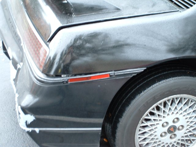

Without seeing the rest of the car it is hard to say.
From the appearances in the photo you have minor sheetmetal damage to the trunk area and a collasped right rear frame rail to which the steel bumper attaches to which needs to be either repaired or replaced depending on how it looks from the rear and from the right side. Additional pictures would help showing the damaged areas to the rest of the vehicle.
Seeing that you are in Florida I'm going to guess that it is for the most part rust free.
If the rear cradle mounting point is undamaged it should be a quick fix. If possible get the car on an alignment rack and check the alignment, that will tell you a great deal on weather the frame has any substainsial damage. Measure the distance from the front center hub to rear center hub on both sides. If they are the same the car is repairable with the same cradle but if they are different the cradle was bent as well and would require time on a frame rack which can get expensive very fast.
Was the damage limited to the tail lights and rear bumper or was the rear clip damaged as well?

The rear clip was spared. The damage was limited to below the tail lights, primarily the bumper on the passengers side. I guess that is why I am having a hard time with them telling me this car is totalled.

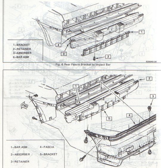

I found a few pictures in my 86 shop manual of the rear but I cant find pics of the frame rail...can someone help me out. That is the first place I want to look when I get my hands on the car. If someone can give me a rough idea from the pictures below it would help a lot.

From looking at the additional pics it appears tha the point of impact was 6 to 8 inches to the right (passenger side) of the lisc. plate opening. Is that about right?
If so your damage is basicly minor sheet metal work in the trunk area and very little damage to the frame horn. The might be some minor damage to it that can be pulled out easily. The parts required to repair has already been outlined for you to include a rear bumper skin, impact material, and a new steel bumper. Of course some easy sheetmetal work, I would use what is there and not cut anything except the existing metal bumper to pull the horn out with.
I would not total the car, but an insurance company or body shop might due to the estimated cost of NOS parts.
We all know that those parts can be found cheap either on this Forum or on e-bay. So far as that goes if you can't find the parts I'm sure that I have them here but I'm in Indiana. Fieros used to be plentiful in Florida so anything from an 85 GT to 86 & 87 SE will work as well as a trashed pace car rear bumper and support.
I would think a good body man could have the sheet metal work done in less than 12 hours and have the new parts hung and aligned in 3 hours or less. Ready for paint.

Here they are...The DAMAGE pics, taken today after they finally delivered it back to me...all was accounted for! Whew! Safe and Sound! Believe it or not it ended up at AN AUTO AUCTION!!! Damn those people! When I found that out I thought for sure it was gone!
Here's the damaged passengers side...behind the rear wheel...any thoughts guys?
This is the drivers side...not even a scratch! This is how the other side should look.
Comments appreciated.

Like I posted at the start, minor horn damage.
I would cut the bumper in half, secure the front of the car to an imoveable object use a comealong, secured to another object of the same properties of the first and pull it out.
Repair the trunk an install the new parts.

I agree. I had a chance to go out this evening before dark and have a look for myself. Its pretty ugly right now but nothing a solid weekend worth of work can't fix right up. Now the battle is moving to the damages they caused to the front end of the car and the interior pieces that were "borrowed" while it sat in the storage yard...not too much missing, but just enough to piss me off!
