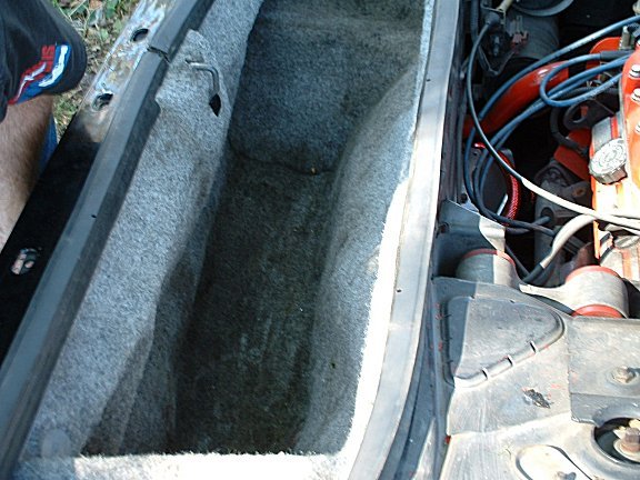

powrmajik
Posts: 786
From: Orlando, FL
Report this Post02-20-2005 08:01 AM Click Here to See the Profile for powrmajikSend a Private Message to powrmajikDirect Link to This Post

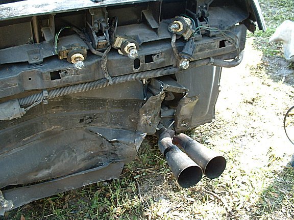

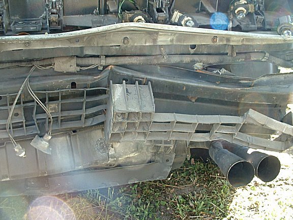

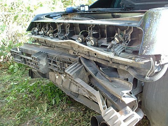

First lets take a look at the damage behind the rear bumper cover...
Bumper is toast...
Right rear portion of frame rail crummpled...AS IT SHOULD HAVE! Trunk is squashed. No damage to the exhaust! Whew!
[This message has been edited by powrmajik (edited 02-20-2005).]

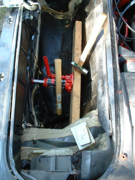

powrmajik
Posts: 786
From: Orlando, FL
Report this Post02-20-2005 08:15 AM Click Here to See the Profile for powrmajikSend a Private Message to powrmajikDirect Link to This Post
powrmajik
786 posts
Member since Feb 2003

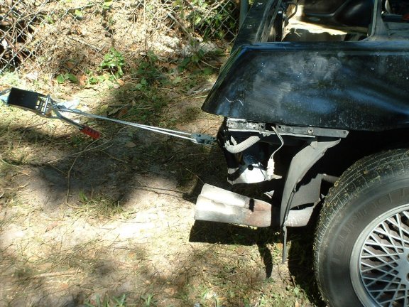

Here's where we started pulling out the "crumple zone" portion of the frame rail...Used a torch to heat the metal just enough to ease it back into shape...and for the parts of the bending that did not want to cooperate...they got the SLEDGE HAMMER!
powrmajik
Posts: 786
From: Orlando, FL
Report this Post02-20-2005 08:23 AM Click Here to See the Profile for powrmajikSend a Private Message to powrmajikDirect Link to This Post
powrmajik
786 posts

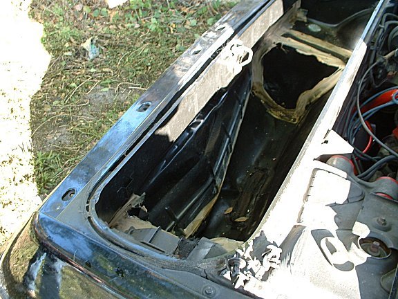

Here's the damage to the trunk area....
A little wood, a 2-ton bottle jack, a couple hammers...
and the final product! Good as new! I need to clean the carpet, but hey, that was the least of my worries! It looks like there is evident damage seen even though the carpet is in place...not true. The carpet was bent during the impact and is still so. I figure once it is cleaned it will relax and will take its normal shape again.

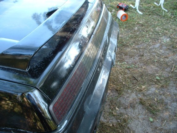

powrmajik
Posts: 786
From: Orlando, FL
Report this Post02-20-2005 08:33 AM Click Here to See the Profile for powrmajikSend a Private Message to powrmajikDirect Link to This Post
powrmajik
786 posts
My pictures of the installed bumper and straightened frame rail did not come out...very blurry, sorry guys. But Kento and I did replace the bumper with an excellent donor which received very minor surface rust treatment and a fresh coat of flat black paint. The frame rail was also treated to a coat of the black paint before we reinstalled everything. All damaged parts were replaced from the donor vehicle so everything went back on nice and straight. Now I just need that paint job! Maybe a new rear fascia....anyone got one laying around?
