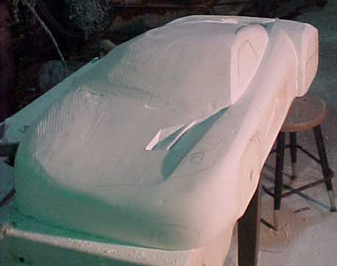

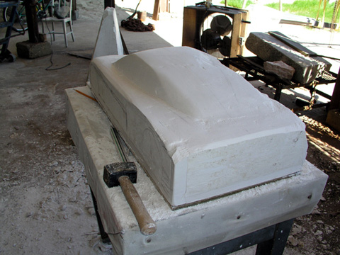

Build date 3-16-04: Day 3

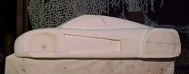

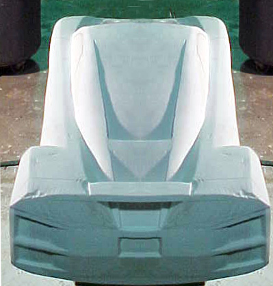

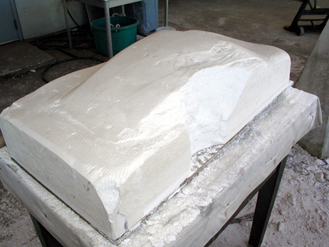

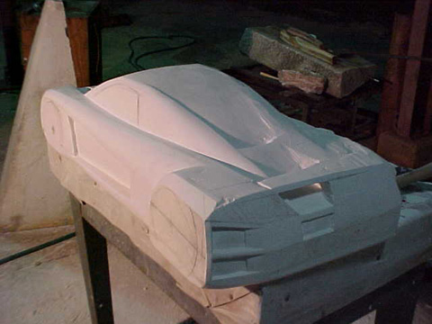

Starting off with a 1/5 scale plaster model of the ME Four-Twelve. To start, I simply gathered the measurements for the real car, and made a 1/5 scale wooden box to fit it. The box to pour the plaster in was 36" L x 16" W x 9" H. For anybody calculating the plaster, it took about 150 pounds, so about 20-25 gallons. (This thing was a beast to move since it's still wet. Probably weighed in at around 250 pounds.)
I let the plaster block dry down a little bit over night to make it easier for the chisel to grip into it and get a more predictable chiseling pattern. I drew some rough sketches on the block of plaster itself and just slowly knocked away the plaster until I got a rough shape and then used a (sharp) wood rasp to smooth things out, and a smaller (dull) wood rasp to really smooth out localized areas. To get it to a halfway presentable state, I sanded it down with 150 grit foam-backed sandpaper. (Paper sandpaper just soaks up the moisture too quickly at this point in the game and lasts the whole of about....5 minutes, maybe...?)
Anyway, here's where I'm at today. Lemme know what you think so far (and if you want me to continue this thread or not):
(On the one above, you can see where I made a boo-boo. Always follow your plans...
I'll post some more pictures as things progress. If anybody has any questions, feel free to ask.
Oh yeah, just in case people thing this thing will never work, you'd be surprised at how closely the body fits the Fiero's. Well, except for the 16.6" wheelbase extension, which I haven't quite worked out yet. Yeah.....

Wouldn't it have been easier to use clay? How are you going to fix the boo-boo?
Patrick Horne
Posts: 144
From: Ruston, LA, USA
Registered: Nov 2001
Report this Post03-16-2004 09:32 PM Click Here to See the Profile for Patrick HorneSend a Private Message to Patrick HorneDirect Link to This Post
Could've used clay I guess, but the total time I've spent so far (something like 6 or 7 hours) to have gotten as far as I have, plaster was just the better route.
Oh, not to mention that clay has a really bad tendancy to shrink after it dries (like 11/13 it's original size) unless you spend a lot on really good plasticine clay or urethane clay, but the school's paying my costs, so... AND, clay wouldn't have worked well for transposing back onto the computer to do final tweaking. So I had my reasons for going plaster.
To fix the boo-boo: I only need half of the actual block (which I didn't realize until later), but it just gives me a little bit more room for error. If I need to work out some details on the door inlet, then i can do it on the boo-boo'd side instead of messing up the nice one. I'll cut the block in half when I'm done with it (to be covered later on) in order to scan it in 3D and duplicate the one "good" side.

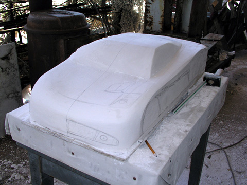

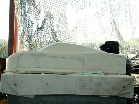

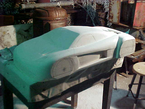

Lol, unfortunatly I have no choice on the deadlines. I've got to have this thing done before I graduate, so I'm going to be on a tight schedule from here on out. Fortunately, I've got Mondays, Wednesdays, and Fridays (and weekends) to do nothing BUT work on this thing, so I'm hoping that the deadlines are semi-reasonable.

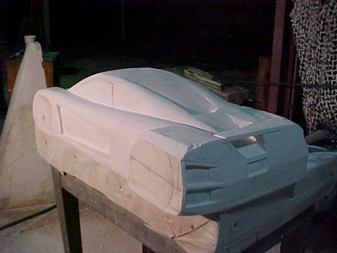

I did work some more on it today (about 9 hours worth) and got a good bit more done. The only section that I have left to do is the rear end and the top/glass.
Anybody who's looked at the real Four-twelve pictures: can anybody tell if there's sail windows on the sides (over the trunk area) or is that just an indentation? It's pretty hard to tell in the pictures that I'm working from. If it's glass, then that just means it's one more piece of glass that's going to have to be custom built. Fun...
I'll try to post some pictures once the rear end gets finished. Should be finished with the model by Friday, so I'll post some more pictures on Friday night of the completed model.

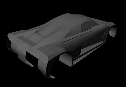

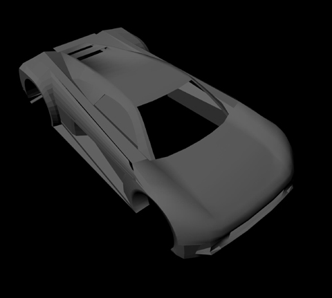

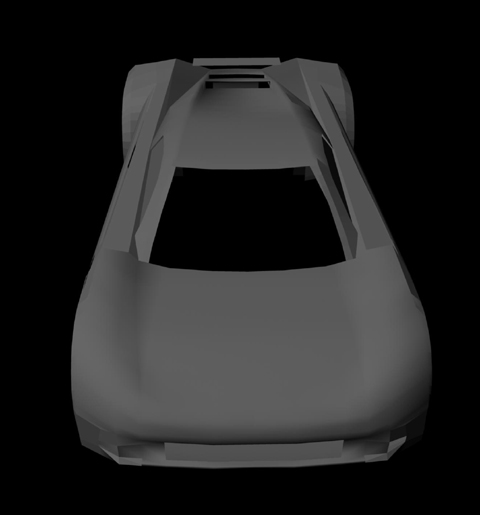

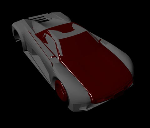

I finally got the plaster model done down to a point that I can now scan it and put it in 3D on the computer. Since I've got the original car's dimensions, I'm now able to easily plot out the car to a fairly close degree. This will in turn allow me to make a wooden fullscale jig that I'll be assembling the body on.
The plaster worked well, save for a few soft spots that didn't /quite/ make it past the powder stage. The pleasures of messing with plaster, especially this much of it. Like I said earlier, I only needed half of the body, because once it's in the computer, I can just mirror it.
Unfortunatly, this will be the last progress report until next week sometime. I had to order a special 141" blade for the bandsaw that I'm using, so I've got to wait until it comes in to post anything new. Hopefully, I'll have my better digital camera with me next time as well and therefore better pictures to post.
(Duplicated the side in Photoshop, just for fun, ya know.... )
Again, if anybody has any questions or comments, post away...

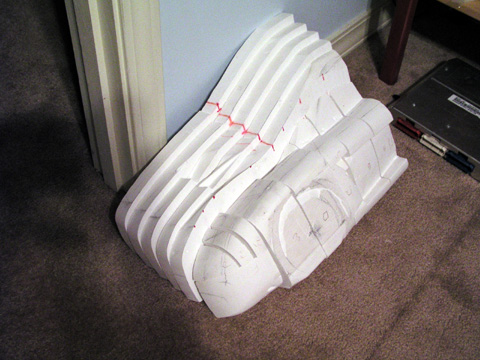

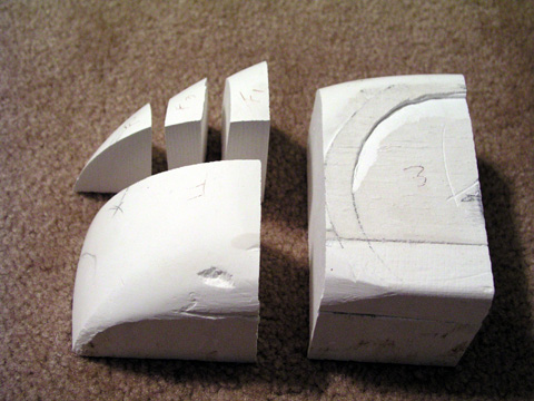

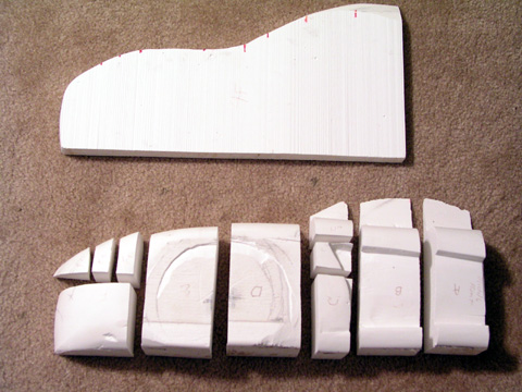

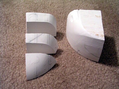

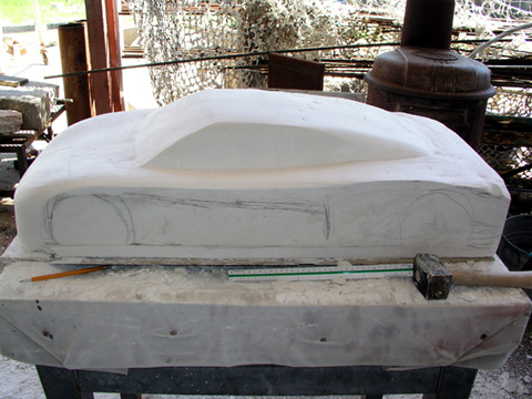

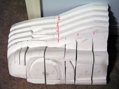

Well, after almost two and a half weeks of waiting on somebody else, I've finally sliced up the plaster model into pieces that are small enough to scan.
I haven't scanned them yet since I've got some other stuff going on today and tonight that I'll need to take care of before I delve back into this thing, but I will take some shots of the completed slices before I scan them, just so everyone can get an idea of what I'm trying to do.
And irony strikes at the worst time. I found out that our 3D scanning computer (which has been down for the last month or so) apparently was fixed earlier last week when the service rep came and looked at it...AFTER I SLICED THE CAR UP! I hate it when crap like this happens...
Anyways, I'll post when I get a chance, but won't be able to work on the 3D modeling part of it until this weekend. Keep checking back.
Patrick Horne
Patrick Horne
Posts: 144
Report this Post04-11-2004 10:07 PM Click Here to See the Profile for Patrick HorneSend a Private Message to Patrick HorneDirect Link to This Post

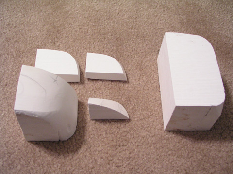

Okay, things didn't work out quite the way I had hoped with the plaster model. It causes a set back, but nothing /too/ serious.
Info on the cutting up process:
For those who are interested in doing something like this in another media first (like clay or plaster) for their model, here's what I did to cut up the car.
Figure out WHERE you want to cut. This is probably THE second most important step thus far (getting the dimensions of the car correct would be the 1st...which was my mistake to a degree). Since mine was a 1/5th scale, I cut it down the middle, so I'm only dealing with an 8" slab of plaster, which dramatically cuts the weight down for handling. I marked out 1" lines on the plaster itself and scribed them from the front to the back of the model. Leaves you with 8 individual sections, each with a pretty good bit of information on each. Number each section with a noticable mark (like 1F to 8F for slices one through eight of the Front half). This is important later on because this is going to be one big 3D puzzle, only there's no instruction book if you decide to stop the project for a little while. Document EVERYTHING.
I left the outer three sections as one piece. The reason for this was to cut up the outer 3" /towards/ what used to be the middle/interior of the car. (Assuming you're using the driver's side for the model, you'll be cutting vertically from the driver's side towards the passenger side of the car.) All those little details like where a wheel well starts and stops are good places to make cuts as it will be a good reference later on when you use the slices for the model. I cut this 3" layer into 6 pieces for the front and 5 pieces for the back.
Now, if you've got some details on the side as I did on the side air ducts, take ONLY the vertical sections with the most information on them and lay them down on their interior side and cut once again from the front of the car to the back of the car (working with the individual pieces, of course...) Only cut in areas that offer good refrence points: on mine I chose the top and bottom of the air duct as cutting points.
Once you've got this all cut up. Go back and make /sure/ that everything is documented really well. I can't stress this enough!
(cont'd)
Patrick Horne
Patrick Horne
Posts: 144
Report this Post04-11-2004 11:07 PM Click Here to See the Profile for Patrick HorneSend a Private Message to Patrick HorneDirect Link to This Post
Now for the scanner.
My mistake largely lied in the problem that the pieces I cut were too large for the scanner, so getting any kind of an accurate scan is kinda tough, so many of my proportions were off after the scan. (I would've re cut the pieces, but if you've ever ran plaster through a bandsaw blade, you'll know it tends to dull and get rusty almost over night, and it's been sitting over the weekend sooo.....)
Take the pieces and lay them on the scanner (flatbed scanner is what I used) but only do one section at a time. Scan the image and save it as a name that'll give you a pretty good idea as to what part it is you actually scanned (hrmm, could this mean documenting things again?? I do believe so...! :dizzy ). The large flat pieces from the interior are the easiest and should be done first.
The outer pieces are a bit more difficult. Okay, a lot more difficult...
The outer pieces need to be scanned one side at a time, but it actually will work out better for you if you scan one side span with its individual pieces in one scan rather than two or three scans for /each/ individual piece. The trick to this part is that you're basically doing /at LEAST/ two scans per vertical span and at /least/ three scans for the vertical spans that are cut again horizontally. (Go ahead, read all that again, because it probably didn't make sense the first time through... )
Start in the front and work your way to the back. Another good hint would be to lay out the outer pieces on the span closest to it in the same way as it was on the model, and mark where the blade made a space on the interior span, that way you'll have a refrence point when you work with it in 3D.
I'll post some pictures on the next post to clear things up a bit.

Okay, now for those that think more visually than verbally: the pictures to explain what in the heck I'm talking about!
Okay, here's two shots of the model after it got cut up into the interior pieces (cut from front to back) and the exterior pieces (cut vertically towards the inside of the car):
A layed out section showing the exterior pieces and the closest interior span:
The front two spans:
Set up for the vertical interior scan of the front two spans:
Scan for the horizontal interior scan of the front span:
As always if anybody has any questions about any of this, please feel free to shoot me an email at phorne_tca@yahoo.com
I'll try to help you out as much as possible.

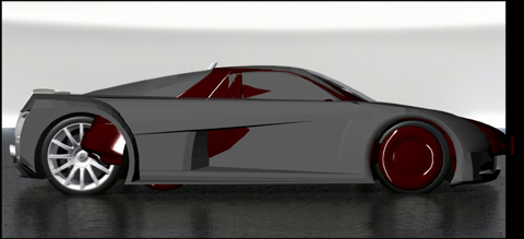

Okay, it's been a couple of weeks and I have to say that I haven't done a whole lot with the car. I've modelled it out some on the computer but it's been kind of a busy couple of weeks, so I'll just post what I've got so far.
This next one is kind of a neat image to me. It shows just how closely the original has been followed.
As you can see, the back hasn't been worked on much yet. Same goes for the front
Anyway, that's what I've got. A lot of the modelling did end up coming from the plaster model, so all was not lost. The scanned model just had to be shifted and scaled around a little bit to get it to match up correctly.
As always comments and questions are welcomed.

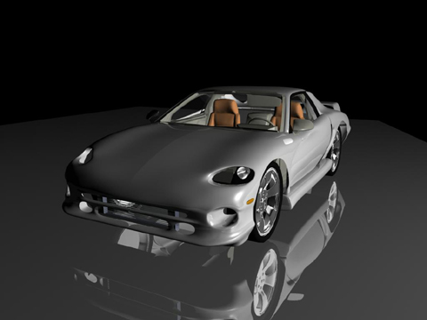

Just thought I'd post these images too. These are two pictures with the Fiero (in Red, duh) underneath the body and scaled to it's correct size with the Chrysler body on top of it. Check out how closely it fits...

Ouch Well I think it might look better shorter!

I keep thinking the same thing about it being shorter. That 16" stretch is going to kill me I think. I'm still working on going as close to the real thing as possible though. It's proving tough, since I don't really have any reliable measurements other than length, width, and height.
I started thinking a few days ago about the C5 vettes and just how big they are. Ironically, the Four-Twelve's wheelbase and the vette's wheel base are pretty close. I just wouldn't want to get a C5 vette only to cut it up.

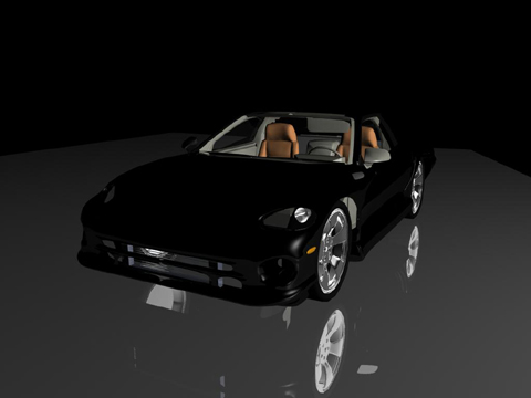

This is pretty much off topic, but since these aren't posted anywhere and RCR got me thinking about some of my older projects, I figured I'd post these images from the last one that I started working on. I quit, because it looked too much like a Viper, and too much like, well, crap.
Anyways, it'll at least give you all an idea of where I'm heading with this project. I'm not very good at skipping little details. Hopefully the ME Four-Twelve is going to look somewhat like this once it gets done, only, not like crap.
Side View, looking like a gimpy Viper and in red:
Front Quarter View, looks better, but mostly due to the silver color:
Same View, but in black, cause black's just cool.
Anyway, just thought I'd give you something to look over, RCR. You should seriously consider building the car /YOU/ like!
