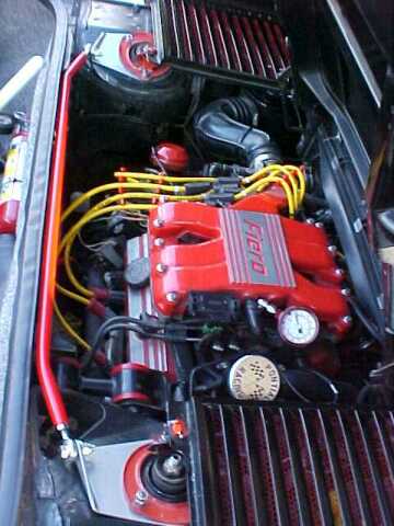

The reason I ask is bcz I got my new Darrell Morse strut bar and am ready to install it. His instructions tell me how to preload the bar... So when I go to follow them, it feels like I am actually PULLING the towers together. This is the opposite of everything I have been taught or read. My logic tells me that I want to PUSH outwards on the towers.
So now I am overthinking the problem. Maybe bcz it is since that Fiero is a mid-engine layout... I want to pull in the towers instead of push out... Maybe Darrell knows something I don't... Maybe I am misunderstanding his instructions... Maybe, maybe, maybe.
So since we're all experts... lemme read some replies. Push 'em out -or- Pull 'em in?
PS: I know there are going to be the ubiquitous replies of "don't need 'em," or "they do nothing," or 'the area is strong enough anyway" and that is all well and fine. I think it looks exceptional and helps add yet another custom touch, though I have a friend that AutoX's frequently and has lowered his times after the strut bar. Regardless, if it does nothing but inspire more driver confidence or look pretty... I want to know the proper application of a trut tower brace on a mid-engined vehicle.
Since I am installing it anyway, I want to do it right.

The idea is to "Pre-Load" the suspension by pulling them slightly together 1st. This removes (most of) the initial movement of the struts... it should help further solidify the suspension.
...does that make sense?

I think the correct way would to be to push outwards also.

It doesn't matter. You're not using enough force to actually move the strut towers, just applying some preload on them to take out the slack. Since the STB is a 2 force member, it doesn't matter if it's in 10lbs of tension or 10lbs of compression, the end result is the same.

Yeah, the rear strut towers are so stiff already that I doubt you could even move them with the brace.

Pulling them in would give you more negative camber, a good thing for cornering...especially under acceleration.

The strut tower brace doesn't necessarily hold the tower itself in place, but rather the strut tops (which have a notable amount of play in them when not tied to each other). I believe pre-loading them either way would reduce their additional movement within their bolt-holes.
BTW: For those who question the actual effectiveness of the part - Darrell Morse offers a performance guarantee... if you don't feel it made a difference, and you no longer want the part - you can return it for a refund. I don't believe anyone has ever sent one back

I have the WEST COAST FIEROS strut tower brace......Look at theirs also.....It is much heavier duty although DARRELL'S is a great one also....

Besides the rear offset brace from WCF there is a top offset for the 88's...the one I have

Any installed pics? Does it interfere with access to the oil fill or spark plugs at all? I see WCF says it won't work on a 4 cylinder. I believe Darrell's works on all Fieros and doesn't interfere with any access.
The WCF piece looks quite beefy, though.

I have Darrell's installed on my car....
Can someone explain the purpose of the spherical bearings at the ends of the strut?
The brace "floats" and "moves " I would have thought that it would be stiff?

The one I have is a different off set than the one shown here......but the picture here does not do justice to the thick crossbar ......this thing is massive.....I have not had time to install it yet........the bolts that come up thru the strut from underneath have to be taken out an longer ones put in their place because the mounting plates are so thick you can not get the bolts back on to hold the mounting plates in place......although it is not as unrestrictive as Darrell's, it still is not in the way of any access you may need to wires and oil fill etc. Hope this helps...

Yes, the bar "float" and "moves." What the spherical bearings do is prevent any torque from being transmitted across the bar because it can pivot at the end. The only forces that are transmitted are tension and compression. The purpose of the bar is to tie the tops of the strut towers together. You're not trying to use the STB as a sway bar. It should never have any bending force applied to it. It is designed to keep the distance between the tops of the strut towers fixed.
I hope this helps. You need a basic understanding of engineering struts, or 2 force members. That's about the best explanation I can give without trying to go into a college level engineering statics class.

Sorry guys but the brace that goes along the firewall is eye candy only.
Here is a sketch showing why it doesn't do anything but look pretty.
DieselFiero
[This message has been edited by Michelhaugh (edited 05-15-2004).]

Nothing wrong with the pretty factor, I kinda like the way they add color to the engine bay.
DieselFiero
Personally I can't think of any situations where axial rotation of the strut could be incurred, and the mounting w/ the three top bolts would prevent such rotation before it even reached the STB. The brace serves to keep the top mounts a given distance apart, maintaining the geometry in relation to the the hard mounted pivots distributed throughout the suspension below.
I'm assuming the above drawing is a plan view.
[This message has been edited by gt88norm (edited 05-16-2004).]
