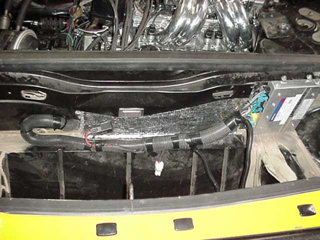

Archie,
What do you use to paint the engine compartment?
And what do you put on the firewall?
Thanks! Looks great!

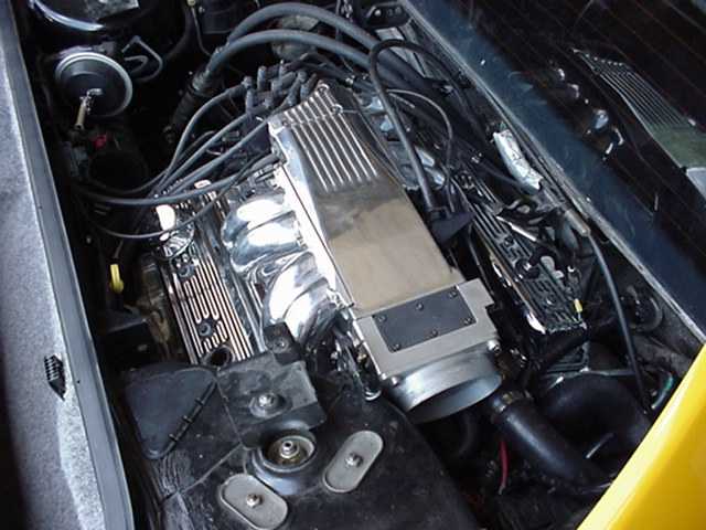

Originally posted by rgeeinc:
About the larger throttle body, I think California Kid is right on, 58mm is going to be a little too big for that cam and heads.
Bob
Hmm, How about my 2.3L Quad-4 with a 57mm throttle body?
TPI throttle body has TWO butterflies

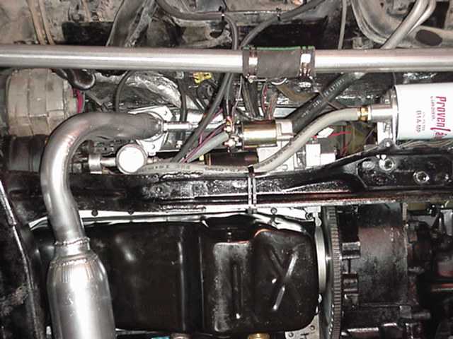

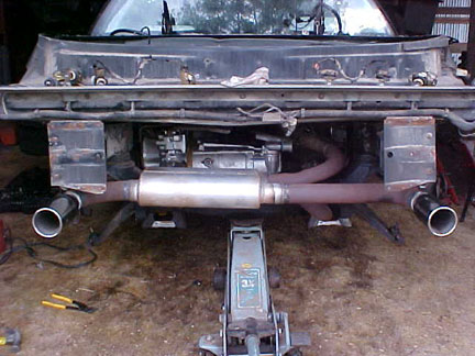

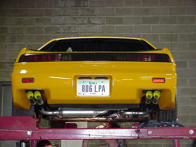

Originally posted by Parde_GT:
Archie, I'm looking at doing a zz4 build sometime soon (8-15mos.)and have a few ?'s if you would.
I take it you are using the zz4 stock cam - if so then I assume it produces enough vacuum to run with the tpi? A fellow worker thought the zz4 stock cam would not. Also, how much purposed gain in hp/tq does the tpi add?
Are you using all hard mounts for the assembly - from the pictures it looks like at least two are. What is the hinged mount's function?
How do you guys go about painting the engine bay? Do you remove everything and then paint? I ask as it looks very nice and only the walls are painted - nothing is painted that shouldn't be.
Finally, could you include some exhaust pics on how you did this particular build?
Thanks and Awesome work!
Welcome to the Forum Parde_GT. I'm very happy that you decided to use your 1st post to ask some good questions about the SBC swaps.
The ZZ4 does produce enough vacuum to run the TPI just fine. I've done about 15 TPI ZZ engines into Fieros and they do fine. I will try to remember to post the actual vacuum readings on this car when we button it all up. I'm sure there is a Torque gain with TPI but I've never seen any documented GM numbers.
Yes, they are all hard mounts (the hinged looking one is a hard mount). I've been using hard mounts on almost all my inhouse built cars for about 7 years without any problems. There are several "experts" here who will argue solid mounts are no good yadda, yadda, yadda. No matter what you tell them, you can't convince them otherwise. So I just silently put the solid mounts on and let them do all the talking.
Yes we remove everything in the engine compartment and clean and paint. We use aluminized insulation glued to the front firewall. This exhaust system is pretty typical of the exhaust that we to customers in the kits. The car is on the lift, so it will take several pics to show the exhaust.
Archie

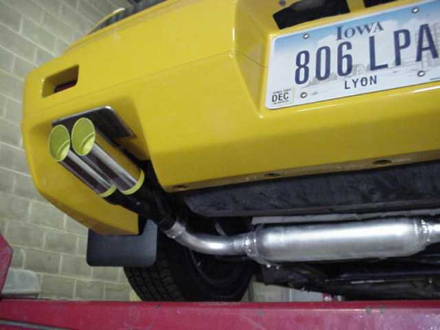

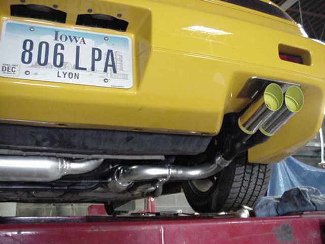

Looking toward the rear of the car....

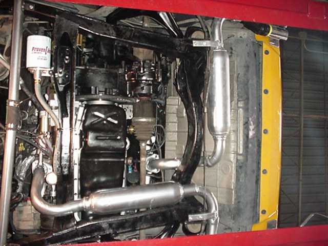

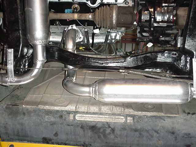

Looking straight up at the front exhaust, the front of the car is to the top of this picture....(that's one of our waterpipes running right to left)
Straight up view of the rear side....
The rest of the exhaust....
Hope this helps

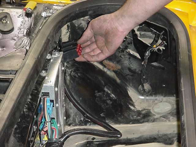

So, what are you using for an ECM on the ZZ4 TPI? A stock 350 TPI ECM, custom chip, or aftermarket ECM (a la Accel DFI or Holley Commander 950)?

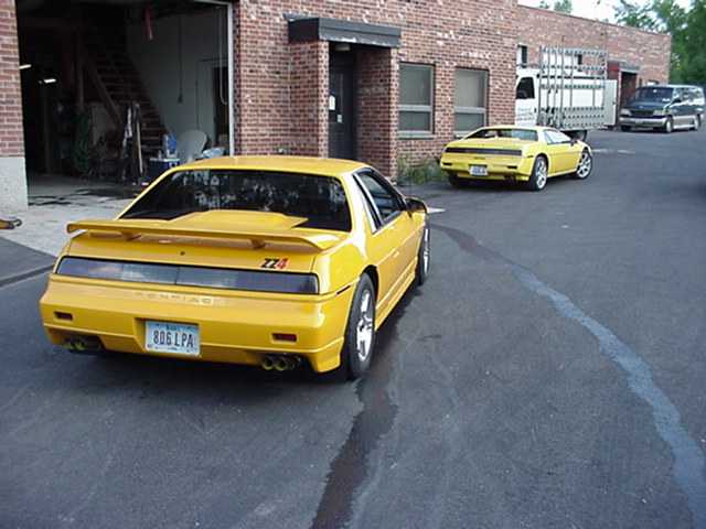

Whats up with the driver side back tire? There something behind it or is there a racing slick on there?

What diameter collector are the manifolds that come with your master kit? 2inch, 2.5 inch or something else?
Matt
I think it's the inner fender liner, or a mud flap, or something...

mmmm PaceSetter tips!
its all about the small things!
Is it just me, or have Trumpet tips fallen off the face of the earth and only avail off another fiero or the fiero store....
Good work Archie...
The aluminized "insulation" is that "dynamat" or just tar paper with tin foil on it?

Report this Post06-26-2003 06:12 AM Click Here to See the Profile for tesmith66Send a Private Message to tesmith66Direct Link to This Post
Rodney sells the only reproduction tips worth considering. 100% stainless steel- identical to the original.
I'll be running stock megaphone tips on my V8 (if I ever get the time to finish it!)

Well, since there's so little room for exhaust on a V8, the Pace Setter tips give a bit more sound control. With just cats, or glasspacks, and no resonators, it's gonna be LOUD! Heck, it's not gonna be quiet even with the Pace Setter tips.
Now, if you could make OEM looking megaphone tips, with resonators built in, that would be slick.

What mufflers do you use or have found that sound the best? Is it really loud when the throttle is opened up?
Thanks again.

Archie - lookin' good... wondering how well it drives now
Also, related-but-not... what muffler do you use when you remove the trunk for a "quiet" install?
well, maybe archie can chime in here, but to me, they look like Car Chemistry Tube mufflers. Rob, you know what they are, you just dont recognize them. I remember a post a long time ago where Joe Torma installed Car Chemistry Collector Inserts into his car. The CC tube mufflers are the same thing, but have the inserts installed. You can find them in summit now. You seem to know every post ever made, so I hope you know what I'm talking about and can find it. It was a discussion about your exhaust setup I believe.
Hope that helps.
Hope that helps.
Joe- thanks, I do kind of recognize the CC mufflers. Here's the thread you were mentioning (About my exhaust & Joe's collector inserts) https://www.fiero.nl/forum/Archives/Archive-000001/HTML/20020208-2-013191.html
I'm actually wondering about some of the other installations he's done (there was one listed on Archie's website that mentioned the owner wanting the exhaust to be as quiet if not quieter than stock).
I noticed that this car appears to retain all of it's trunk, whereas cars like Kaz's and the Stinger lose the bottom section for a more-complex exhaust. What's the difference? The use of Cat's or possibly the use of a larger muffler? - just curious
As a different example yet, I know that 80's Boy (Brian) used a larger flowmaster muffler positioned in the area below the cut-off trunk:
[This message has been edited by MinnGreenGT (edited 06-27-2003).]

could also use Spiral flow mufflers or glasspacks. a friend of mine has spiral flows and his 82 361 supercharged Camaro Z28 and it sounds awsome! Another friend has a 75 Camaro with a built 355 with glasspacks that sounds even meaner
--Adam--

Funny you guys make mention of the CC Inserts.
I have looked into them as a possible solution for my car. I am running Dual Dynomax Dynaflow cats right into 3" PaceSetter's resonator tips.
It sounds good. Nice strong rumble, but I want to quiet it down a little.
I thought about getting the three disk CC inserts that are supposed to muffle the sound quite a bit.
But I never found anyone with first hand experience as to say how good they are. http://www.carchemistry.com/ccinserts.html
Maybe I get a set and see how it goes.

Originally posted by Archie:
Archie...Is that a direct bolt up to the sub frame..?? Not mounts..??
What has been you're experiences with this method vs. Polly mounts..?

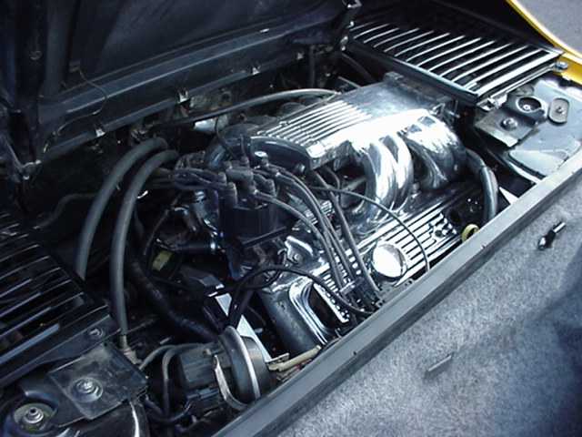

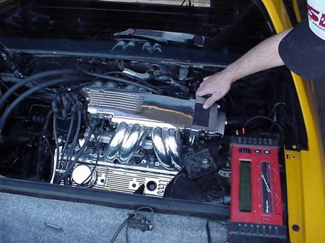

Well, It's the weekend and I've once again fallen behind on documenting this swap.
As for the car, it's gone home already. The customer came here on Friday and spent most of the day doing the test driving for us.
So that car was gone Friday and we've already (on Saturday) started the next V-8 swap to an '88 GT, we will also be chopping the top on that car. It's a 383 stroker engine with 470+ HP & Torque & will be using the Street & Performance Super-Ram injection system.
But getting back to this car. My hands have been quite sore lately and I haven't felt much like typing. Teyt are not a lot better today but I do need to finish this up for everyone.

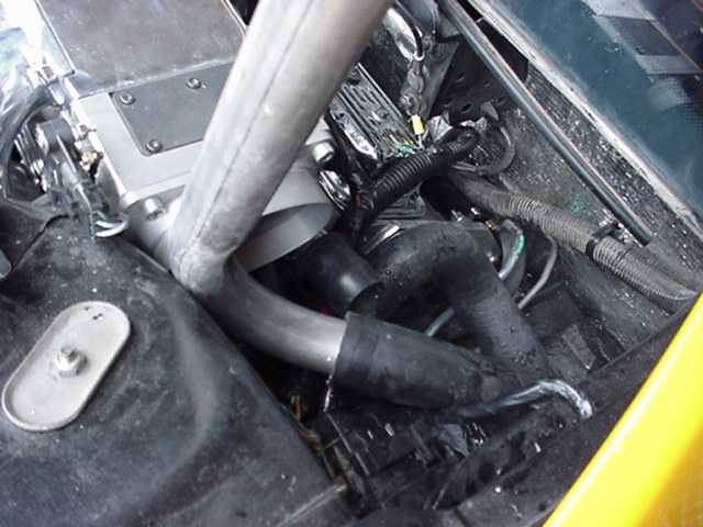

While we were underneath the car we installed the cooling pipes and hoses. We also hooked up the wires on everything.

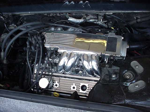

Then we returned to the top of the engine and did final assy. work.
We mounted the ECM in the trunk and routed the S&P wire harness to it.
more to come.......

Time to test run the engine and start sorting it out.
Gotta jack up the back end of the car and fill the cooling system as pper the video instructions.
Hook up the scanner and see what we have...
Watching water temp, oil pressure & everything else...... no need to rush here.... getting it right is most important.
This one wouldn't start initially. Had spark to the plugs, Noid light showed that the injectors were firing. Fuel pressure gage showed that it would pump up to required pressure just fine but wouldn't hold the pressure. We had installed a GN fuel pump when we were under the car. Took out the tank and checked our work, fixed the error and put it back together.
Back to testing again.....
After testing flogging and testing some more it's ready to leave for home.......

Now I'll try to answer your questions.
Archie

Very, very nice car. I like the shots with it next to the Stinger.
