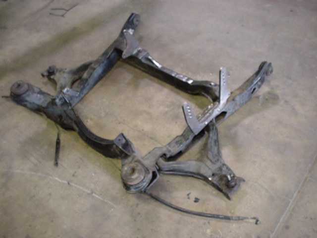

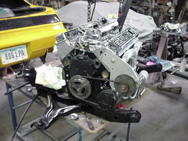

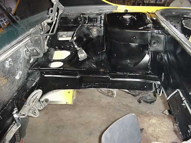

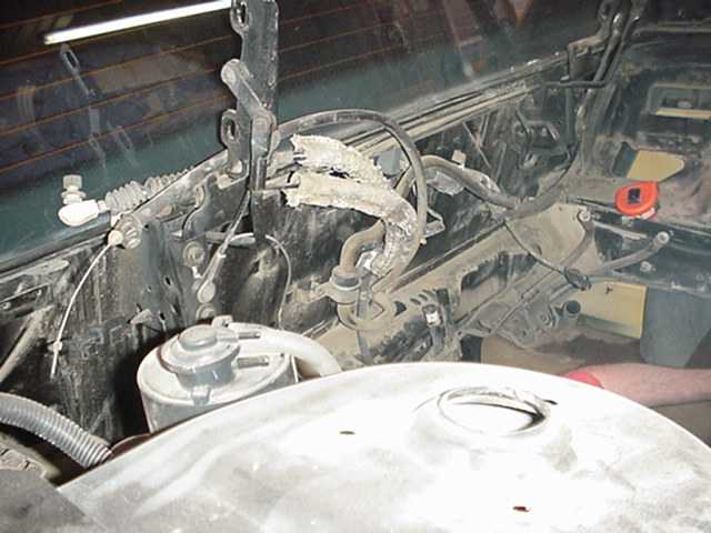

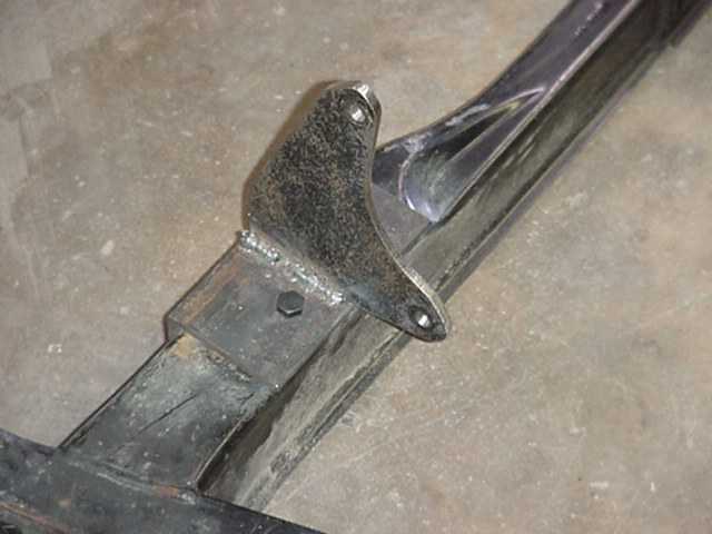

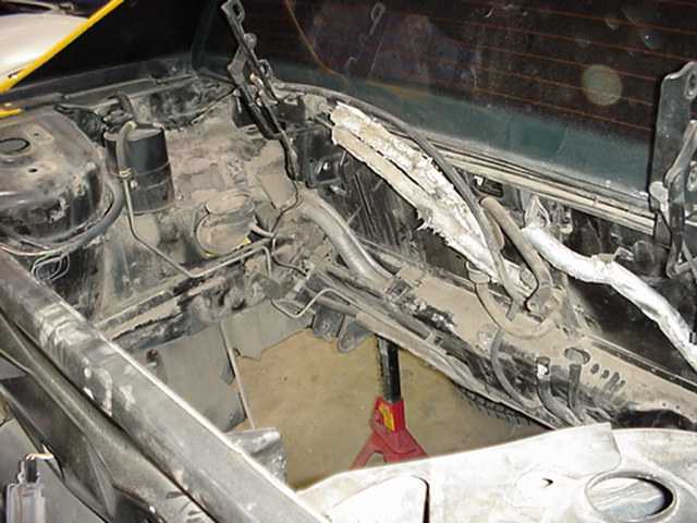

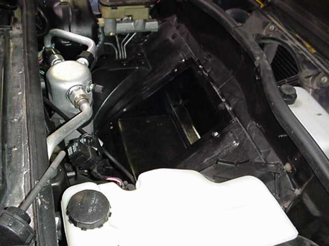

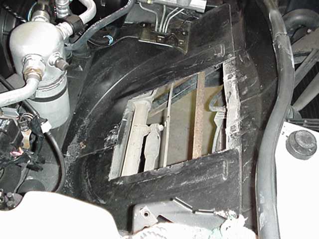

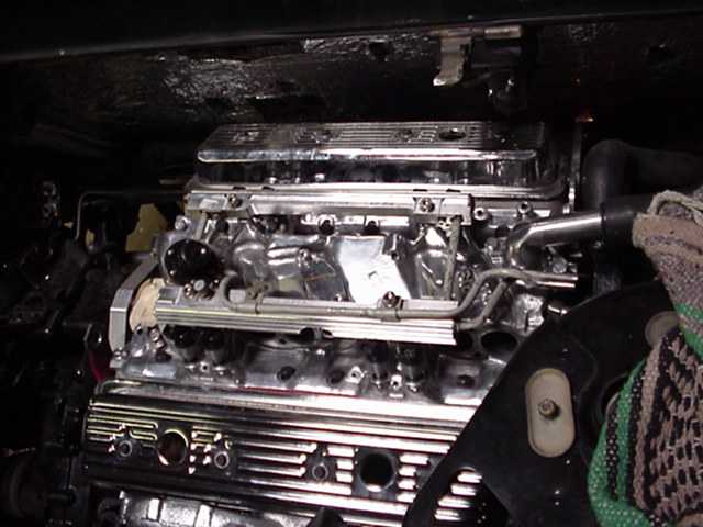

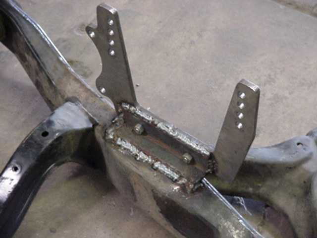

Tuesday..... remove a few things from the engine compartment that are not needed and get it ready for the 11st. trial fitting of the new engine/trans assy.

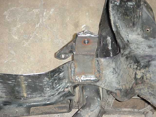

Here it is, the trial fit is to mock things up and make sure all your ideas are going to fit properly. On this swap we are using an aftermarket TPI system called the "Big Mouth" we need to mock it up to make sure it'll fit the same as a normal TPI system. Also check for clearance all around the engine. Check for right side hinge box clearance to the forward valve cover. Make sure alternator has enough "swing to tighten the belt before the alternator contacts the forward crossmember.
After the trial fit and making any adjustments it's time to remove the engine/trans from cradle & do welding, cleaning & painting of the cradle.
more to come.......

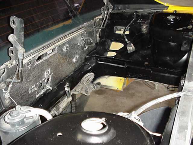

Archie

Report this Post06-21-2003 10:01 PM Click Here to See the Profile for ArchieClick Here to visit Archie's HomePageSend a Private Message to ArchieDirect Link to This Post
Archie
9436 posts
Member since Dec 1999

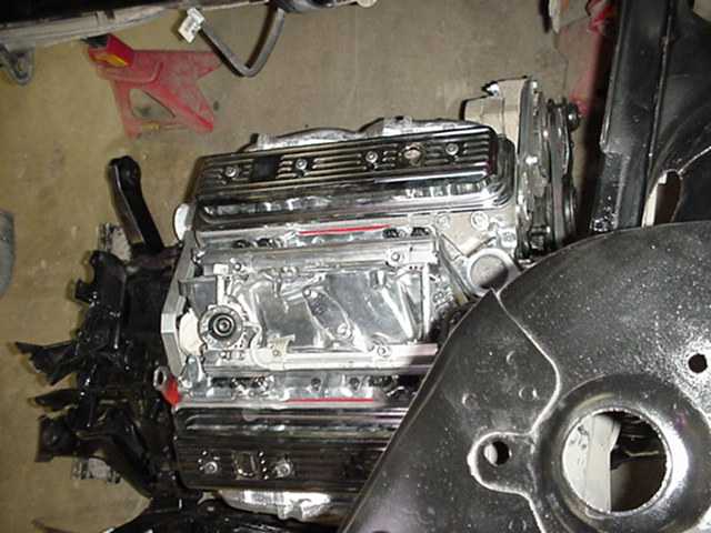

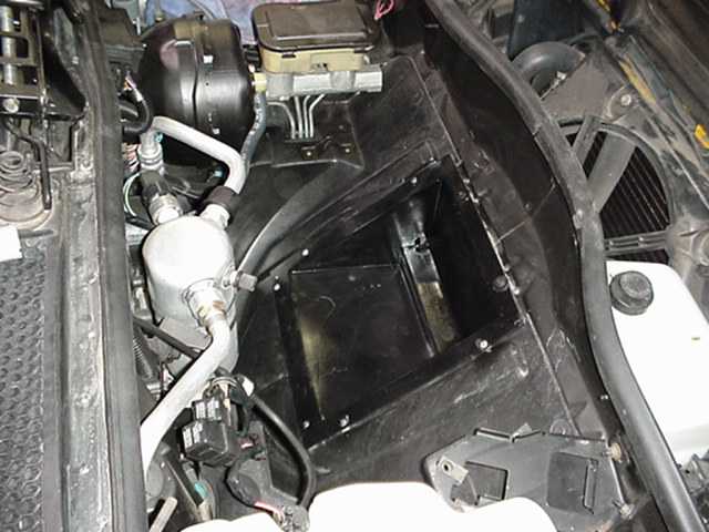

Wednesday

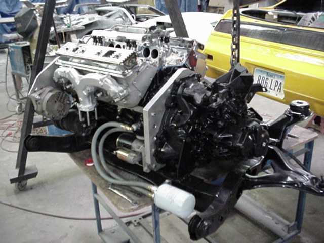

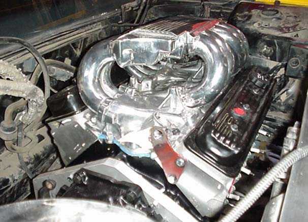

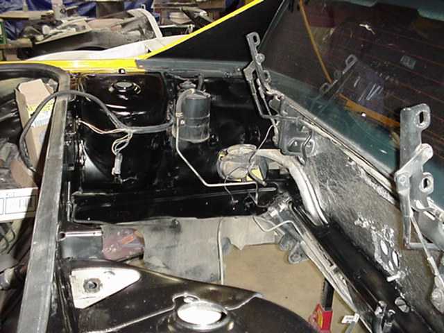

After painting the engine cradle it's time to final assemble the engine onto the cradle. We can walk around this assembly and install componets like the chrome valve covers etc.
Then we have to clean and paint the engine compartment. Make it look good now so the engine will have a nice home.

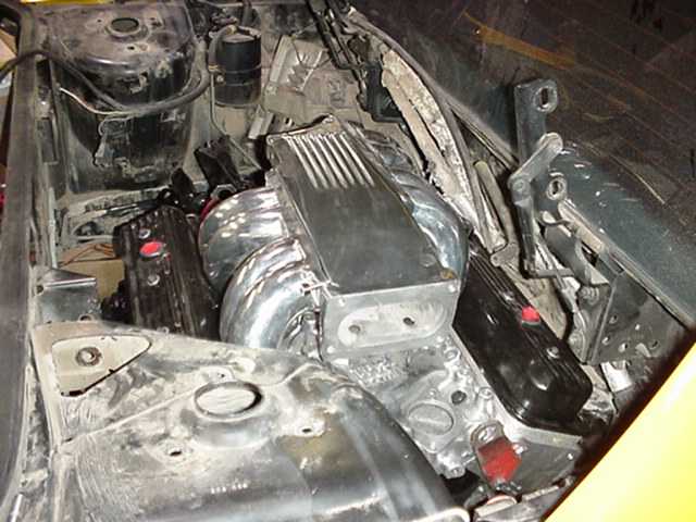

Report this Post06-21-2003 10:14 PM Click Here to See the Profile for ArchieClick Here to visit Archie's HomePageSend a Private Message to ArchieDirect Link to This Post
Archie
9436 posts

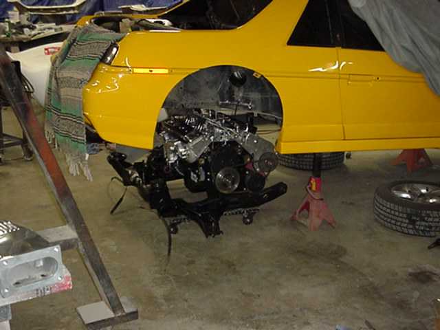

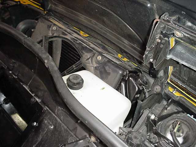

Thursday

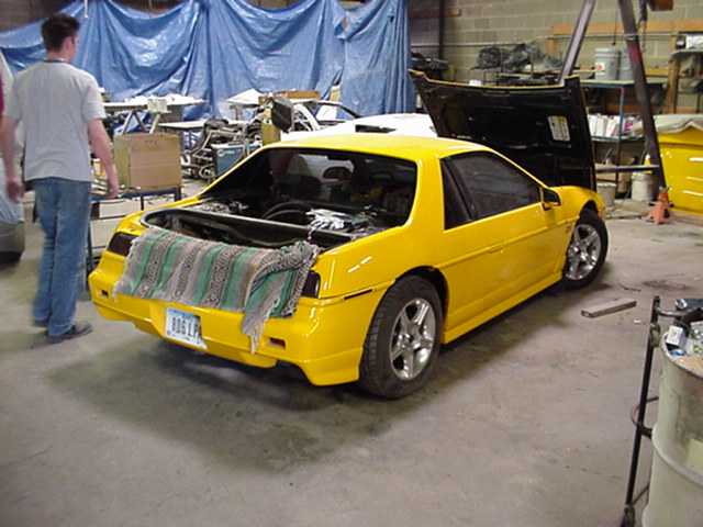

Final install the engine back into the car.
Reinstall the suspension and start putting everything else back together.
Hook up shift cables after installing the 5 speed shifter and cables. Remount slave cylinder. Start putting the intake system together.
We spend the rest of the day Thursday and most of Friday. Installing the wire harness, cooling system, GN fuel pump, customer supplied braided brake lines, bled brakes, bled clutch, install wheels, .......

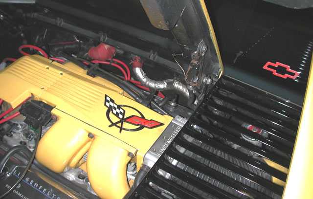

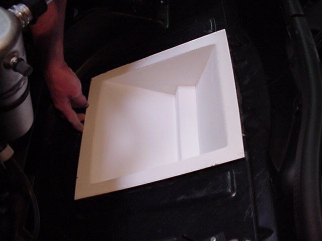

Cut fit and install our new fiberglass battery tray.
And install the 4 core radiator, it's a direct replacenment for the stock Fiero radiator and uses all the original maounting hardware & hoses.
Set it on the floor to move it over to the lift so we can install the exhaust system and get it ready to fire up.
We should be booting it up on Monday.
Thanks for giving me the time to get to where I can put all this up to this thread.

Looking great Archie- Can't wait to see it finished and driving! Did you run into any clearance issues with the "Big Mouth" TPI?
Hope you're feeling better soon.

who makes the "Big Mouth" intake?
Mach10
Posts: 7375
Total ratings: 165
Report this Post06-23-2003 05:56 PM Click Here to See the Profile for Mach10Send a Private Message to Mach10Direct Link to This Post
Is it just me, or does the intake look MUCH smaller now?
Must be the angle?
MinnGreenGT
Posts: 11545
From: Lakeville, MN 55044
Total ratings: 274
Report this Post06-23-2003 06:09 PM Click Here to See the Profile for MinnGreenGTClick Here to visit MinnGreenGT's HomePageSend a Private Message to MinnGreenGTDirect Link to This Post
http://www.tpis.com/ (TPI Tuner shop about 20 minutes from my house... talked to them on Saturday at the Back to the 50s show in St.Paul )
Must be the angle?
The "Test Fit" pics show the intake plenum itself... the "installation" pics show the intake manifold and fuel rails, but not the intake plenum. Did that help?
Mach10
Posts: 7375
Total ratings: 165
Report this Post06-23-2003 06:22 PM Click Here to See the Profile for Mach10Send a Private Message to Mach10Direct Link to This Post
AAaaahh... So it has an upper and lower... Gotcha!

Report this Post06-23-2003 06:44 PM Click Here to See the Profile for California KidSend a Private Message to California KidDirect Link to This Post
Your kit is different than mine, but you may have to modify the hinge and Lid beam to get clearance. Use some real good expoxy, my conversion is 10 years old, but you can see the stress cracks where the modifications were made (getting it all redone the end of the month).
I always look for 'Easter Eggs' in your pictures, and I can't come up with any this time around.
But I was wondering how much clearance you have between your cradle and this radius arm?
I hope you smile about that and that your doctor perscribed something good... I have osteo, and sometimes it takes trying out 2 or 3 different types of meds before you will find one that will work best with your body chemistry. Good luck.
Yes Kid, that mod. has to be done on all TPIs. I've been making a similar mod on every TPI I've done.

Well now that you ask. Sometimes (almost all the time) I HATE using aftermarket parts like this manifold. I'm sure it will be ok when I'm done but I've run into several glitches that have caused me the loss of about 8 hours and a few $$ to work around.
Things you don't think of when you buy something like this. For example:
1) We were planning to use HEI ignition on this car but find we can't. You see the top of the lower intake manifold is about 1/4" too high and the bottom of the distributor housing hits it before the distributor is fully seated. Had to switch to the non HEI type distributor & lost much time trying to find one.
2) Stupid bolts....... the bolts that fasten the tubes to the upper and lower intakes and the T.B. to the intake all all metric just like the regular GM TPI is. HOWEVER, every one of them has to be a different length than the original GM bolts are. Off to the Fasterner supplier several miles away. Most don't carry a wide variety of metric fasteners, so I had to special order mine. Two days later they come in (we were "working around" this while we waited) guess what the hex head custom length metric bolts won't fit. Like the heads hit the larger tubes as you screw them in. Back to the bolt place to special order the same lengths only in Socket Head Cap Screws this time. = loose another day.
Some people say I charge too much, but they aren't there, this kind of stuff is what I deal with everyday & it gets to be old after a while.
Archie

California Kid
Posts: 9541
Total ratings: 274
Report this Post06-23-2003 09:51 PM Click Here to See the Profile for California KidSend a Private Message to California KidDirect Link to This Post
LOL about the 'Stupid Bolts', boy do I know what you are talking about there! I was going to replace mine because they are now tending to show a little rust, black coating depleted, damn hard to find a complete set.
I think the GM guy who designed that intake system drank way too much regular coffee. It works great, but they could have made it less complicated on the hardware side.
What size throttle body are you putting on the monster???

Archie, I'm looking at doing a zz4 build sometime soon (8-15mos.)and have a few ?'s if you would.
I take it you are using the zz4 stock cam - if so then I assume it produces enough vacuum to run with the tpi? A fellow worker thought the zz4 stock cam would not. Also, how much purposed gain in hp/tq does the tpi add?
Are you using all hard mounts for the assembly - from the pictures it looks like at least two are. What is the hinged mount's function?
How do you guys go about painting the engine bay? Do you remove everything and then paint? I ask as it looks very nice and only the walls are painted - nothing is painted that shouldn't be.
