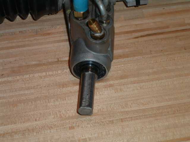

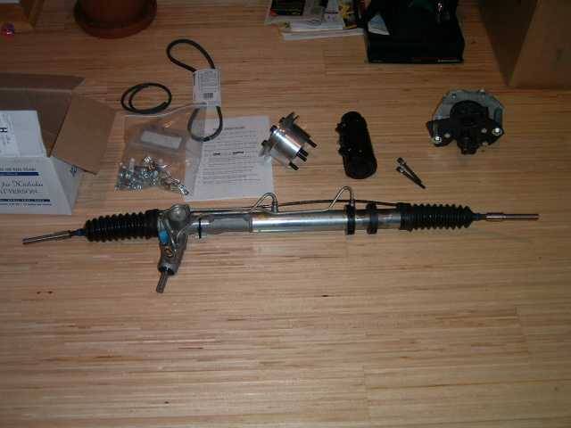

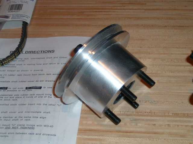

I am posting this specifically for those that have asked about the power steering system as it is installed on Zimmer Quicksilvers. This system uses the PS rack from a Merkur Xr4ti (85-89). I have had this system on 2 cars, and will be installing it on a third. Rodney has this same system, as do at least three other forum members. The system itself consists of the following parts:
Merkur rack (modified)
Custom billet pulley
GM pump
GM reservoir
Custom mount brackets
Hydraulic hoses
In addition, the intermediate steering shaft on the car must be modified.
The specific mods that I am aware of on the rack itself are the removal of some of the housing on the right side of the case, and the shortening and "squaring" of the knuckle attachment. (This is where the intermediate shaft attaches to the rack--I'm not sure of the correct name). In the pictures I've tried to show both the places on the rack that are modified.

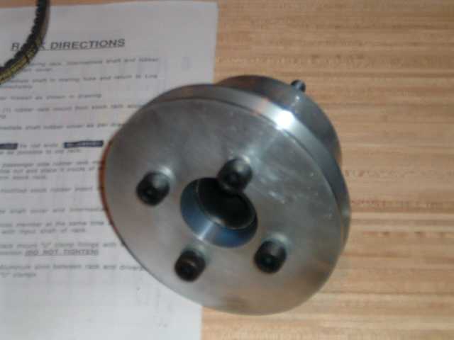

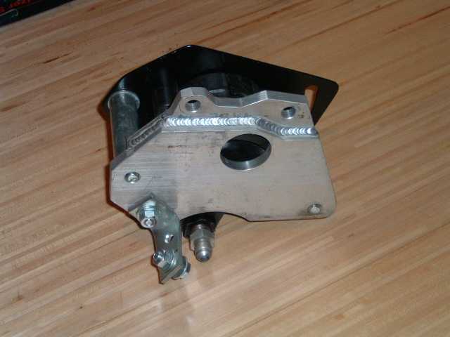

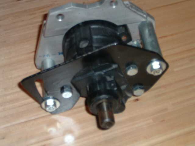

I cannot describe the pulley and mounting brackets adequately, as they are specially made for this purpose, but I have included a couple of pictures so you can see them.
The pump and reservoir are standard GM-issue, and the hoses just made to order for length.
Installation of the system requires a few small modifications to the hole through the firewall, the rubber intermediate shaft cover, and the rubber rack mounts. Also, a small part of the battery heat shield must be removed to provide clearance.
This is a completely reversible installation, so you could put the stock rack back on without much trouble at all.
I have these pieces in my family room, so if anyone wants additional pictures or detail I'd be glad to take some shots and email or post them for you.
Hopefully this answers some questions and helps out the development of this idea using other equipment as well.

The rack in the picture is the last one available from the source that's been supplying these for the past few years. This one is not for sale, as it is destined for my '84SBC.
When they were last sold as a "kit", they were priced at $1250. For this amount you got a brand-new modified rack, new pump, new reservoir, custom pulley, custom brackets, custom hoses, modifications to your supplied intermediate steering shaft, and instructions. The first time you do it, this takes about 4-5 hours to install. After that, maybe 3-4. Used parts could reduce the cost somewhat of course.
I won't comment for Rodney on whether or not he will decide to build this for sale. Personally, I'd like to see it available but it may not be feasible at a price that people are willing to pay.

Not the last one ever possible, John, but the last one that was available from the man who has built them for years. (He wanted out of the Fiero business). You CAN do this yourself, it's just that you can't buy one from him.
There are 4 special parts to this idea: The rack, the brackets, the steering shaft and the pulley.

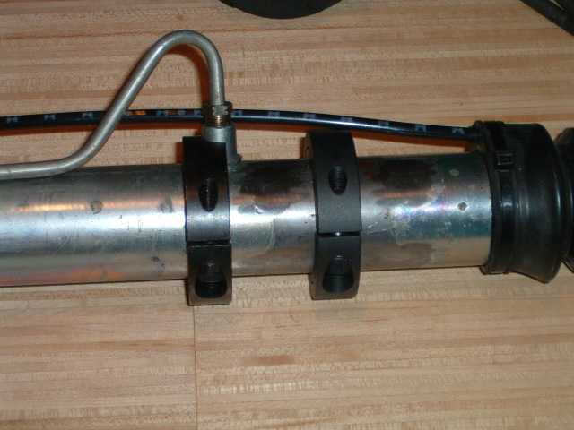

In order to duplicate the rack, you'll need to start with the new or rebuilt unit. Then you need to shorten the shaft and rework the right side of the casing. Listening to the description of this part, it is more involved than it seems at first.
If you have a stock engine in your car, you'll need to come up with some way to mount the pump, which is where the special brackets come in. If you have swapped engines and you already have a pump, or at least a mount for one, this will be much easier.
Third, you must shorten the intermediate steering shaft. It must be cut in two places and welded back together.
Last is a pulley. For the stock V6, this "kit" has a custom billet aluminum one, but there isn't any reason why this function could not be re-engineered another way either. The bottom line is that the pump needs to be powered in some way.
There are essentially two problems with power steering on Fieros: The rack is one part, and powering it is another. This "kit" was engineered so that it would not change the geometry of the car so it will handle safely and predictably. There are probably several other ways to accomplish the feat.
In talking with the man that developed this idea, his feeling is that a Corvette rack might be a better solution. But he's never tried it, so it's still just a theory.
---Brian

If you don't mind, how about a few shots of the tie rod ends. And, what is the black tube shown in the second picture?

My concern is finding an appropriate rack and for that I mean one that has the stock (or very nearly) stroke of the Fiero, correct width to minimize bumpsteer, a reasonable mounting system, and a way to put on the appropriate outer tie rod ends.
That's the reason for using the Merkur rack. It is the same length as the Fiero rack. The Chevette is easier to mount, and C4 Corvette has the correct input shaft, but the lengths of both of those are way off. I suspect that at the time these kits were developed (mid 80s?) there was nothing better available. It's quite possible that there is a late model GM car that has a more suitable rack, but it would take lots of research to find it.
It looks like they are using threaded adapters on the tie rods. I have a ZF rack from an '86 XR4ti. The one in the kit is a TRW rack. They are interchangeable on the Merkurs, just two different manufacturers. The ZF tie rods have the same thread size and pitch as the Fiero tie rods, but they are gender opposite. The Merkur rack and the Fiero tie rods both have female threads. To put the Fiero tie rods onto the Merkur rack would just require a threaded stud between the two, I think it was M14x1.5. Maybe this isn't strong enough, and that's why they used the adapters on the Merkur tie rods?

Some more information and comments:
On the subject of the VUE unit, this vehicle has an electric motor that is actually part of the steering column. In talking with the local saturn parts guy, he thinks that the coupling could be modified to work, but there are no columns in the parts system yet to see what other mounting and application problems we might encounter. Parts price for this is 917.84. There were zero in the national saturn inventory the last time I checked. It would be an interesting experiment, so I hope somebody tries it.
On the subject of the EV1, GM has never sold this vehicle. All of them in use are leased and each must be returned to GM at the end of the lease. Recently GM also announced that in addition to canceling the project, they would not be extending any of the current leases. So . . . there are none in any junkyard to go look for, and anyone that has a car now must return it to GM when their lease is up. From everything I've read, this part may have done us well for our purpose, but it does not sound like there will ever be one available through readily accessible channels.
On the Vette rack idea, this is just an idea that could be researched. I believe the C4 rack is too narrow, but maybe the C5?? It's certainly worth looking into if someone has one around they can inspect.
On the price of this rack, assuming we could get new or rebuilt racks from AutoZone or someplace for about $250, we could get completely modified racks (with steering shaft mods included) for about $700 apiece. (That's $700 total, not $700 plus $250). For any of you that have swapped motors and have a way to supply the necessary hydraulics, this option is available.
Why did Zimmer choose this way to do things? Because they were trying to build a car for sale that had to be reliable and safe and did not create a huge liability for themselves. The Merkur rack is so close to the Fiero that it was a logical choice. In the Quicksilver application, the frame is stretched, so the steering shaft did not need to be shortened. Also, they were charging some $50-60k for the car, so the cost wasn't quite as much of an issue as the quality of the finished product.
On the tie rod ends: The standard Fiero tie rod ends work fine. The end screws into the threaded adjustment sleeve, and then the sleeve screws onto the rack just as it does on the Fiero rack.
