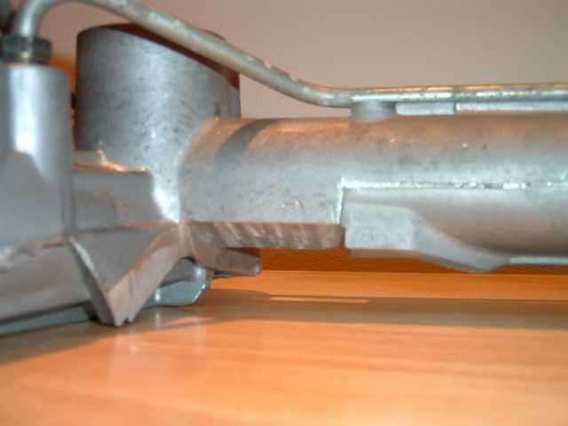

Will: Sounds like you have some interest in the Vette rack research . . by all means, go for it! Let's see what you come up with.
FJ: The EV1 wasn't based on the Storm. The project was cancelled because of America's nearly total lack of interest in the product, the changing political landscape, the huge amounts of money that GM has lost on it over the years and the brighter future that both fuel cell and hybrid technologies appear to offer. For the truly "green" of society, this project is a painful loss . . but even with considerable tax incentives, GM was only able to entice a handful of people into the experiment. In the meantime both Honda and Toyota have introduced hybrids which reach reasonable levels of efficiency and cleanliness at a fraction of the price. And those vehicles are now mass-marketed. (The EV-1 was only available in CA and AZ). So, RIP EV-1, long live its evolutionary successors.
FJ: The idea of using an electric motor to power the pump is not new. It's called electrohydraulics. IF the '89 Fiero had been produced, it would have had an EH unit running a power rack. (The '88 model test mules being the subject of many Fiero fables). In any case, in the mid-80's Subaru put EHPS on their XT-6, and then Toyota built it into the MR-2. As emissions and mileage issues have become ever more important than sales price, many new cars have some variation of EHPS now standard. Volkswagens have it, the new Saturn Vue, and several other models. Most companies have experiemented with it, and I believe you'll see it on more new cars in the coming years.
There is a weight savings in going EH, plus it does put the equipment in the front instead of <more> in the back. In addition, it removes one more belt from the motor, although the additional electrical drag will somewhat offset the lack of direct pump power drain on the usable output of the engine itself.
So will it work on a Fiero? Will it be as usable as a pulley-driven pump? I don't know. Yet. Part of my project this winter is to modify the EH equipment from a 1994 MR-2 for use in powering the Merkur rack we've been talking about in this thread. I'll have to keep you posted on that issue as it progresses. This is my busy time at work, so progress is stopped until after the first of the year. But it sure is an intriguing concept, isn't it?

The only difference from 84-87 to 88 is the intermediate steering shaft. The rack itself works fine.

I have had several off-list inquiries about obtaining racks. Rodney has researched this idea for some time and it would be great if he decides to develop it. I think that the problem will still be cost. (Elasticity of demand for you economics people).
So . . for those of you who are truly interested, let's split the idea into two parts: First is rack/shaft purchase and modification. Second is hydraulic source. For a stock-engined car, you need both of these parts. For an engine-swapped car you don't need the hydraulic source because the donor engine (3800, N*, SBC, whatever) won't be able to use the bracketry for the Fiero engine, and the necessary equipment may already be there anyway.
The original "kit" in its latest variation was about $750 for the rack/shaft part and about $500 for the hydraulic source part.
If we could guarantee X number of units being sold, this may be somewhat lower. And at SOME price we can certainly reproduce what's been done in the past. It's just a matter of whether it can be done at a price that makes it "doable".
So the marketing question of the day is, then, "How much would YOU be willing spend on each part of this?" A second question then, "IF you could buy it for that, WOULD YOU?"

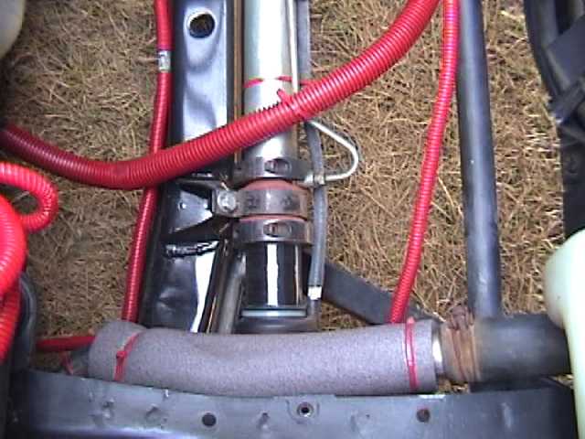

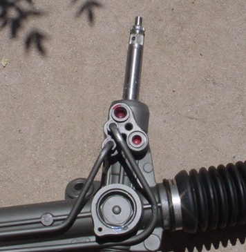

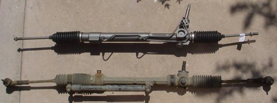

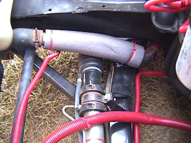

Reference Points
Thanks to Randolph for pictures posted previously and re-posted here. This first picture is both the stock Fiero and a stock Merkur rack. Following are two closeups, one of the Fiero pinion shaft and the second of the Merkur pinion shaft. Note the length of the shaft and the shape, although it is difficult to see in the picture.
The next post will have details of the mods to this part of the Merkur rack.

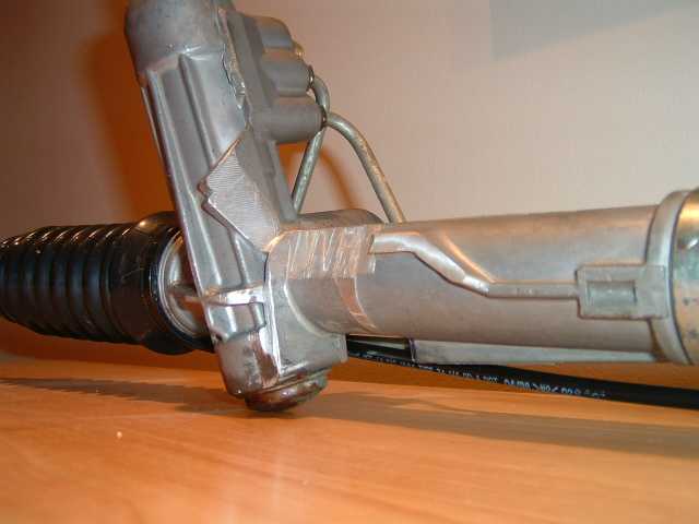

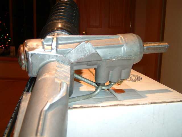

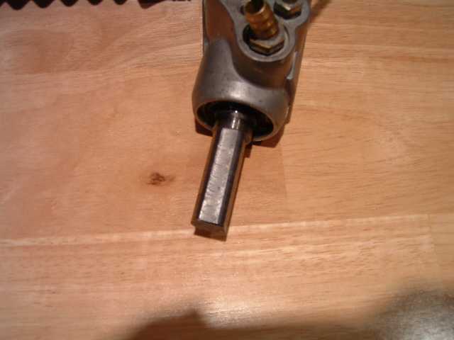

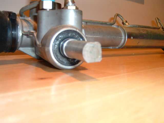

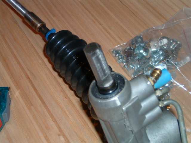

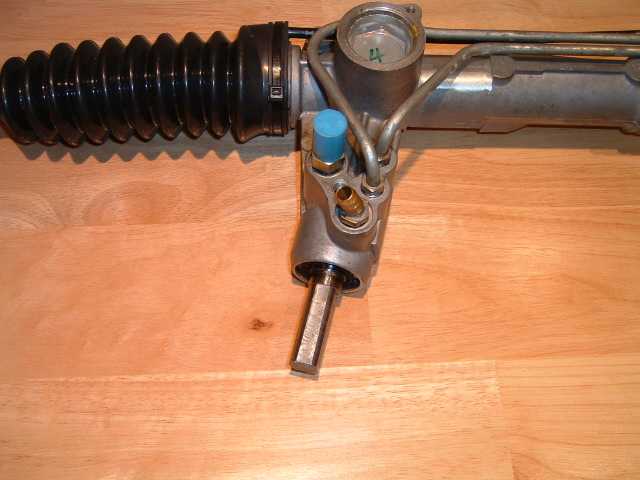

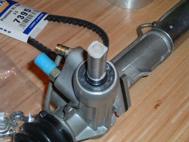

The first thing is that the shaft itself must be shortened to exactly 2". Although I have never seen the Merkur rack in its original form, inspection of the modified unit shows that this shaft is not a single piece. There seems to be a shaft over a shorter stub with a shear pin or something holding them together. These need to be lined up properly, so my guess is that the shortening must be done with the pieces put together--not separated, cut and reconnected. Someone with an original rack may be able to shed more light on this detail.
In shortening the shaft I think that heat buildup will be an issue, so machining it may be necessary. (Sawing will create a lot of heat and damage the seals which are only two inches away).
Once the shaft is shortened, it needs to be reshaped to match the Fiero's stock intermediate steering shaft. Although it defies description easily, inspection of the stock Fiero rack should show the desired shape that it is required. Again, heat will be an issue, so machining is most likely the best method of doing the work.
Following are several pictures of the modified rack from different angles and distances. Hopefully the combination of these shots will give you a feel for how the finished unit should look.
So that's the pinion shaft. In the next post I will show and describe the mounting point changes.

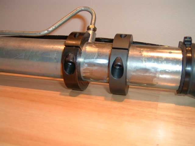

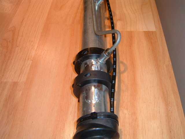

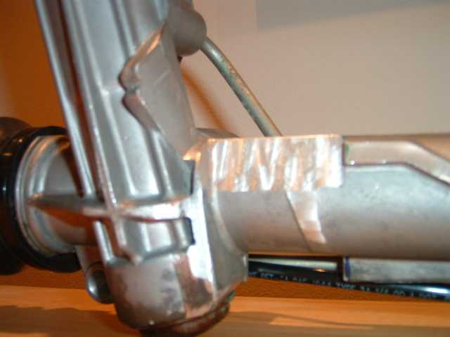

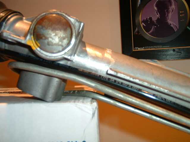

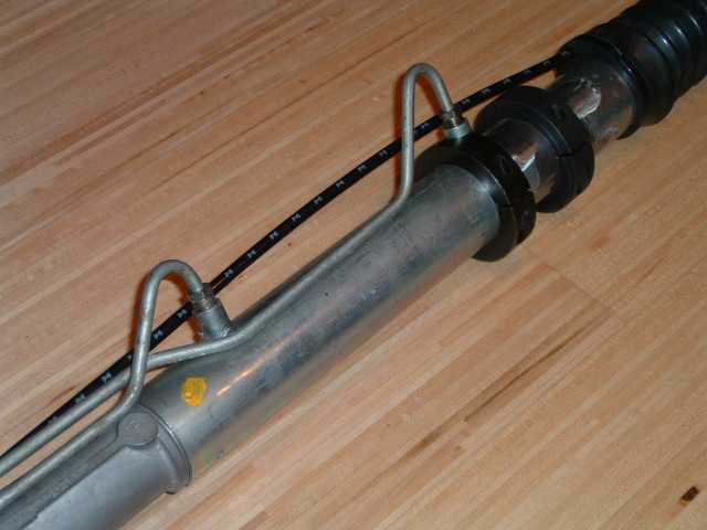

Now to the mounting points. Both sides of the Merkur rack need modifications in order to mount in the proper position. I am going to split up the discussion into the right (passenger) and left (driver) side mods.

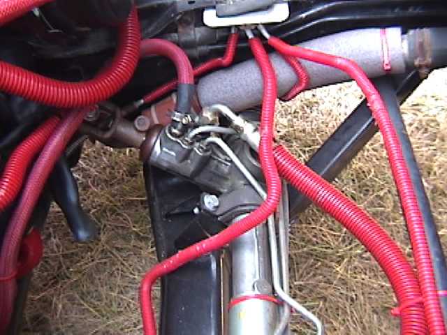

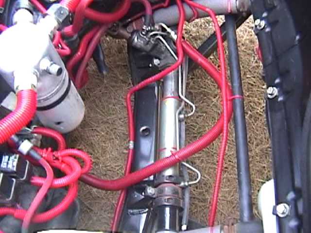

Again, a point of reference. Thanks to Howard Sacks for having posted these shots earlier. This is the right side of the rack, mounted in the car with the standard Fiero clamps. Note the position of the clamp in relation to the black clamps on the rack.
Now here's a repeat of Randolph's picture of the original Merkur rack. Note that the right side (which is on the left in this picture) has a flange that is part of the casing. This must be machined off. Again, not having an original here hampers my ability to describe this further.
Here is how the modified rack looks:
Compare the pics of the modified rack to the ones of the unit mounted in the car to see how the mounting clamp fits between the compression clamps.
Next post we'll see the left side mods.

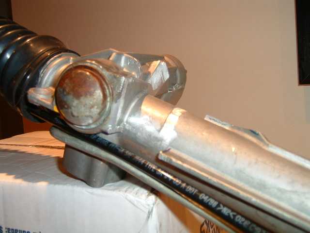

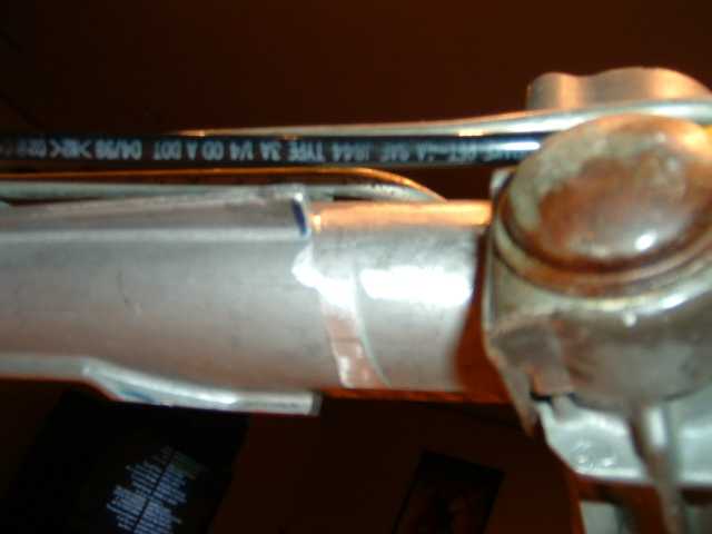

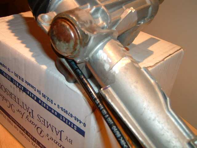

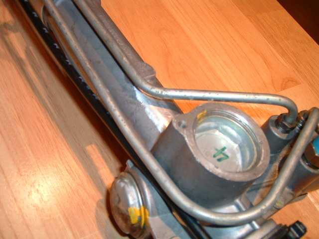

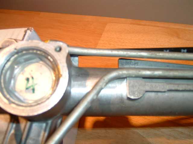

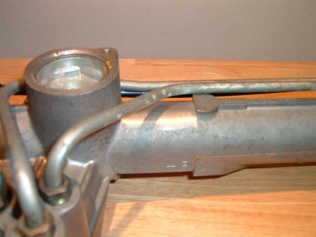

So now we're to the left (driver's) side of the car. Here is a picture, again with credit to Howard Sacks, of the left side:
The stock Merkur rack must be machined to give it a flat mounting point. If you hadn't removed the tubing previously, it must be removed from the rack in order to do this. Here are several pictures which detail the work. The goal is to make the mount point flat, and the rest round to accept the standard Fiero mounting clamp. I took the pics from up, down and sideways so you can get a better idea of what it should look like.
<Continued in next post>
bwayne
Posts: 135
From: Plymouth, IN, USA
Report this Post12-18-2002 11:49 PM Click Here to See the Profile for bwayneSend a Private Message to bwayneDirect Link to This Post
bwayne
135 posts
Member since Nov 1999

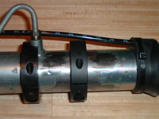

Left side modifications, continued:
Sorry about all the pics on that, but the machined areas are on all sides of it and you can't see all of it from any angle.
In the next post we'll talk about the intermediate steering shaft.
