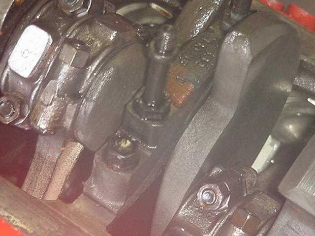

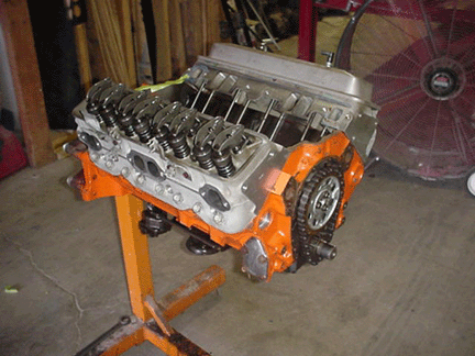

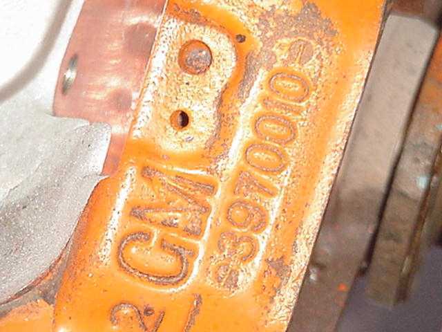

Day one.. 7-17-01 The engine. I probably spent a little more on the engine than I intended to but I think I got a lot more engine for my money. I decided to use an engine that I bought several months ago on EBay. It is a 1970's 0010 4-bolt block. Originally a guy on the South Side of Chicago built it for his '72 Vette. The guy seemed pretty honest and I had gone to look at it before I bid on it. It had been built with a set of ported ZZ-3 heads and he told me it had 13-1 compression. I hope he was exaggerating because that is too much comp. for the street use I plan to use it for. I drove the '72 Vette that the engine came out of and it seemed to run good. I paid $2250 for the engine including a TPI system (& harness) it had on it. I am more worried that he has a high CR in the engine than worried about the quality of the build, because he had a couple of Big Block 600+C.I. Merlin engines in the garage that he had built for drag cars. I sold the ECM, Wire harness & TPI for $750 because we are going to make this a carburated engine. So my net cost for the engine is $1500. I know, by the time I put a carb, intake & ignition on this engine I could almost bought a new Chevy crate engine. But As I said we want to compare a used engine to a used engine.
Here are a couple of pics of the engine; we will cover day 2 of the build tomorrow.
