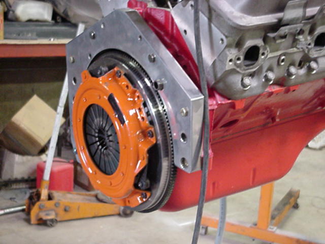

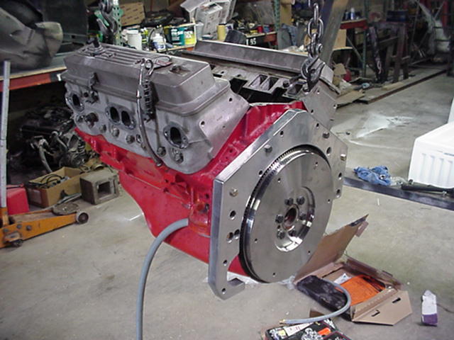

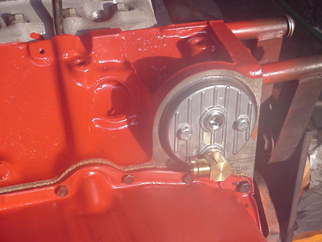

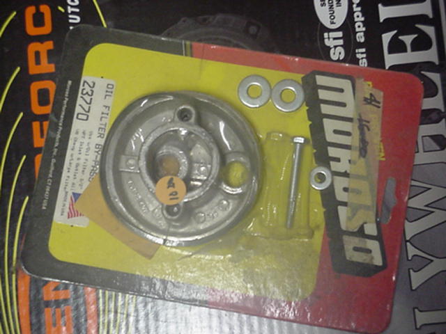

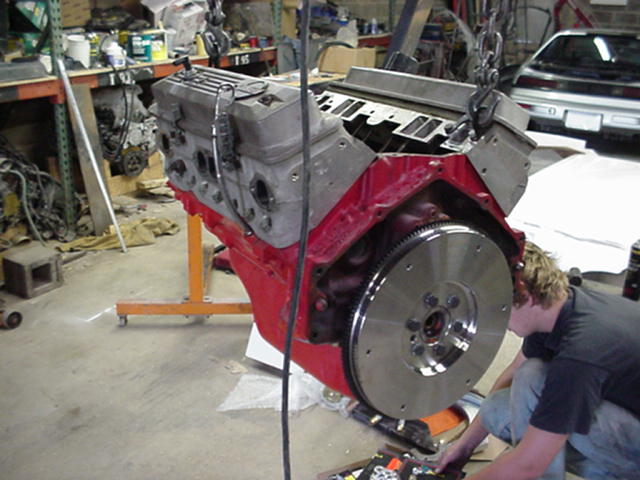

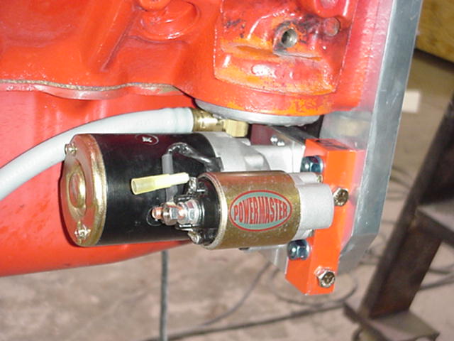

Well as you can guess we've already finished this swap. I've just been late telling you about it. The engine swap has been running and test driven a little bit. As I mentioned before this swap is being done to a 1984 Pace car. At this time we are just finishing up the restoration of the Indy and so the final finished pictures aren't available yet. We actually let this project sit off to the side for several months while we built several customer cars and my LT1 stinger project.
So, if you don't mind I'll take this project up where I had left off several months ago.
You'll recall that to try to stay to a low total cost and to compare a V-8 swap using a used engine to the V-6 swaps that advocate the use of a used engine, we were going to try to purchase as many parts at swap meets as we can. One example is this remote oil filter adapter that has to bolt up to the engine. New, these things cost about $24.00, I got this one for $10 at a swap meet.
When we put it on the engine it looks like this.
WE install the Flywheel that come with the V-8 kit.
Then the adapter plate
The Clutch
And one of the hoses on the remote oil filter adapter and the starter
Yeah, sure I know...... no one else doing 3.4 or 3.8 or OHV Caddie or NStar swaps will show you this kind of detail. And yeah, I know that some people will use pics like these to try to copy my stuff. But, I'm here to tell you that there is a lot more that goes into this than making some parts that a close to what you see here. There is a lot more thinking and planning and making the parts all work together than you might think when you just look at some pictures. I've even had people who have bought my kits try to copy them and fail.

I've always wondered about how to compensate for the extra 1/2" in adapter. Is that a "deep dish" Flywheel? I thought that there would be like a 1/2" adapter plate that goes from the flywheel to flywheel (this making sense?) But from what i can see, this appears to be a much better system. Am i completely off base, or for once did i look at a picture right?

Archie:
What is the model number for the Powermaster starter?
Price?
I just got your kit delivered last week and am starting to get the misc. parts now.
Wish that I had not pulled all of the harness out & off the dead 2.8... No idea where these things go now.
