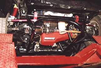

Look at what I found. This is more like what I would make/buy.
And installed
From: Hi-Tec Development
HTD Rear Subframe
This is a custom designed unit to replace the factory subframe which allows for easy V-8 installations with our Eliminator kit. It comes with tubular lower contol arms to be used w/stock rear ball joints. The bumpsteer associated with the original design has been eliminated with this subframe. The V-8 engine is supported in the regular manner with no other extra support required. You can use the factory rubber mounts to eliminate all vibration coming from the power train, or the option to use urethane is available.

FieroGTSR how much do you think that HI-Tec Development cradle ill weigh in at?

That HTD cradle looks like real shitty design. I wouldn't trust it. Think about load paths, and then look at where the control arms mount. The designer didn't even attempt to triangulate. AND if I was going through all the trouble to make an aftermarket cradle, I would at least make provisions for a double wishbone suspension setup.
Crome moly would be better for this application then aluminum and it would be far easier to fab.

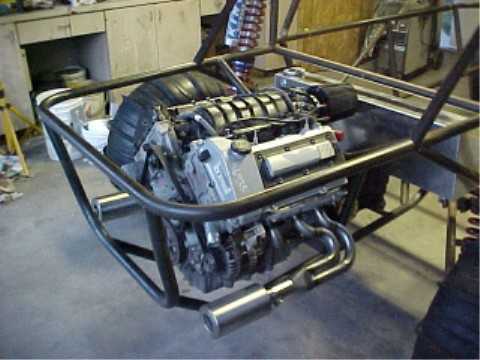

This is a "S*" Short Star= (V6 North Star)
This is a S* in a sand rail that makes about 250HP with minor mods.
