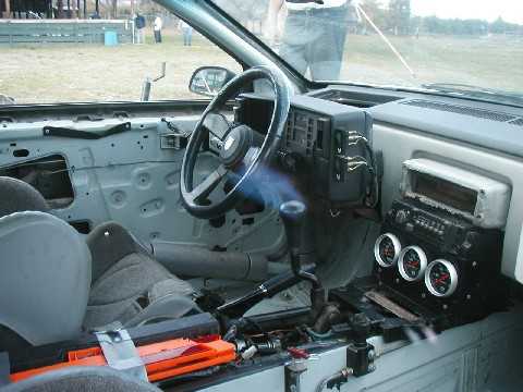

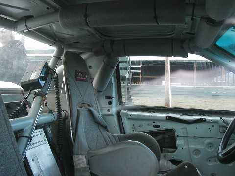

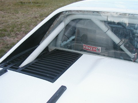

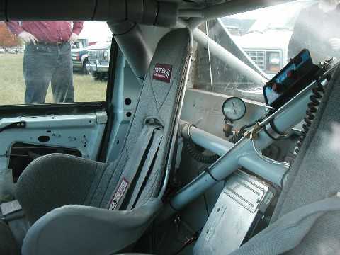

Hey, here are Doug Chases' pictures of his roll cage:
I see your points ogre, but honestly I don't think that a race harness is any less safe than a regular street belt. Yes, they can be worn wrong, but so can 3 point belts. As for DOT certification, I haven't seen any racing belts that wouldn't hold up to a head on collision in a street speed impact. I could understand there being liability issues (especially down there in the states), but that's the same with any modification you make to the car.
Hell, I have driven cars with a 2 point lap belt, rag top, solid steering rack, light sheet metal body, etc. Gotta love 1970's safety standards...
