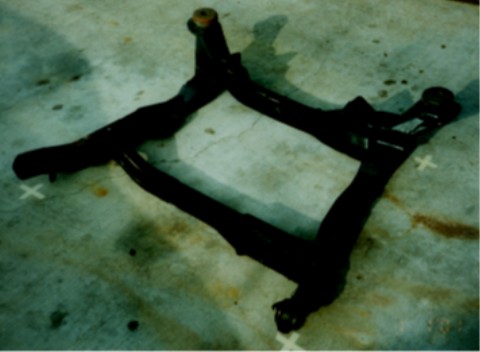

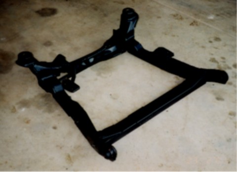

To do this again, I'd use an entirely stock Caddy forward engine mount bracket and just angle the new Xmember slightly aft to bolt the mount directly to it. Be sure to weld the new X-member in before you cut the old one out.

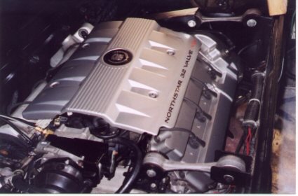

I didn't do my swap , but here is a couple of pictures of the install.I do know the front cradle crossmember has been re-fabricated to fit the N* mounts, but no pics of that.
Automatic?

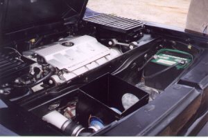

These were pics taken after we completed Keith Huff's Northstar, although the sparkplug wires and such are a little crude, this was done simply to drive the car onto the trailer for it's trip down to the paint shop.....

It looks like you guys mounted the tensioner to a plate there. I have a similar setup on my car. Have you guys had any problems with the belt slipping at high RPM due to the small amount of crank pulley wrap?
