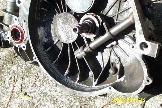

My Northstar killed its first clutch, a DF201502, the clutch Archie recommends for use with his kits.
I was driving home and turned onto my street. Almost nobody lives on it, and it was a cold day with everyone inside so I didn't have any qualms about romping on the car. I shifted into 2nd and put the pedal on the floor. As the RPM was getting to about 6000 a noise like a handful of ball bearings in a paint mixer erupted behing my head. I popped it into neutral and let the engine come down to idle. The noise was still there, and matched the engine's RPM. Thinking I might have grenaded a lifter I killed the engine and coasted into my driveway. After saying !@#$ to myself for several minutes, I got out the stethoscope and cranked the engine back up. To my relief (sort of) the noise was coming from the bellhousing.
Conveniently, I have this week off. I just got the clutch out this morning and found that one of the straps that holds the pressure plate casting to the pressure plate cover had snapped right at the pressure plate casting end and pulled its rivet out with it, or possibly vice versa. The strap was out a little bit and folded over on the end as though it had been dragging the inside of the bellhousing, and the rivet had been bouncing around inside the bellhousing.
I shipped it to Centerforce for them too examine.
I have pictures, but they're too big for PIP. If anyone is willing to re-size them for me, I'd be happy to post them.

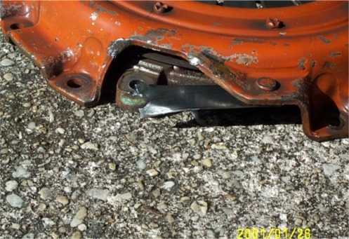

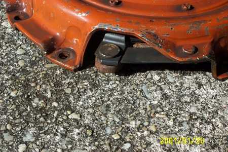

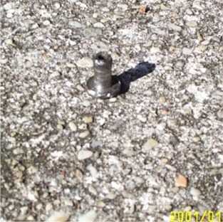

Torque killed it. The straps are under tension when forward torque is applied to the clutch, and it sure looks like the strap just experienced too much tension. I wasn't even turning much RPM. 6000 really isn't that extreme, and my engine is currently limited at 6400. It does see the limiter daily, though
The clutch had been in for 13 months, driven hard for 8 months and had accumulated about 15,000 miles. I don't know what Centerforce is going to say about it.
On the plus side, it never slipped
Considering I'm "only" putting 267 ftlbs to the ground, I doubt it's anything but a manufacturing defect. However, I'm very familiar with Murphy's law, and am currently solving my non-linear waterfowl problem so that if this happens again I can just plop a Quartermaster Carbon V 5.5" clutch. I haven't decided if I can fit the 3 disk in, or if I'll have to stay with the 2 disk. Decisions, decisions...

Yep, those straps get pushed on, the harder you step on the gas the more those straps push the pressure plate into the clutch disk. If one bends slightly when enough torque is applied, snap.

it looks like the rivit was loose, and the strap sliced the head off.

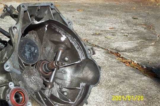

Looks like the tranny can be cleaned up. That definately looks like torque damage.

The pics are pretty self-explanatory. The strap did not slice the head off the rivet. The rivet is intact, although abused. It just pulled out of its hole.

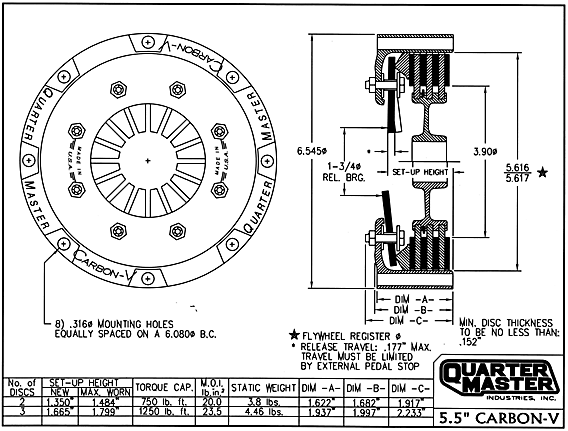

One more word. I'm running the quartermaster dual disk clutch with a N*/Getrag. It doen't slip, hasn't failed. Its been running since 1998. Gets autocrossed and hard street driven. No problems. Probably 20,000 miles.
Don't think the three disk clutch is necessary or will fit. You want to be able to feel the clutch and the 3 disk is much more in/out.
Dan has the same setup as I do and has been running since 1999. He now has 25000 miles on his and I KNOW he runs it hard. He did replace the clutch disks about 5000 miles ago because the tranny leaked oil on the clutch. But there was plenty of disk left.
One other word on the QM, it is VERY light weight. Revs come fast. Smaller diameter also means it is less likely to grenade at hight r's.
I say we should all thank Getrag. That the tranny holds up is to me the miracle.

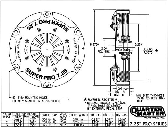

If they'll send me a new one, I'll put it in, but getting the QM setup ready just got bumped up on my priority list. The next time this happens, I'll just change it out for the QM and start my own "Wall of Shame"
I know the 7.25" organic setup is in use and is a known quantity, but I'd like to try the Carbon 5.5" just to be different, and because carbon clutches are cool Comparing setup heights listed by QM to the setup height I measured for the stock clutch, I don't think I'll have enough thickness left over for a button on which to mount the 3 disk clutch, but I should have plenty of room for the 2 disk. The remaining questions are whether or not that clutch can use the Getrag throw out bearing, and whether or not the hub for the carbon clutch is available with the Getrag spline.

I emailed you a pic. If you look at the pics of the Getrag bellhousing, you can see the mod I had to make to clear it. Can't see any more of it than this because it's under the intake manifold, and I'd just as soon not remove that.

Pretty sure Wcapman is using the same unit as Tina and Myself:
Two disk setup with metal floater ring, using stock throw-out bearing (available flat on conical face, use conical).

But this is the one I want:
I just have to talk to QM and see if it's doable.

Will, regarding the QM 5.5 setup, look closely at the clutch surface inside dimension of 3.90". Don't know what the flywheel bolt circle dia is on the "N" flywheel, but know it would require a special steel ring insert to cover bolt heads on SBC flywheel.
Wish they made the 7.25 setup with single hub design, would save the frustration of lineing up two disks to install trans (no pilot shaft available for custom setup).
