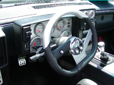

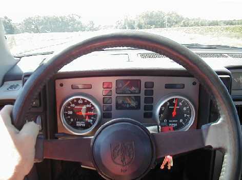

You mean something like this:
I have Autometer Sport Comp tach and programable speedo. They were quite a bit of work to install themm. Lots of cutting and trimming and trial fitting and filing, etc. It can be done if your good at modifying stuff. Here's another pic of the Batmobile's gauges at triple digit speed.

I don't have the Auto Meter gauge model numbers at hand, but I just now looked it up in the JEGS catalog (where I bought mine from two years ago) and found these numbers (but they might be JEGS stock numbers and not Auto Meter model numbers):
Auto Meter Sport-Comp series in-dash 3-3/8" electronic 8,000 RPM tachometer 105-3991.
Auto Meter Sport-Comp series in-dash 3-3/8" electronic programable 120 MPH speedometer 105-3987.
I did a search trying to find my original post about installing these gauges, but had a little trouble finding it. I did find this post in the archives that might help a little though.
https://www.fiero.nl/forum/Archives/Archive-000001/HTML/20010219-2-004988.html
I did this work two years ago, so the mind is getting a little fuzzy on the details. But I do remember it was not as easy as it might look. Took me a long time to finally get it done the way I liked. There was a lot of cutting and trimming and fitting.
One of the gauges (don't remember which) had a light socket housing that stuck out too far in the back. I emailed Auto Meter and explained what I was doing and asked if a flush mounted gauge light socket was available. I got an immediate response back that told me they did have one and they mailed it to me for free. Now that's excellent customer service.
