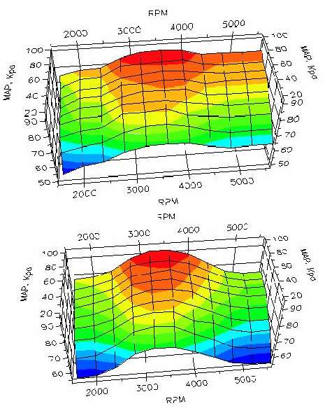

If you have the Fiero intake and use the fuel mapping for the F-body intake, you may not fix the fueling problems. The fuel map seems to go more along with intake design than engine displacement. Look at these maps:
The top map is for a 305, the bottom is for a 350, but they are both Tuned Port Injection. They are different, but not by too terribly much. Now this is a map for a 350 engine, but with a short runner intake:
Now, that is really different! I had the best luck with matching the fuel map to the intake and adjust the overall fueling/timing. If you don't mind sharing, could you send me a copy of the bin file you are working on? I always like to add to my notebook any info that might be helpful for our Fiero friends.

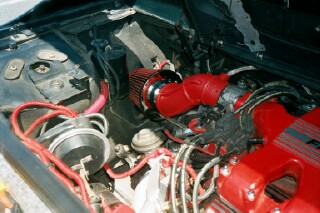

Originally posted by Cooter:
Sure it will, just turn it around backward and add about 5 inches of tubing and a few other things that I have forgot. . .
Now, that thing would have been nice if I had the VE table from the Camaro to copy into my PROM.
That is one heck of a good fabrication job. You must be an excellent welder. Search out the data files for the ECM nos that I vae posted. Perhaps some kind DIY EFI list member can provide the VE tables from the 3.4L Camaro/ Firebird. You may be surprised to learn that the main timing tables are way different from those of the 2.8L.My guess is that they are less agressive than what GM used on the Fiero.

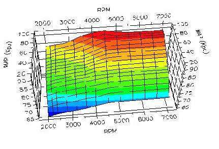

I would be willing to bet that the base VE table curves of the 3.4 and are very similar, a difference quite like the comparison between the 305 and 350. Probably just need to adjust things up or down a bit, which I could do with just a few mouse clicks using the prom editing software I developed. Actually, a simple change to the injector constant would probably surfice.
BTW, you do not need to use the camaro intake just to retain the DIS ignition. Just leave the distributor block off plate on the 3.4 installed, use the Fiero intake like you normally would, and find a place to mount the coil pack. Splicing in the PCM is probably the biggest hurdle, but its more time consuming than it is difficult.
I get to have fancy graphs too
