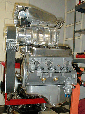

...check this link for a 90 degree Chevy V6 of 4500 cc/475 hp...
https://www.fiero.nl/forum/Forum1/HTML/019005.html

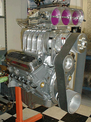

You want 4.3 POWER
gargoyle
Posts: 664
From: Mchenry, IL
Report this Post06-23-2002 12:22 PM Click Here to See the Profile for gargoyleSend a Private Message to gargoyleDirect Link to This Post
gargoyle
664 posts
Member since Jul 2001
Ok now that I'm in the right thread. This link is contained within the one above but for archive purposes I thought it would be good here also. http://www.johnthornton.com/catalog/121-133.pdf
Posts: 41252
Total ratings: 461
Report this Post06-23-2002 12:37 PM Click Here to See the Profile for RaydarSend a Private Message to RaydarDirect Link to This Post
Originally posted by gargoyle:
You want 4.3 POWER
Someone hand me a towel...
From the Department of Redundancy Department.

Droooooll....
Now, let me use the longitudinal tranny on this (maybe even keep some of my trunk) and smile as I notice the look on peoples faces when they notice the blower peekin over the roof...
You want 4.3 POWER

Wow, if you could turn that bugcatcher 90 degrees so it pointed forward, we might have a winner.
I have pondered this swap myself(not the exact one pictured above), and here is what I came up with.
Sure, you can make more power with the V8. There are many prove recipies for making gobs of power with them. It's hard to make a power argument for the V6 against the V8 with two extra holes.
With the 4.3, you would not have the water pump clearance problems. Any accessory system (and water pump) that bolts to a SBC will work on it. The rear weight penalty would not be as bad as a V8. The V8 adapters would work. The lower torque output could tend to settle the minds of those who doubt the strength of the 5 speed trannys (let's not get into that here though).
The Syclone/Typhoon guys have proven that the stock block, & crank are good for a reliable 600 hp at no more than 5700 to 5900 rpm. I have seen several 4.3s making 312 flywheel hp (normally aspirated, no nitrous) using the GM OBDII computer (1996 & up). If you are really serious about building an a** kicking 4.3, go to http://www.machperformance.com . He has a bunch centrifugally supercharged S10 customers in the low 13's, some close to the 12's and one that is knocking on the 11's. All of this in brick shaped trucks that weigh close to 2 tons that still have awesome driveability.
Admittedly, by the time you get to a V6 like that, you are talking about a pricey little engine. The flipside of that is you have an engine that will safely support up to 600 horsepower, more with billet main caps. You could use an aluminum block & heads, but that takes you well into 5 figures. However you would have an ultra lightweight V6 that can spank out that kind of power.
As a qualifier here, the only way that you could get 600 streetable horsepower from a 4.3 is with turbocharging or with a centrifugal supercharger. An air to air intercooler setup would also be a must.
I don't know if I convinced anyone for or against the 4.3, I haven't totally decided myself. I just thought I would throw out some of the points I came up with.
