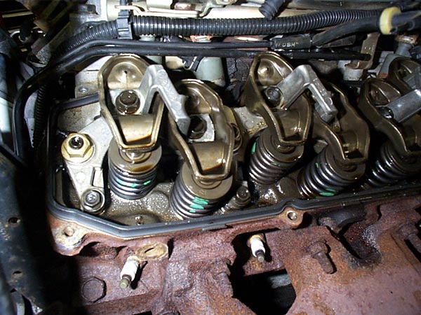

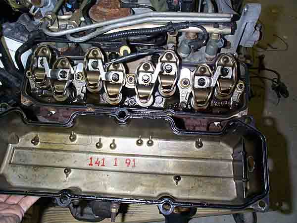

I've been told that its best to replace the 4.5 cam with one from a 4.9
Says who? They already have the same cam, exactly.
The 4.9 had a few other improvements though. Different piston design for reduced cold noise (they still make noise), new lifter angle for reduced friction/wear, new style oil pump. Minor differences really, the oil pump is the most signifigant.
Here are a few pics of the last 4.9 I installed. It has 130k miles on it. Not a spot of sludge on the top end.
I have eight of these engines ranging from 50k to 150k miles, and every one is just as clean. Compare that to the average 100k 2.8!!
p.s. I only took the valve covers off to swap them left to right. The engine went into the Fiero without anything else being done to it. I normally would have resealed it, but I had 18 days to do the swap and be ready for Carlisle. No time to tear it down.
[This message has been edited by rockcrawl (edited 06-18-2002).]
