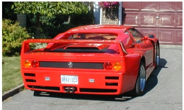

Replica= Koenig Competition, here's a pic
Sandy

MORE PICS PUHLEEEEEEEEEEEASE!
That's one beautiful replica!
