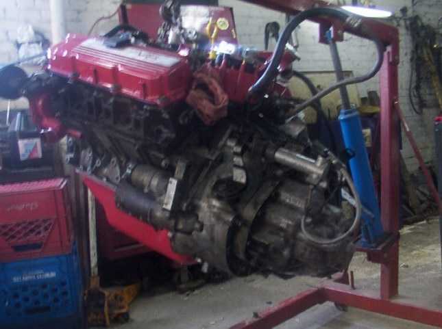

I've never done a N* swap, and probably never will, but I may have some info that will help you guys.
This starter issue sounds very much like the same thing we run into with the bigger cadillac 4.9 pushrod engines. No webbing needs to be removed, just a notch made in the edge of the bellhousing to clear the nose of the starter. By using a high torque gear reduction starter, you can eliminate trans modifications. the gear reduction starter does not have a large nose to support the pinion shaft.
That looks like it takes some strength out of the case!

Oh boy... I go away for a couple of days and look what happens...
Webbing:
I'm not going to grind the webbing out; I will machine it out with a mill. I've taken the transmission apart to replace teh differential bearings and possibly a couple of others. The case half will easily bolt down to a mill table. I will weld a tubing section in place of the webbing. It won't be a full circumference; it will have enough cut out of the side to allow the starter to mesh with the flywheel.
Starter:
Nothing except the Aurora uses a stater like the N*. Unless you want to go to a LOT of trouble to mount one in the conventional location, or do a lot of machining on the block to mount a conventional starter in the N* location, you don't have an alternative. A conventional starter may not even fit in the N* location without interfering with cooling jacket passages, etc.
Stickshift trans strength:
Archie dealt with this in typical Archie style. What I will say is that Tina managed to destroy a Muncie 4 speed with her 383 SBC after 1/2 hour of continuous burn outs. If it takes an engine with 400+ ftlbs of torque that long to break this transmisison, I think the Getrag will hold up just fine.
Check out these two threads: https://www.fiero.nl/forum/Forum2/HTML/008638.html https://www.fiero.nl/forum/Forum1/HTML/005209.html
Stickshift Alternatives:
The VW 02A transaxle is nothing inspiring in stock form, and would probably not survive one full throttle run with a N*. However there are two 6 speed conversions for this transaxle: one from Quaife (www.quaifeamerica.com) good for 275+ ftlbs, and one from Stealth Racing (www.stealthracing.co.uk) good for 400+ ftlbs (EIP tuning uses this trans with 600 HP turbo VR6 engines).
When I have time and funds (maybe late this year) I will work on putting this trans into a Fiero.
An example of this transmission suitable for a V8 swap is going to be between 3500 and 5000 USD. Rebuildable core: ~1000 USD; 6 speed kit: 2000 pounds; Torsen LSD: 1000-1500 USD. I have no idea what the swap will cost, but it will need an adapter plate, new trans and engine mount brackets, and new shift cable linkage.
Flywheel:
I've modified a V6 flywheel, but I wouldn't recommend that for everyone. www.chrfab.com has flywheels. I'm going to call the Fiero shop next week and see if their aluminum flywheel can be had with a N* bolt circle. The N* bolt circle is 8 bolts (2.8 is 6 bolts) I don't remember the exact dimensions right now, but the N* circle is bigger than the V6 cirlce.
Electronics:
Like I said, the best way of doing the electronics, by far the hardest part of the swap, is still up in the air. I'm talking with a guy at GM Powertrain and learning new things every day.
