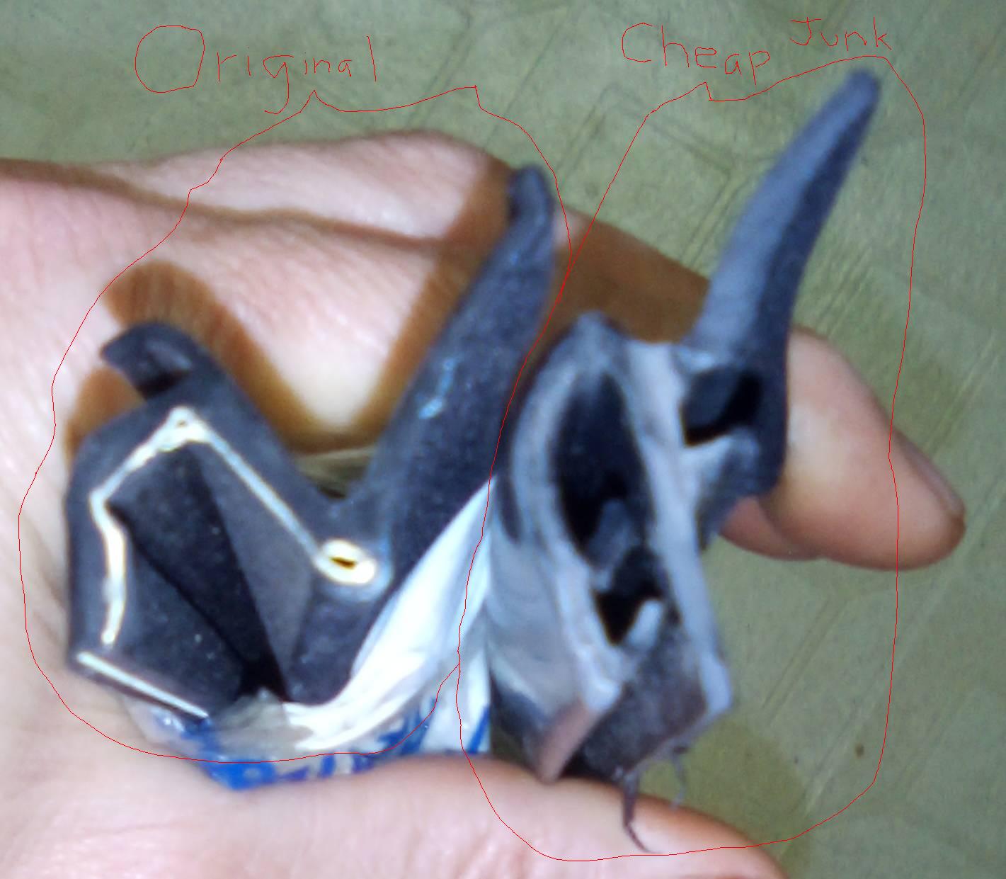

Design flaw:
Apparently Rich copied his inner design from someone that originally came up with the idea to make these. The design was very bad because it looks like the person just looked for the first thing that would fit over the metal flange that holds the wipes onto the door without any regard to the wipe part. Consequently, the wipe part is mounted to the top of the flange mount hump instead of from the bottom of the hump like the OEM ones. The reason this is important is because the wipes may mount onto the door flange, but the wipes now extend a full 5/8" higher than the OEM ones. Why does this matter? Well with the wondow up, it blocks out that 5/8" between the door and the glass. With the window down, it sticks up and kind of hangs over the outer wipes, whereas the OEM ones end at the same height and look right. Overall just a sloppy design.

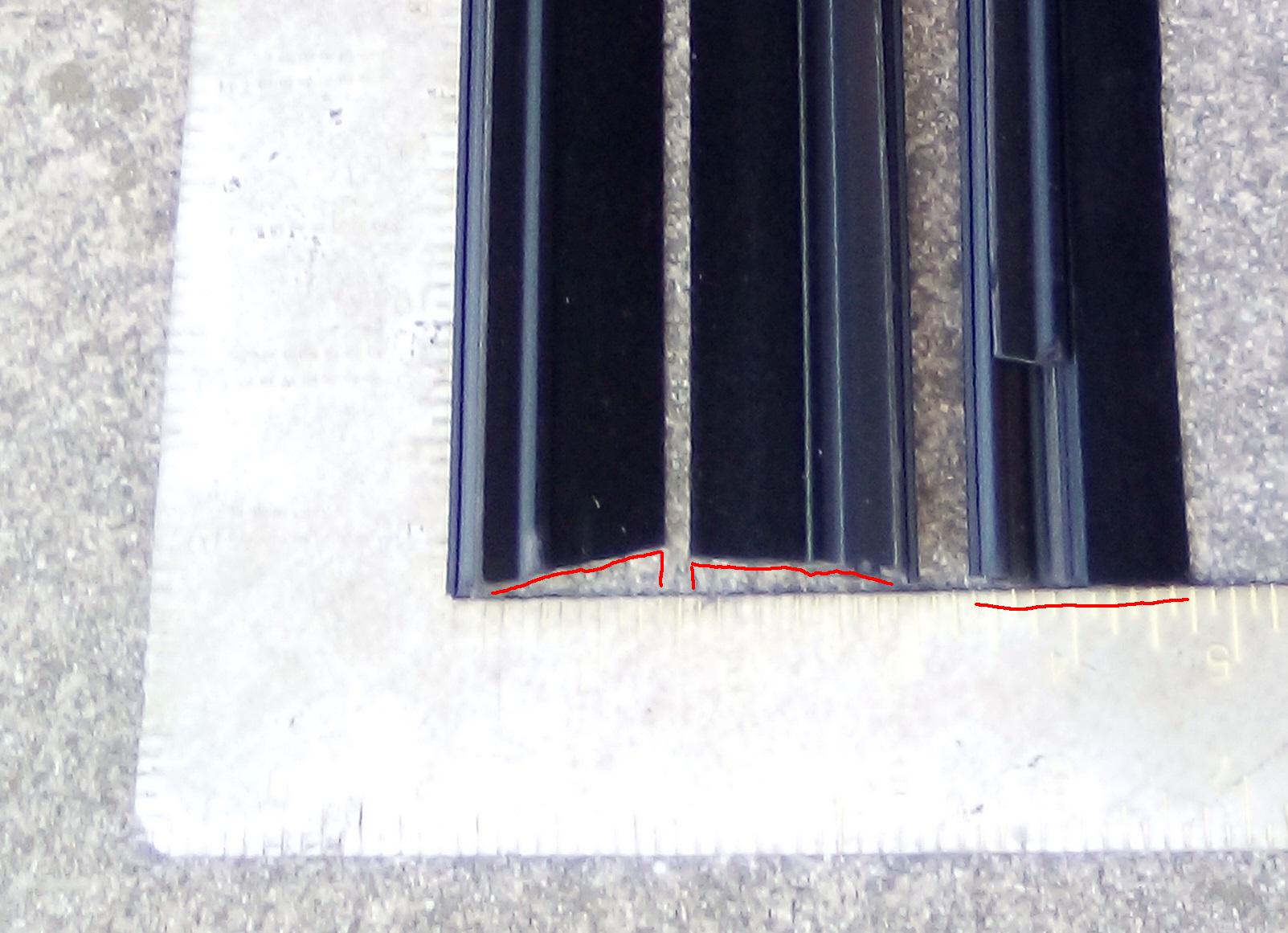

Execution flaw:
Even if you were ok with this design flaw and said ok I don't care that my wipes stick up an extra 5/8" blocks my window and flops around, the other problem is Rich takes no pride in making these. First off, I didn't even receive two lefts and two rights like I ordered but 3 lefts and 1 right. Rich's response, just hack one up and make it fit. Next as I was looking them over and seeing if they would even be useable, it became all too obvious, the wipes are very sloppily put together. The ends that should be at a right angle are jagged with some having the felt longer than the mount, some having the mount longer than the felt and some that are kinda even.

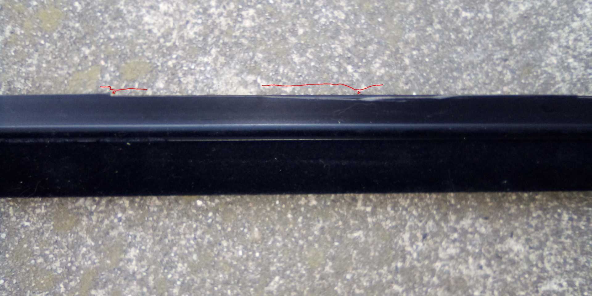

The part that Rich apparently has to trim down to get it to fit is also done very sloppily with sharp edges and ridges along the entire edge you could easily cut a finger one if you're not careful.

Return for refund pretty simple. 100 plus sets sold made them the same way for at least 5 years.
