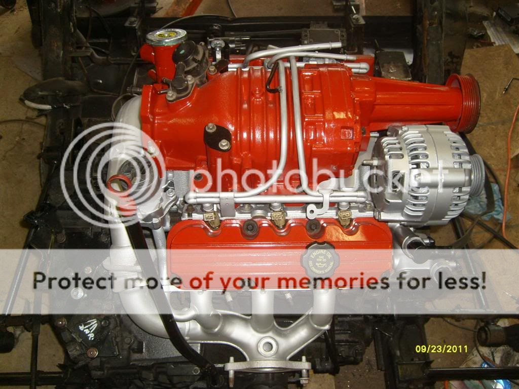

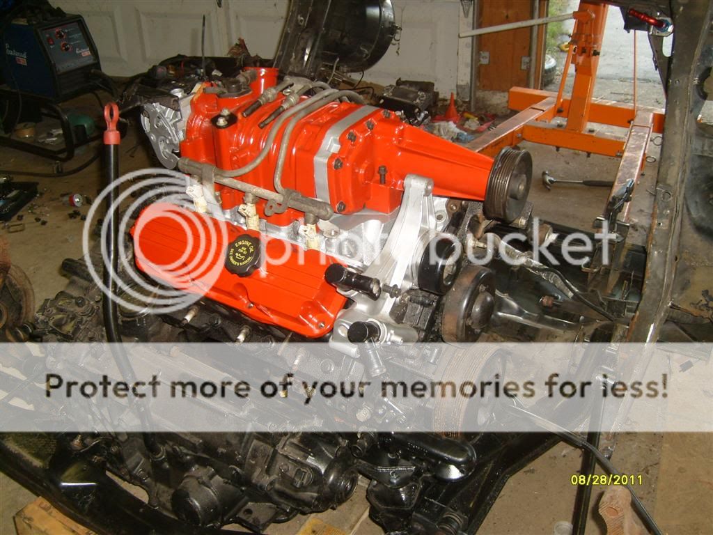

MulletproofMonk AUG 25, 09:27 PM
First of all... AWESOME!
Second, not sure that the 4T65E transmission dipstick is going to clear the headers...
Originally posted by 86 toy:
EDIT: This is probably a better picture. I can get you a measurement if you need one.
-Brian

86 toy AUG 25, 09:34 PM
Yes I think you may be right.. I definitely would like measurements .. thanks for you input!
