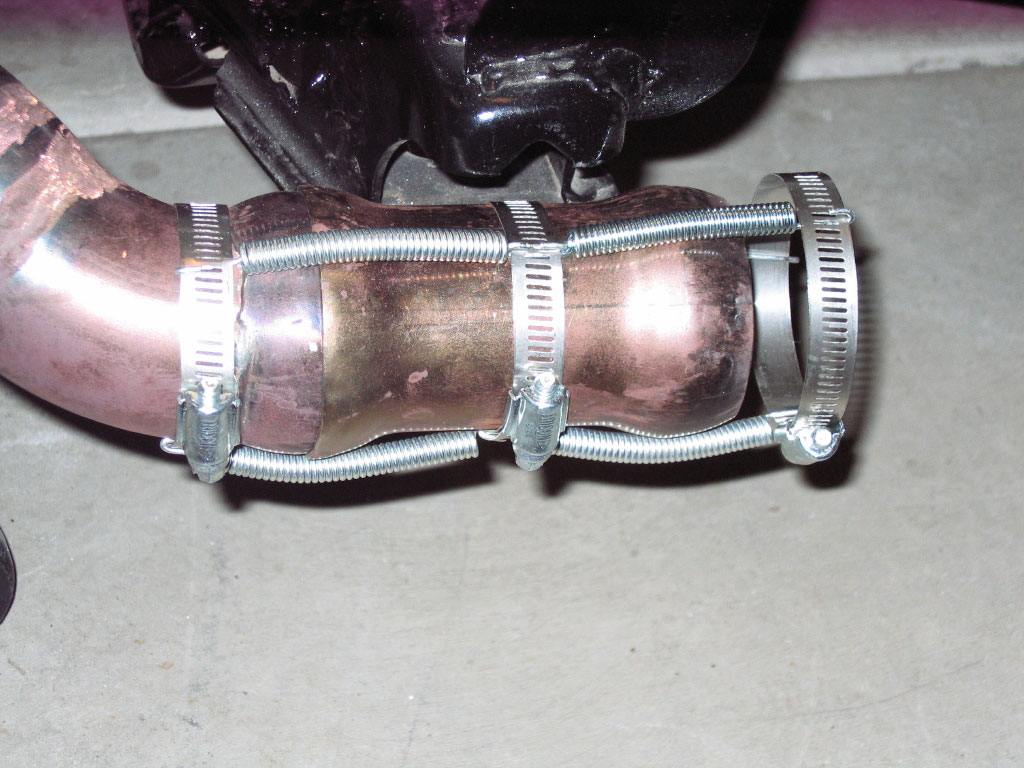

Do you have flex couplings between the pipes hung from the powertrain and the mufflers mounted to the body?

Hi Will,
i was advised against using the traditional flex coupling because they apparently fatigue rather quickly. (What I was told by a reputable exhaust and performance car builder). It was suggested that I use the ball and socket system so I had an exhaust shop swedge some pieces of pipe with ball ends and then I custom made the rest. The flex joints I made for each side are shown in the pictures below.
Charlie
[This message has been edited by cptsnoopy (edited 01-29-2013).]
Will JAN 29, 10:13 AM
Knew you had to have something. Interesting that he thinks they fatigue quickly. My G/F's 2002 Audi A6 has flex couplings in the exhaust from the factory. I suspect they're fine when used within their limits.
I have one on my Northstar's X-pipe exhaust, but the only motion it sees is differential expansion between the exhaust pipes and the engine block. I'll see how long it lasts.

My guess is that I probably mentioned that I expect the possibility of pretty large deviations considering the position of the pipes, their distance from center line and the limited amount of space available to install any sort of flexible joint. In normal applications I assume the conventional flex joint with braided steel around it is more than enough.
